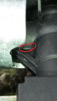

  • #10 15681067
    matrix55a
    Posts: 36
    Rate: 30
    Let me stick to the topic. K3 washer under warranty. The picture shows exactly where it's leaking from. Does the warranty service cover such a repair? Is this a symptom of a damaged head?

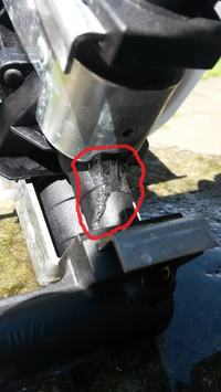

  • #13 15752477
    misiekk89
    Posts: 578
    Rate: 115
    Today I finally dismantled my washer and it turns out that the water is leaking, because there is a crack in this marked place:
    Karcher K 2.300 Pressure Washer: Water Leaking from Bottom Housing & Continuous On/Off Cycling
    It roughly looks like this:
    And the water flows like this:
    What can be done about this crack?
    What could have caused such a crack?

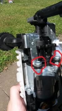

    EDIT:
    Where can I find the part number on the head?
    If I unscrew these two marked screws and the other two, invisible, will the head be unsealed from the pump? Will water leak if you twist it again?
