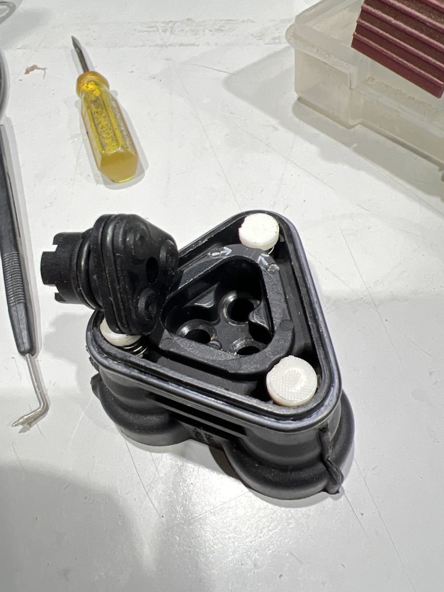

    I know that it digs up the topic, but finally I managed to fix k5 2012. I greased the check valve and the overpressure valve, and nothing helped. I figured I would get it going, but it didn't help either. I finally found something wrong. I pulled out the piston itself without a housing (it's hard to unscrew it, but it will work on a vice). I tried to put it without the O-ring - where it should move. Surprisingly, I had a hard time putting it in with pliers, and it was even worse to take it out. And if I couldn't handle it, how is it supposed to work properly there? The plastic in the head at this point (plastic cylinder :) ?) has swollen, which is the reason for the low pressure because the valve is always open and the water is circulating in a circle. I decided to "hone" the plastic :) dremel, some light abrasive tip from the parts set, 10 minutes of gentle grinding with a feeling that there are no humps until you can remove the piston without much resistance (you have to check every now and then if it's ok because if you grind too much, it will be loose ... then some lamp doctor paste for polishing the plastic and a little felt for the dremel so that there are no burrs. You know it's crazy for sure, no one normal does such things, but I put everything lubricated, and the Karcher has pressure like new. How much is it from? I don't know, I washed 3 cars and 40 meters of the cube for 3 days for now and it works. Forget the replacement of valves and buying a new pressure relief valve. It will not do anything, but the place where it moves, the plastic "swelled". If it does not go there without the O-ring, it is a failure. By the way, how to explain that the plastic swells there and does not wear off? The O-ring is all right, and the plastic deforms from work..... A strange thing.[/u]

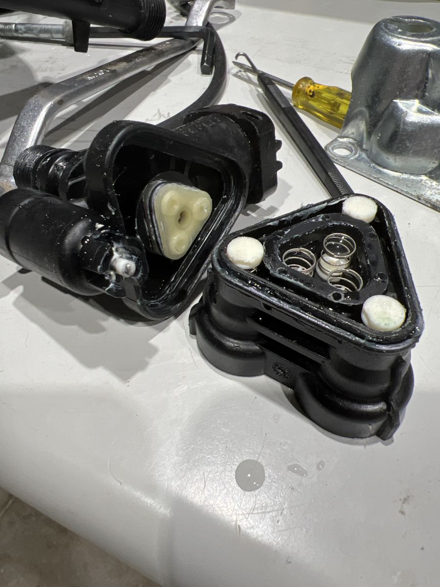

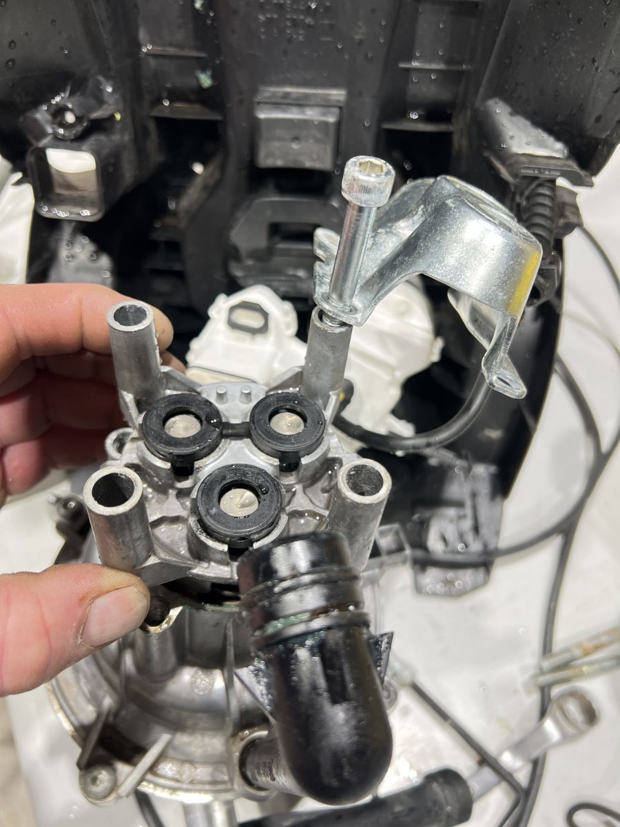

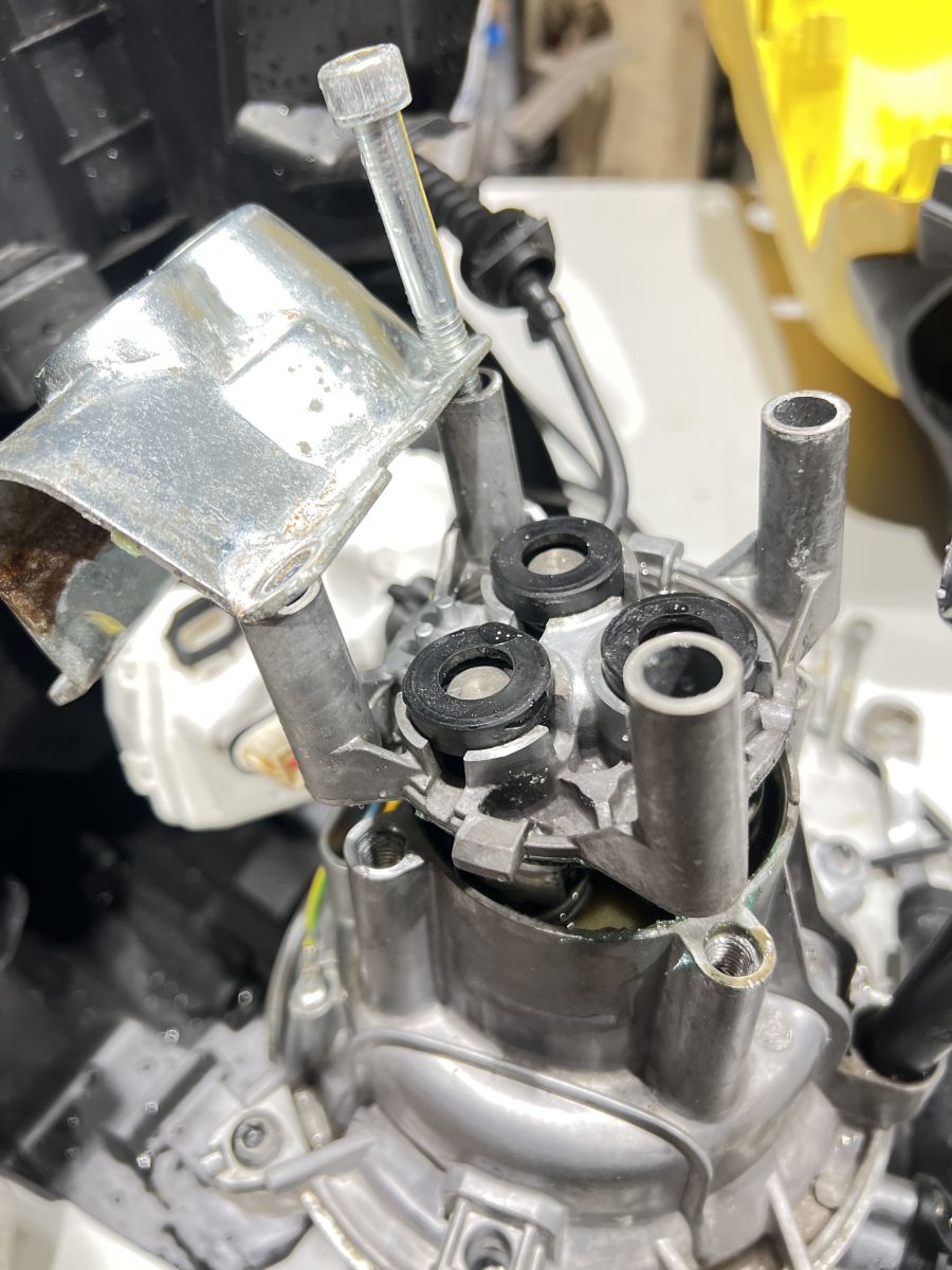

    Hi I would like to ask if anyone has actually fixed the K5 because I went and got the new head as it had a small crack between the high and low pressure.
    The head it was completely different to the one that was on the earlier posts and it's all plastic two piece and all the pictures I'm seeing on YouTube is different again.
    The first photo is the original head and you will see the white arrows pointing at the crack.
    I have it all back together again and it’s pissing water out the top of the pipe as it leaves where the motor is into the low pressure side of the head.
    As you might be able to work out in the pics that the housing with the valves are has tubes for the head studs and the pic someone else had it was all molded in but aluminum. 🤷🏼‍♂️ then YouTube it was different again.
    Any advise on why water is coming out??

    Before I set about getting the washer repaired I visited 2 local service and equipment dealers. On entry I was told that the repair was not cost-effective but they could try. I paid PLN100 for one diagnosis the other was free. Both recommended buying a new washer :D .
    On my own I replaced the head, I was pleased but it only helped for a week of time, then the problem returned. Replacing the gun and lances did nothing.
    I took it apart again, pulled out the valve you mentioned, rubbed the plastic sleeve with coarse then fine paper, lubricated it with white grease and it has been laughing for a month now.
    Thanks for your help, the washer has recovered ;) [/code].

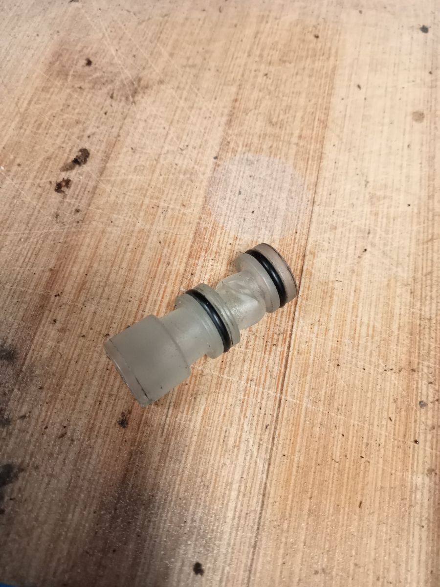

    In my case, such a thing was the reason for the lack of pressure. Hydraulic connector on a wooden surface .

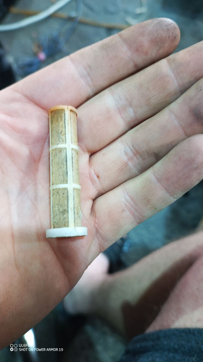

    W. I have a K5.6 washer, the symptoms were that the revs waved up and down, sometimes it helped to unscrew the rotary lance for a while and put it back on. But after a while they waved again, today I took it apart and removed the part you describe, but I accidentally saw that where you connect the water hose there is a filter inserted in the middle, I took it out and it was all clogged up. The Karcher works like this and at the service centre they shouted me PLN750 for the repair after a phone call.
    It also affects how the tip is damaged, I just did a test on 3 rotary lances, 2 rubbish. The foamer works, the cube brush works.
