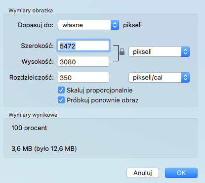

    When it comes to changing the height and width of the photo, I do not have a major problem with it, but I do not know what to do when I have adjusted the height and width to the requirements, but the weight of the photo is too large, e.g. how to reduce the photo from 999 KB to 99 KB or less ? Can I reduce the weight of a photo without cutting off any part of the image?
    I have MAC OS X, so I wonder if it can be done in the preview? I'll send you a screenshot of the preview options. I will be grateful for simple tips.

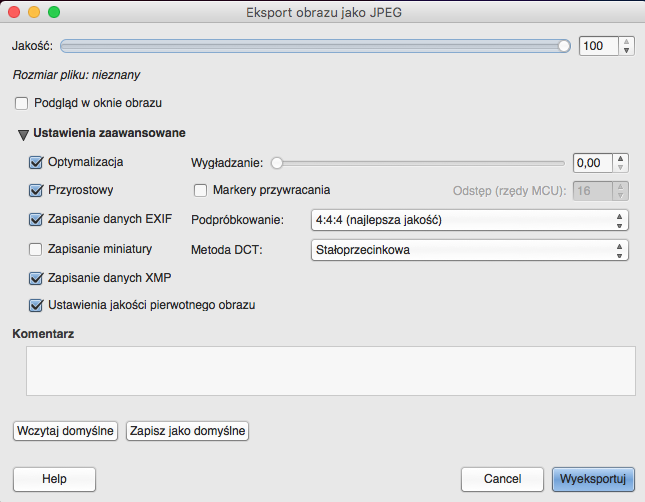

    #13 15667454
    mirini
    Posts: 199
    Rate: 32
    I would like to thank all forum members for their help. Unfortunately, when it comes to the IrfanView program, I can't have it because I have MAC OS X, and from what I can see only Windows users may be interested in it.
    I already have a GIMP program, I opened a photo in it, and read that instead of an option save as I should use export as . Then I saw various options which I took a screenshot, and if someone can help me, what should I select?
    • Reducing Photo Weight from 999KB to 99KB on MAC OS X Without Cropping: How To? 22.png (88.72 KB) You must be logged in to download this attachment.
  • Recommended JPEG settings for smaller files without cropping
    #15 15669444
    deus.ex.machina
    Level 32  
    Posts: 1923
    Help: 91
    Rate: 341
    Most of the default options are ok with the exception of the DCT method - make it floating point. Slider at 90, uncheck the original image quality setting, you can uncheck EXIF and XMP - the metadata associated with the image will not be saved. You can choose sub-sampling 4: 4: 4 this is the highest quality by 4: 2: 2 is the average quality (a good compromise between the file size and its quality) to 4: 2: 0 - the smallest file, acceptable quality - it all depends on the purpose of the image - most consumer sources are 4: 2: 0, which is OK.

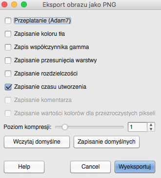

  • PNG compression still produces a 13.5 MB image
    #16 15670030
    mirini
    Posts: 199
    Rate: 32
    deus.ex.machina wrote:
    Thank you for all your help. Many thanks to Deus.ex.machina for the detailed information. I already understood the subject, but it turned out that I must have the PNG image format. and JPG is not accepted. When I chose the PNG option in the same GIMP program, I saw different settings. I've lowered the ratio from 10 to 1 and still don't have the 1MP that the image should have. The photo is 13.5 MB. I took a screenshot of the settings screen and would appreciate your help.
    • Reducing Photo Weight from 999KB to 99KB on MAC OS X Without Cropping: How To? PNG.png (60.05 KB) You must be logged in to download this attachment.
    #18 15671620
    deus.ex.machina
    Level 32  
    Posts: 1923
    Help: 91
    Rate: 341
    png is a lossless format, set it to 10 - the highest compression rate won't even change a single pixel
    Lossless compression has one disadvantage - the file size (except in special cases) is usually much larger than the file size after applying lossy compression.
    You can try to reduce the entropies of the source image - try denoise / median filter.

  • Resizing in Preview and exporting through GIMP to meet size limits
    #22 15673253
    mirini
    Posts: 199
    Rate: 32
    I have already dealt with the problem. First, in the preview program, I reduced the photo resolution (height and width). Then I opened it in gimp, set option 10 and sent it in png format. I did it many times until I finally cut the image in the preview so that the gimp program would format the image to 1 MB. I give different sizes of photos as these are the requirements depending on the company. I wanted to thank you very much for your help.
