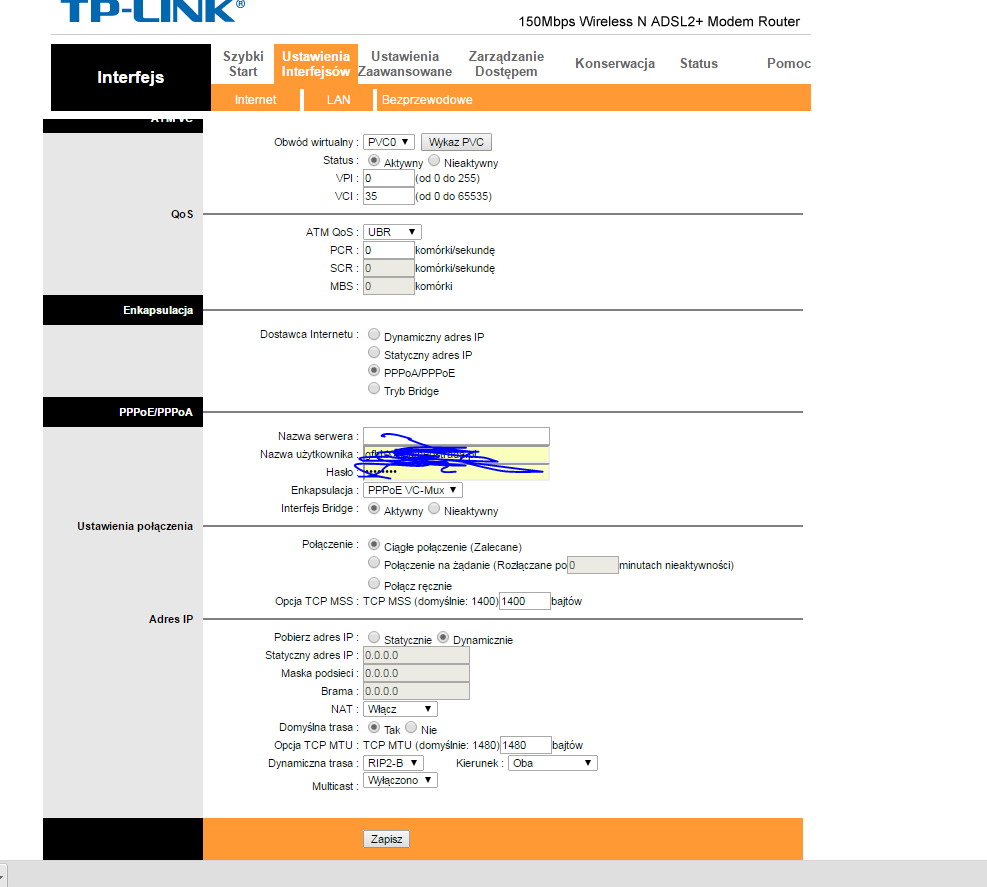

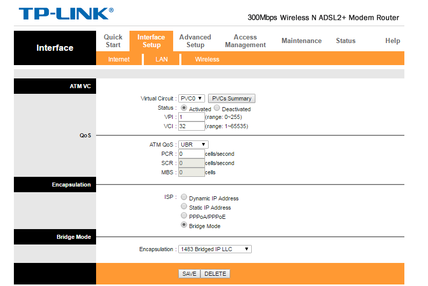

    They don't want me to communicate over WDS.
    Taken according to this link:
    http://www.tp-link.com.pl/faq-327.html
    And it doesn't work for me.
    (Main router)
    TPLINK TL-WR841N Router: Converting to WiFi Repeater for Network Extension (No Cables, 230V) TPLINK TL-WR841N Router: Converting to WiFi Repeater for Network Extension (No Cables, 230V) TPLINK TL-WR841N Router: Converting to WiFi Repeater for Network Extension (No Cables, 230V)
    Secondary router:
    There is no communication between them (no internet)

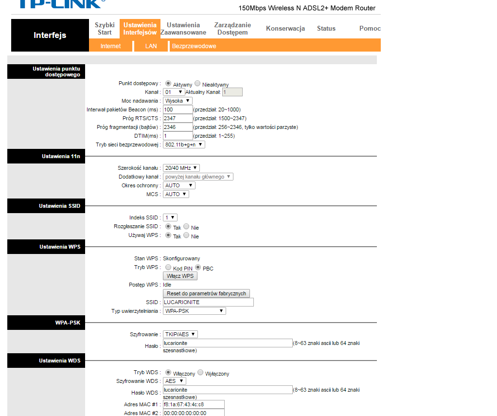

    I am setting up WDS on the TPLINK TD-W8961ND.
    #16 15715181
    jprzedworski
    Posts: 5373
    Help: 758
    Rate: 828
    WDS must be configured on both routers, not just one.

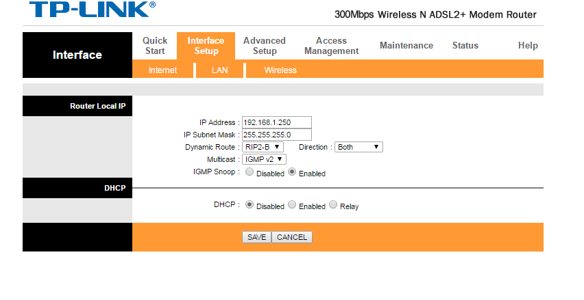

    I configured both routers according to the guide. I gave screenshots of the created configuration.
    If it does not work, I had to screw something up and that's why I ask if my configuration is OK.
    #18 15715293
    jprzedworski
    Posts: 5373
    Help: 758
    Rate: 828
    On the secondary router, the MAC address of the primary router appears to be missing from WDS Settings. I do not know what else ....
  • #19 15715308
    alikatek
    Posts: 2517
    Help: 83
    Rate: 381
    When I am at home, I will correct this minor mistake. I hope it works

    #22 15715583
    jprzedworski
    Posts: 5373
    Help: 758
    Rate: 828
    alikatek wrote:
    I'll correct this minor mistake
    He's not that petite. The device needs to know what MAC address to talk to.
  • #23 15715967
    alikatek
    Posts: 2517
    Help: 83
    Rate: 381
    I corrected the mistake.
    Probably it worked because there is internet without cable connections on the second WiFi network.
    I used as an additional router TPLINK TD-W8961ND
    and this one TL-WR841N I will hide it for now. it may come in handy sometime.
    Added after 15 [minutes]:
    What can I say, the WDS is nice :)
    Finally, the internet is all over the house and even catches in the garage :)
    Thanks a lot for your help.
