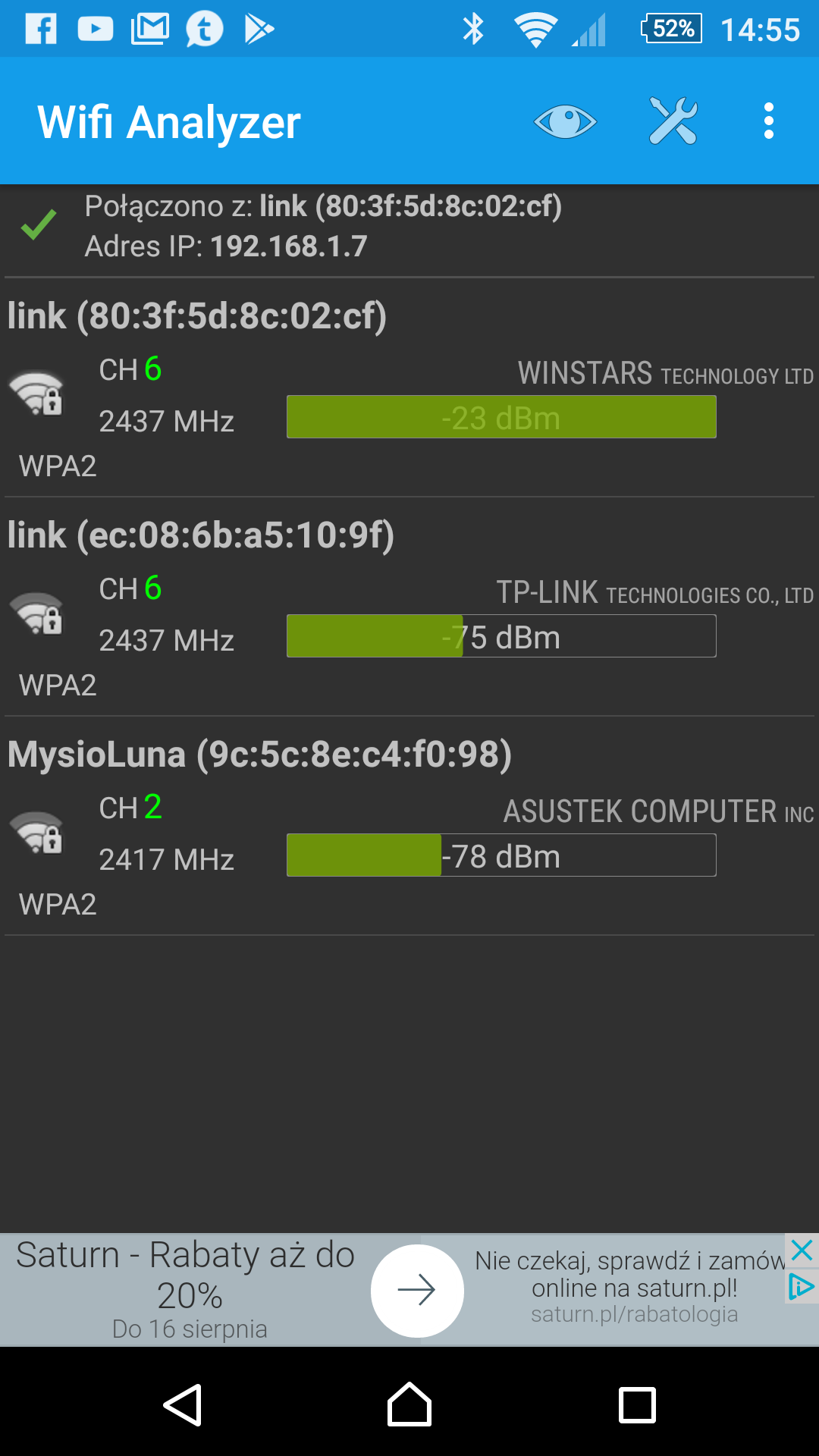

    I have a problem with the configuration of the router with the repeater. Repeater is called Silvercrest SWV 300 C1 and the router is TP-Link td-w8950n (the one with orange). The point is that after some time the repeater terribly slows down, muli internet and with a few devices there is a tragedy at all. Router has IP 192.168.1.1 and repeater 192.168.1.2 .. DHCP on the router compartment .3 to .254. Repeater has DHCP for the car. Wi-fi in b / g mode with wpa2 protection. I hope I have given everything, I am counting on you
    Greetings.

    Installation of InSSIDER v2 / Home in place of the amplifier and insert the measurement result here.

    The problem is not within reach. It now works ok after disabling DHCP, but this needs to be verified at a higher load. Adds ss Configuring Silvercrest SWV 300 C1 Repeater with TP-Link TD-W8950N Router for Optimal Speed

    Hello again. Well, everything works rather poorly, transfers sometimes drop up to 400Kbps, which is a complete failure. Is it possible to change something in the router / repeater to make it better?

    You can try (if it is possible on the router) to release the network to 802.11g. Unfortunately, your symptoms are the charms of the repeater, which often happen with a weak signal or a large amount of interference in the ether.
