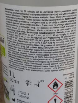

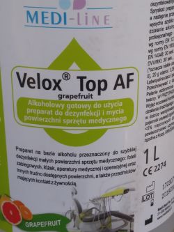

    She should. However, I use RTU or when the more neglected indoor unit for decontamination of hospital rooms is working checked. It is not aggressive to metals or plastic. Effectively destroys fungi and bacteria. I advise you to rinse well before cleaning it up. Condensate exchanger and trays if that's the effect you have. When doing a survey of the average for rinsing, I use about 5 liters of water. Not counting what is fumigation.

    Up, it turns out I have it at home such a measure of clinexa is it the same or similar?
    With this rinse with water, I do not know how to apply, maybe with a spray bottle?

    I promise I will follow your advice - it makes sense. I will do 2 service after the summer season, I will buy a good watering can.
    ps. and this hospital chemistry is going to get somewhere?

    Yes, you can buy it, I will give you the details of what I use and where I am buying. With the services it is like using the air-conditioning as heating in the fall season. These two inspections are even mandatory. In order to get rid of fungi and mites from the exchanger, as you know, they like heat and moisture. What I give you is from my own many years of practice. Coming back to the topic, if you do not use the unit for heating, it is enough to fumigate after the cooling season and only before the next season rinse the exchanger with a delicate dose of fungus, but if you have time, there are really two fumigations with thorough washing and rinsing of the exchanger. It does not hurt, and thus the situation will not repeat itself. Write to me on priv if the external unit has the inscription. Smart Inverter or Inverter V Because from a certain date of production Outdoor units have a factory defect that is easy to remove by yourself and avoid unsealing of the outdoor unit.
