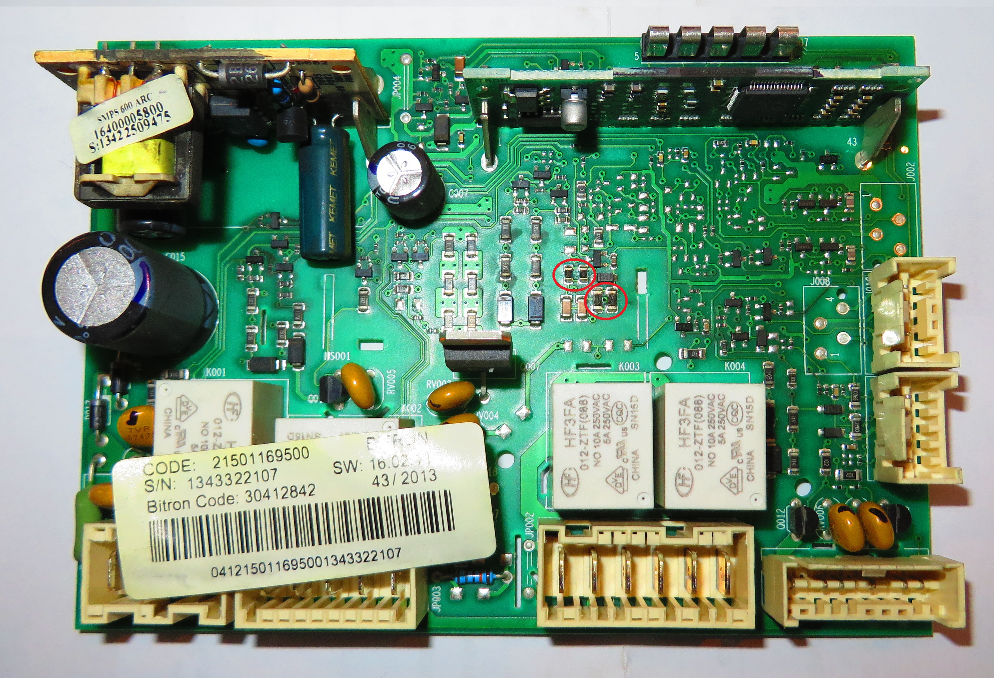

    Water poured over the connector and caused damage to the module. I found 4 burned elements, marked in the picture with a red circle. If someone has the value of these parts, I will be grateful for the application.
    • Indesit IWSE51051 - Blown resistors on the EDT0117.11 module - what values? EDT0117.11.JPG (2.28 MB) You must be logged in to download this attachment.

    kagutek wrote:
    I found 4 blown elements, marked in the picture with a red circle. If someone has the values of these parts

    Thank you for your response. I want to clarify: 5K6 are the upper parts in the picture, and 2K are the elements at the bottom?

    1206 and 805 (should be 0805) are the codes indicating the size of the elements. 1206 is larger than 0805.
    Dear colleague kagutek whether you had any doubts you could not ask this question to the search engine, which in the blink of an eye would show the answer ... :cry:
    :arrow: Resistor SMD 1206 dimensions
