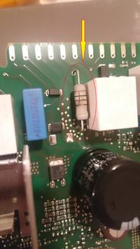

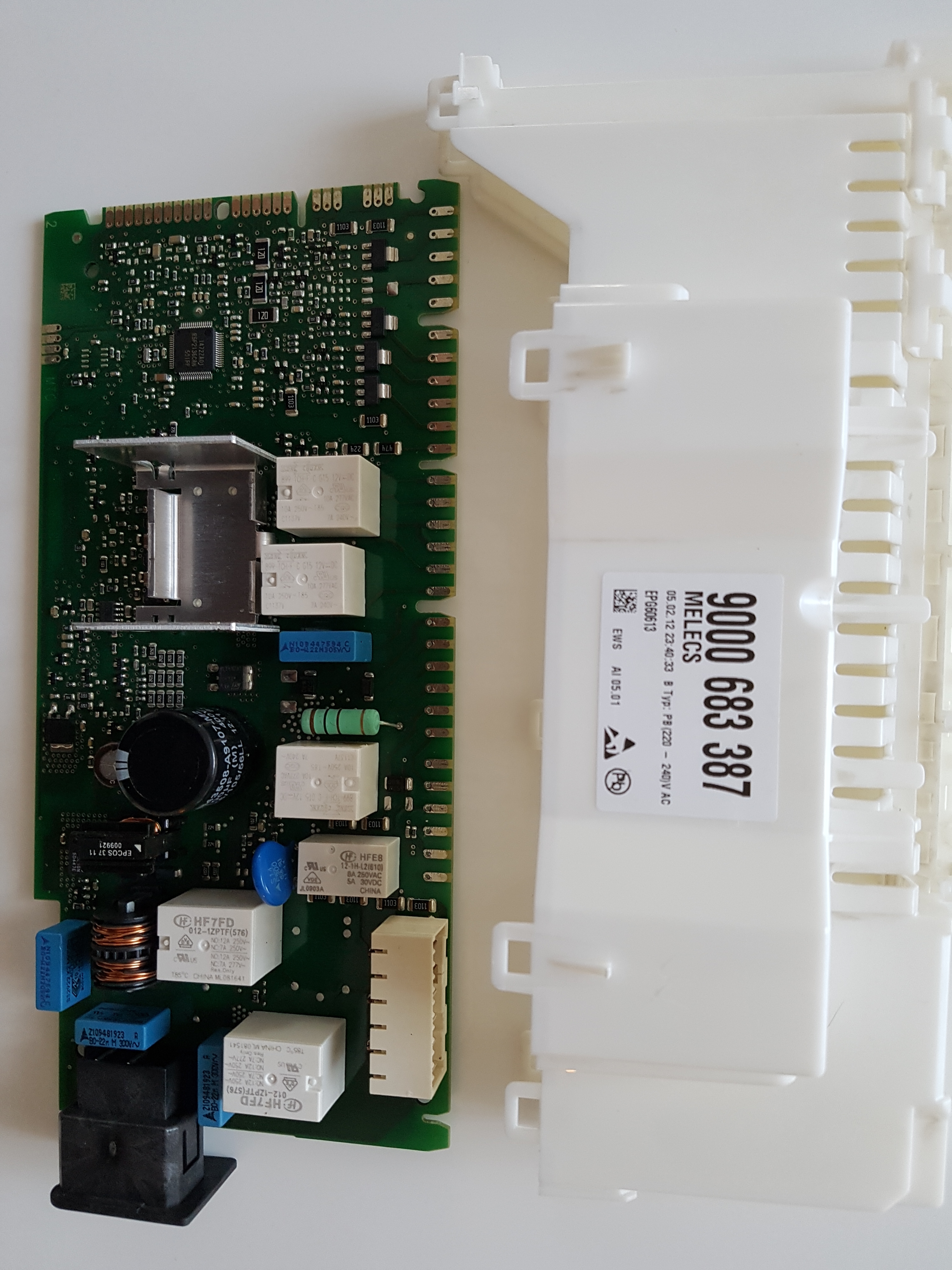

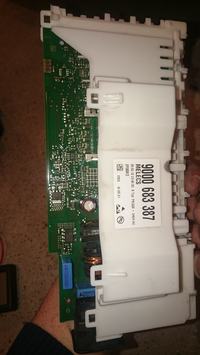

    in the attachments I am sending photos of the damaged resistor, dishwasher model and dishwasher module. The resistor in the module has swollen and it has changed a little color. I am asking for help in identifying the resistor. Links to websites where you can buy are welcome.

    Thank you for the answer, but I'm more interested that maybe someone had such a module in his hand and already knows what the colors of the resistor are, because for me they are a bit difficult to identify. greetings
    What does your colleague have a problem with, distinguishing between colors? This should go to an ophthalmologist :)
    You have to desolder the resistor and read its colors - not everything burned.
    Besides, if the resistor is damaged, it is not without reason that you have to take the meter in your hands and measure it.
    1. You will get an answer to such questions faster in the household appliances department.
    2. The dishwasher model is to be in the title.
    3. 100? resistor.

    if the resistor is damaged, it is for a reason
    So very good photos of the module on both sides are welcome.

    ppeppe wrote:
    he already knows what the colors of the resistor are, because for me they are a bit difficult to identify.
    Replace IC TNY264GN and a resistor 100? / 2-3W and it has to go, and if not it is already a college and a friend ppeppe he can't handle it :D

  • #8 16277427
    ppeppe
    Posts: 16
    I replaced the TNY264GN and the 100? / 2-3W resistor and everything works.

    ... I thought everything was working. The dishwasher does not heat the water. I wonder where this type of dishwasher has a heater (I heard that some have an integrated pump) and whether it is the heater's fault at all, but maybe something with the module.
  • #10 16671001
    ppeppe
    Posts: 16
    Gentlemen, which of the relays in this module can be responsible for heating the water. I checked the heater is working.

    Check to which relay paths go from the heater connector.
