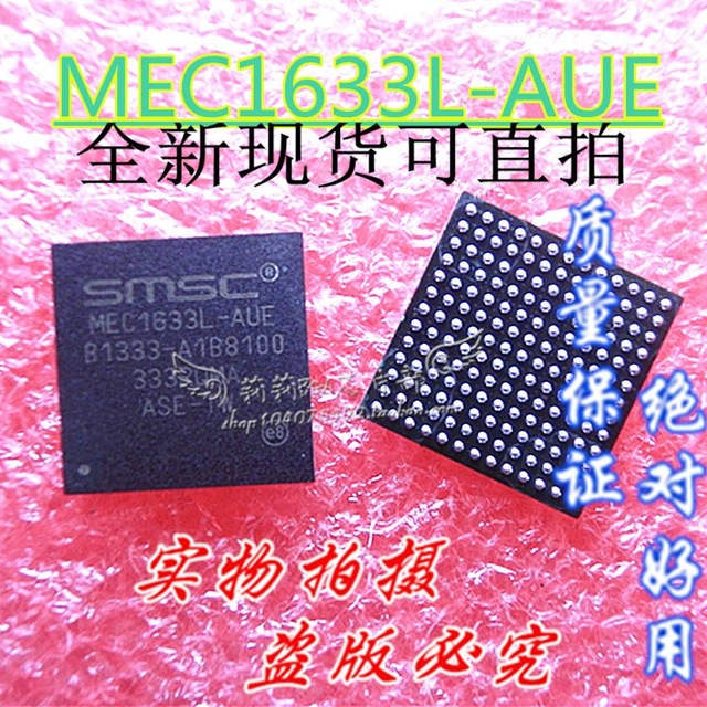

    Tam KBC to MEC1633 (MEC1633L-AUE , BGA) Link_ z Elceny

    So the problem may lie at KBC? I can try to replace it if it is. Going back to these bits, how I tried with this 16 < br /> mb MB is the original 8 mb MB and this 16 mb < br /> The MB in the hex editor started identically. Even the bone was programmable including 16 mb MB when trying to run with this batch the board starts to download 120mA and so it hangs so much worse than on the org.

    Look at SM from Lenovo X240 (nm-a091), there is also MEC1633.
    - i5-4300U (SR1ED)
    Everything written in it
    Similarly, Lenowo W540
    Apparently, similar to
      Lenovo X1 Carbon BIOS Input: LMQ-1 MB 12298-2 48.4LY06.021, MX25L6475E, MEC1632L-AUE, i5-4210U
