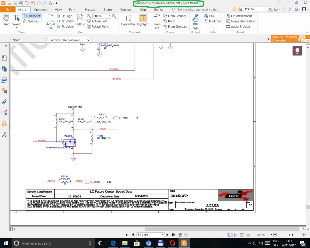

    Lenovo Z50-70 ACLUA / ACLUB NM-A273
    Laptop drove up dead. The voltage on the center pin of the 1.3V power socket. The voltage jumps 0.20V-1.29V behind the PD304 diode. Damaged PQ301, after replacing 4407A, the board started responding to the switch. So after pressing power, the diode lights up, after plugging in the battery, the charging diode flashes. The battery is charged with the voltage of about 14.8V, after removing the battery it is 1.9V. Unfortunately, only that much, the fan does not move, the image is missing etc. PQ302 4n -5.2V, the rest 1,2,3,5,6,7,8-20V. Voltage on UC3 (BIOS) -3.3V.
    The voltages appear on only three coils, PL302-1.9V PL304-5.1V PL303-3.3V. At rest it is 0V.
    The converter BQ737 substituted with BQ727 I had - no changes.
    What voltage should be behind the PD304 diode? . I will be grateful for any help.

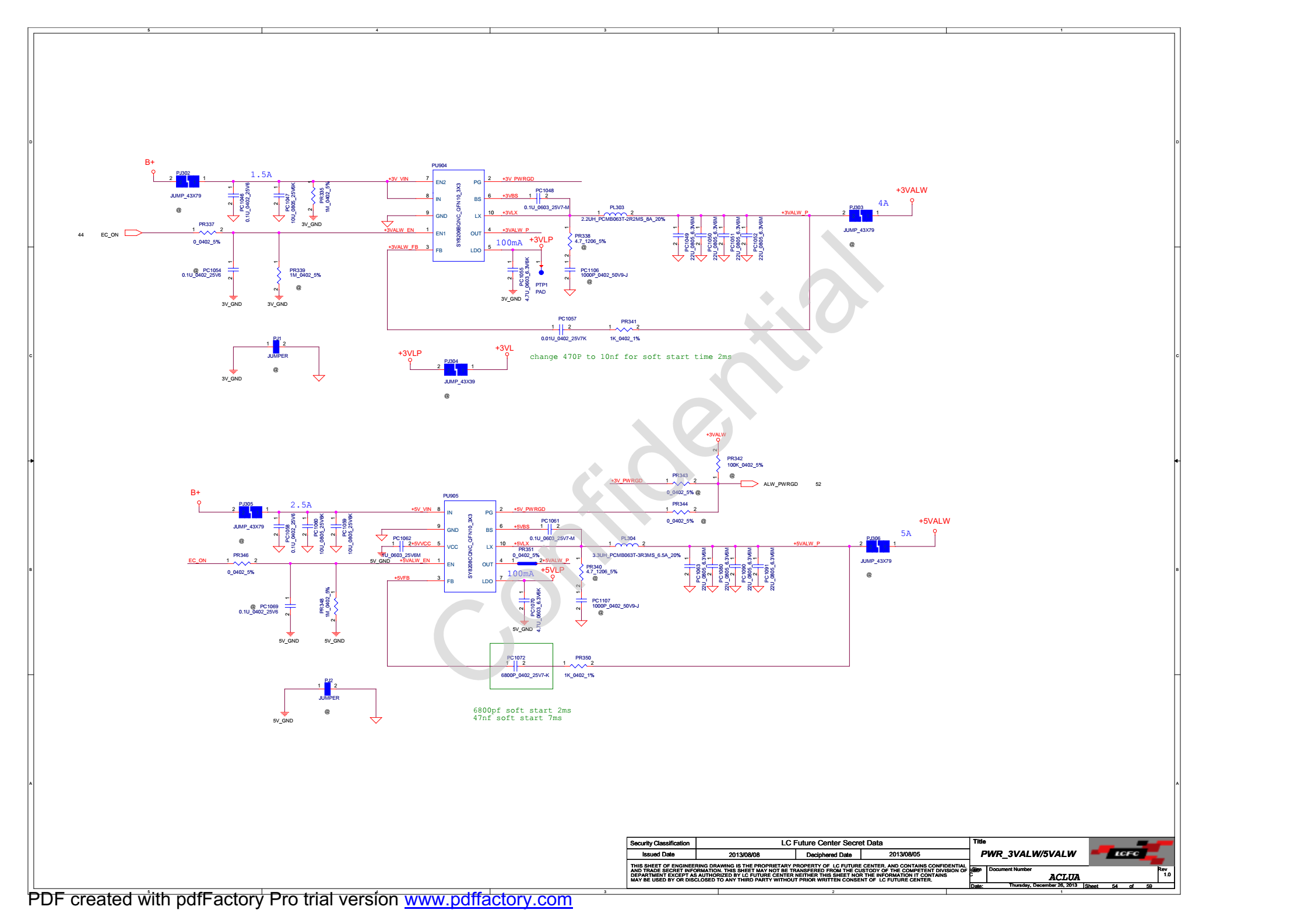

    Is PU 401 there, do you have + 3VLP or + 3VL?
  • #7 16845124
    janko23
    Posts: 320
    Rate: 12
    I cannot locate PU401

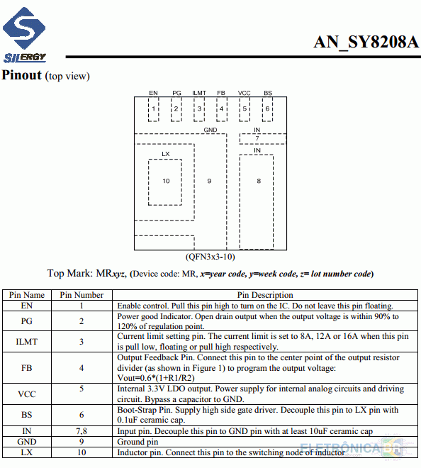

  • #8 16845217
    adamadi33
    Posts: 10516
    Help: 768
    Rate: 251
    Well, you have 3V / 5V converters on two SY8206BQNC systems.

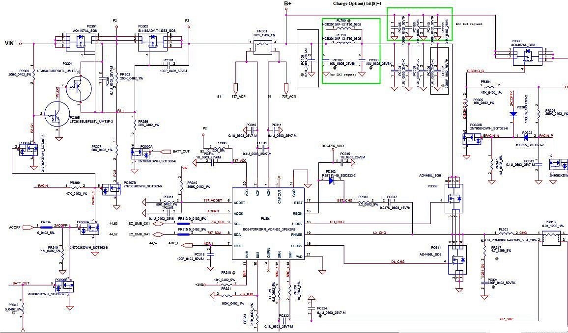

    If it doesn't help anymore?
    Remember that (PQ302) P-ch and with him N-ch (PQ301)
    Lenovo Z50-70 ACLUA/ACLUB NM-A273 Dead Board: Voltage Issues, PD304 Diode, PQ301 Replacement Lenovo Z50-70 ACLUA/ACLUB NM-A273 Dead Board: Voltage Issues, PD304 Diode, PQ301 Replacement

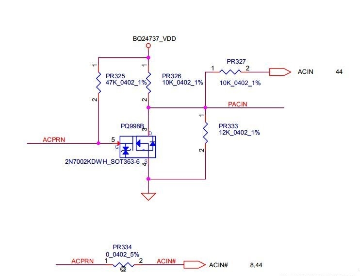

    BQ should give a signal for PQ990B> this one should open PQ307B ...> this one opens PQ301 and PQ302.
    See what about the BQ24737_VDD?
    ACOK signal active.
    In the datasheet it is described as #, which is if 0? that's ok.
    ps
    These PD304 or AZ-5425-01f
    * identical in Compal_nm-a181, only numbering of transistors PQ312a / PQ312b
    No LED> from this forum Link_ problem
    Availability Link_ about PLN 29 and datasheet in app.
    • AZ5425-01F_Datasheet.pdf (190.82 KB) You must be logged in to download this attachment.

    The 4th time is with
    System PU904 (SY8206BQ) / PU905 (SY8208CQ QFN-10) i.e. 3.3V / 5V

    Both circuits produce a voltage of 3.3V and 5V. At the moment I have 0V behind the PD304 diode. Can I try to give these 1.4V from the middle pin of the socket?
  • Check adapter-id, PQ995, and BQ voltages first

    Rate: 742
    - no. Unless you want to introduce another bug.

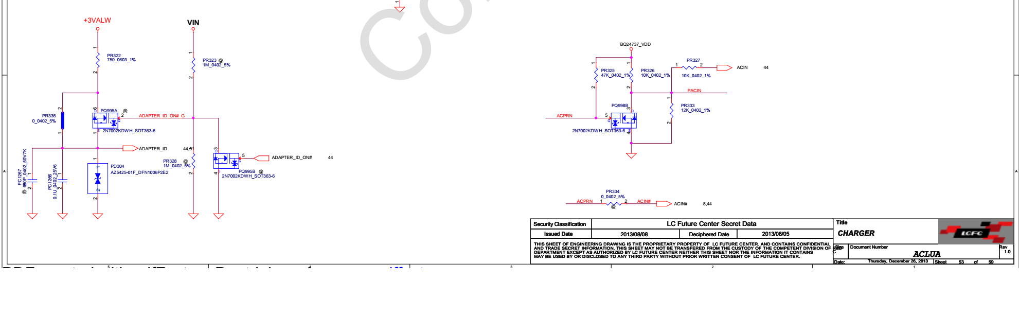

    Check the basics - voltage on:
    ADAPTER_ID_ON # - for n. 84 NCBs.
    on all PQ995 feet
    BQ - voltage on n. 5
    PR336 - in case of problems with identifying the power supply, you can temporarily solder it.
    Measurement without batteries, only power supply - original, functional, with adequate power or service power supply with a properly prepared plug.
    Enter the hob's current draw before pressing the switch and after pressing it.

    adamadi33
    Posts: 10516
    Help: 768
    Rate: 251
    Check this 3V regulator there are two such 3V and 5V.
    On the 3V system, you should have + 3VLP or + 3VL and check the resistances on this pin.
    There is pin 5 of the LDO on the system, i.e. +3 VLP.
    If there is no LDO there is a problem.
    You didn't need to replace the Charger chip.
    If you want to get help, answer the questions.
    Provide voltage from the regulator 3 V from 1 pin to 6 pin?

    65 W, 20 V power supply:
    285 ohms from ID to GND.
    90 W, 20 V power supply:
    548 ohms from ID to GND.

    There at the damage. PD304. (Then this diode, as a damaged one, is a resistor of approx. 5/70 ohm in both sides, this can be measured after hitting the circuit) usually it falls on KBC (there is a small hole in the housing).
    * Measure the whole track from pin to kbc, will you eliminate other broken pieces?
