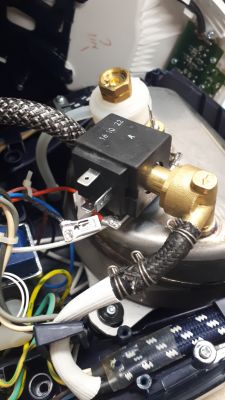

    My Philips GC9630 / 20 steam station is not delivering steam. From the moment it is turned on, the whole two-minute cycle goes through - the ready light blinks and after this period, when the light is constantly on (standby mode), the iron does not respond to the steam activation button. When pressing, you can hear a gentle ticking (like a solenoid valve, but I'm not sure what is ticking). During the start-up process, you can hear the water boiling - i.e. the heater is working. The iron is under warranty, but the service rejected the defect, arguing that the iron is calcified and will not repair. I suspect that the electronics / mechanical part was damaged because it stopped working overnight - if the reason was limescale (narrowed cross-section of the wires), I assume that you could observe a gradual deterioration of operation and not a sudden failure for the next day.
    Please help.

    For me, the problem was finally resolved after another prompt, still under the warranty service. The solenoid valve was damaged, which I identified myself before I returned it to the service. The service replaced the damaged solenoid valve - it can be bought at a price slightly above PLN 100 and has been working since then.
    Access to the solenoid valve is not difficult.

    The coil is crazy, unfortunately. I connect the solenoid valve coil to 230V and zero reaction. Measured also takes a break. So it remains to buy a new one and a spacer.
  • #7 17376518
    Marcin79
    Posts: 58
    Rate: 32
    I replaced the coil and now it works fine :) . Thanks "leny.555". Regards

    Capricorn - The coil itself will not be sold to you. I searched for a long time and asked. I ended up buying the entire solenoid valve. I moved the coil from a new one, and the valve is still there and waiting for better times :)

    Well, it worked, the coil was bought by eye and I was guided by its dimensions.
    here is a link to the store, it is also for PLN 25 on Allegro + shipping https://north.pl/promo/cewka-elektrozaworu-do...3oALTCb3QNKvTfqHRZ7kvTfqRW3KvTFzHRZ7kvTfqHRZ7
    Once installed, everything works great. Maybe someone would need a solution :)

    The replacement solenoid valve purchased at north.pl works like new, thank you

    I will join the topic, a new solenoid valve is bought, the GC9630 station is open. The question of how to disassemble the old solenoid valve? The disassembly is blocked by the hose fastened with a cotter pin. I would not like to damage anything.
    Added after 6 [hours] 46 [minutes]:
    Ok, the topic is over, 2 people are needed, one holds the base of the station, the other turns the valve counterclockwise.
    Just slide it just enough to pass the pressure hose and the valve comes off.
