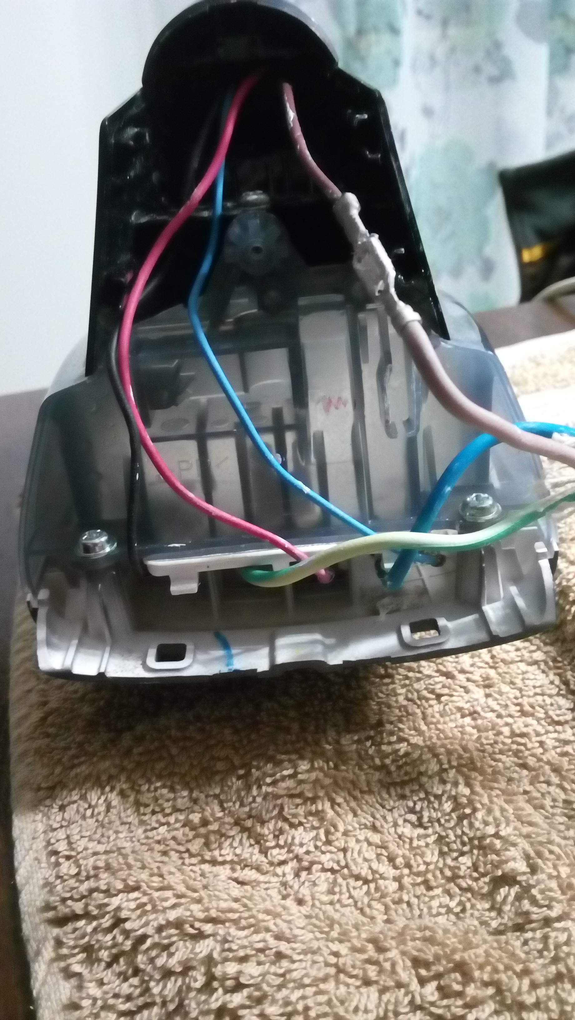

    I have a problem with the Philips Azur iron. It switches on for a moment, the lamp comes on, goes out after a second (you can hear the ironing noise), the soleplate does not heat up. I thought it was a "fireman system", so I missed it by plugging the brown power cord in place of the red one (photo before changing the wires). This operation did nothing, the lamps stopped lighting, no ticking was heard, the foot was still cold. What to do? Help.
    • Philips Azur GC4410/02 Iron: No Heat, Lamp Turns Off, Soleplate Cold - Troubleshooting & Help 222.jpg (2.04 MB) You must be logged in to download this attachment.

    MARCIN.SLASK
    Home appliances specialist
    Posts: 11905
    Help: 1037
    Rate: 2658
    Keep looking. Somewhere, the cause is deeper.

  • #4 16855404
    wiesiekmisiek
    Posts: 1588
    Help: 259
    Rate: 524
    Probably a thermostat to replace.

  • #6 16856575
    MARCIN.SLASK
    Posts: 11905
    Help: 1037
    Rate: 2658
    Basic universal meter and minimum measurement knowledge required. Measurements, of course, with the power plug removed.
    Most irons have a non-removable thermostat. And this model has a thermostat welded to the supply plates.
    Often dust will come into contact with the thermostat and will not contact.

  • #8 16858789
    MARCIN.SLASK
    Posts: 11905
    Help: 1037
    Rate: 2658
    The meter on the 200? resistance measurement range (the large majority of meters).
    We measure the heating rate (
  • #9 16858799
    marqqv
    Level 32  
    Posts: 1758
    Help: 162
    Rate: 609
    MARCIN.SLASK wrote:
    There is often a thermal fuse
    That I would start with.
  • #10 16859075
    Gordon12
    Posts: 153
    Help: 5
    Rate: 18
    Thermostat to check 99%
  • #11 16860587
    frytkowski82
    Posts: 44
    Rate: 38
    Thank you all for the advice ... I started by cleaning the contacts in the thermostat with fine sandpaper and heats :-) , only something doesn't steam, but I wait until it gets warmer.
