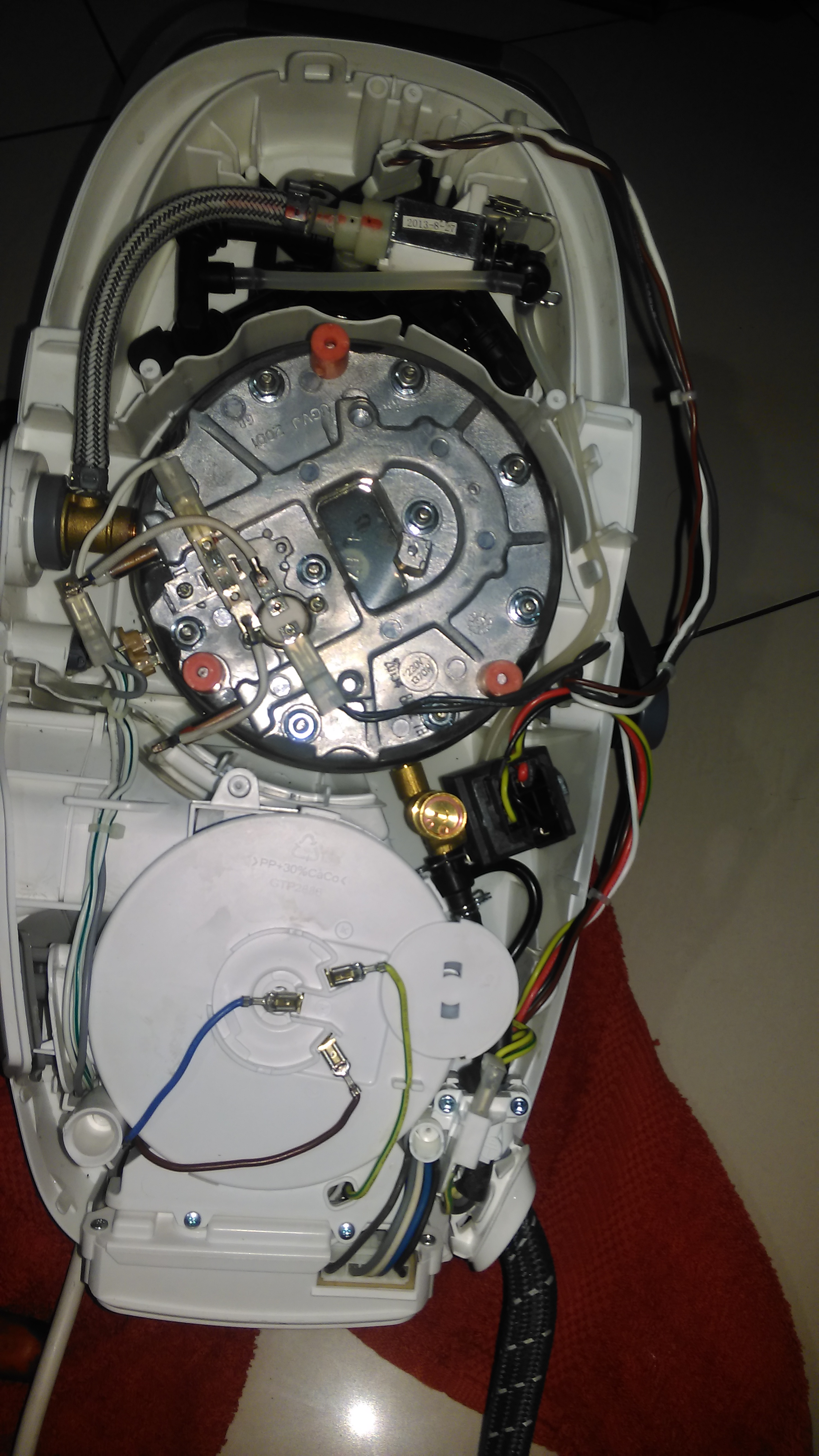

    The steam station does not supply steam or water, the solenoid valve clatters when I press the steam generation button, you can hear the steam station turn on every now and then, once it shows the lack of water, the second time it does not, I unscrewed the plugs, the iron began to release steam constantly, constantly and water was flowing from it what it never happened. Adds a photo of the inside of the steam station
    Below is the rattle that comes out of the steam station, link on YouTube
    https://youtu.be/YlVAeZYLJpo
    • Tefal GV8980 steam station - Does not deliver steam, water to the iron IMAG0014.jpg (1.95 MB) You must be logged in to download this attachment.

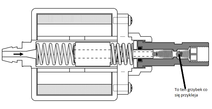

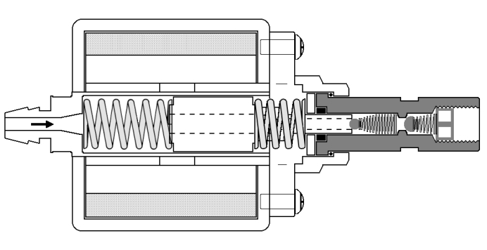

    Krzysztof Druś
    Level 21  
    Posts: 387
    Help: 35
    Rate: 85
    Well, check the air flow through the pump, if there is resistance and then it releases air, it's ok, the pump will feed water and if water is leaking all the time, this valve at the boiler outlet is open and should turn on after pressing the button in the iron's handle. it's the one in the black rectangle where two or three wires come in.
    https://www.youtube.com/watch?v=we9IZJ5tQFs
    • Tefal GV8980 steam station - Does not deliver steam, water to the iron 269_ulka01f.jpg (58 KB) You must be logged in to download this attachment.
    • Tefal GV8980 steam station - Does not deliver steam, water to the iron 269_ulka01f.jpg (61.49 KB) You must be logged in to download this attachment.

  • #14 17018555
    Krzysztof Druś
    Level 21  
    Posts: 387
    Help: 35
    Rate: 85
    And shouldn't an empty water tank be inserted, there is probably a magnet there? Only not upside down to check it is supposed to stand like to work on legs.

  • #21 17019204
    supermarcin88
    Posts: 16
    Rate: 23
    I just poured vinegar and now the valve has stopped working, you can hear the pump giving pressure, the vinegar disappears from the tank, it is empty, the indicator of the lack of water is not lit (which surprises me). I press the steam button on the iron and nothing, yesterday it was the other way around, when pressing the button on the iron the valve worked and the pump turned on very rarely, now the pump works every now and then and the valve unfortunately does not
  • #22 17019234
    Krzysztof Druś
    Level 21  
    Posts: 387
    Help: 35
    Rate: 85
    He collected the garbage after knocking lightly on the valve and pressing the steam button at the same time. Maybe you need to dismantle the steam valve and blow it out, you can do it with vinegar, the boiler has a stone inside, you can pour it through the drain plug, wait to pour it out.
    https://www.partmaster.co.uk/product.pl?pid=214249
    • Tefal GV8980 steam station - Does not deliver steam, water to the iron tefal.jpg (27.49 KB) You must be logged in to download this attachment.
