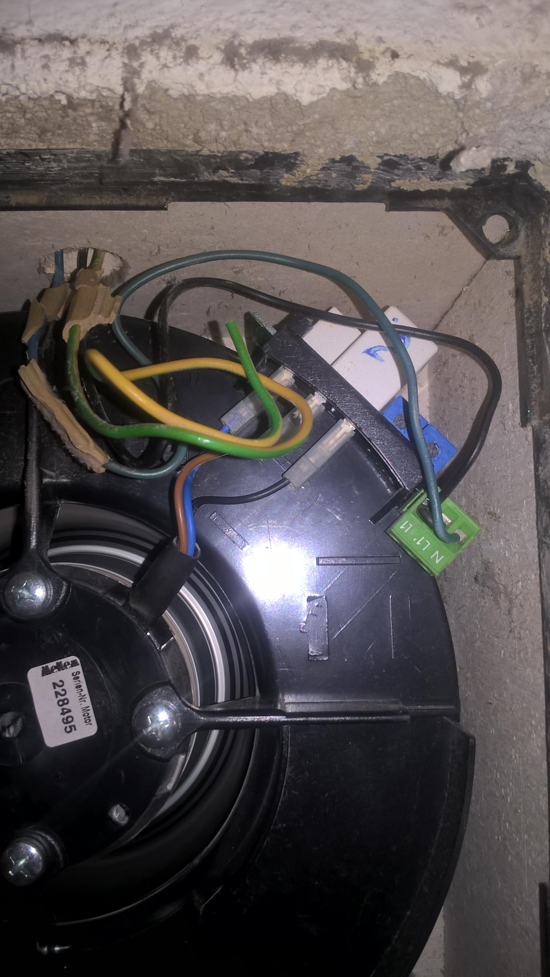

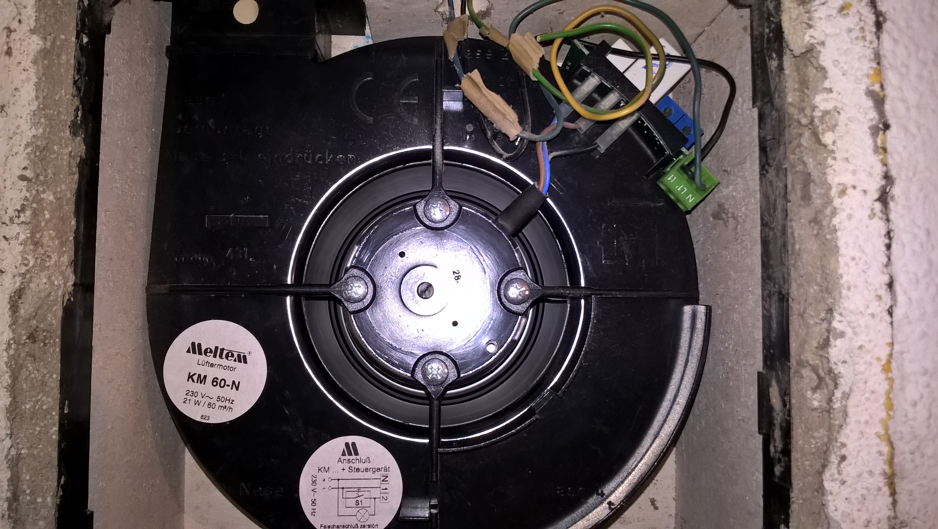

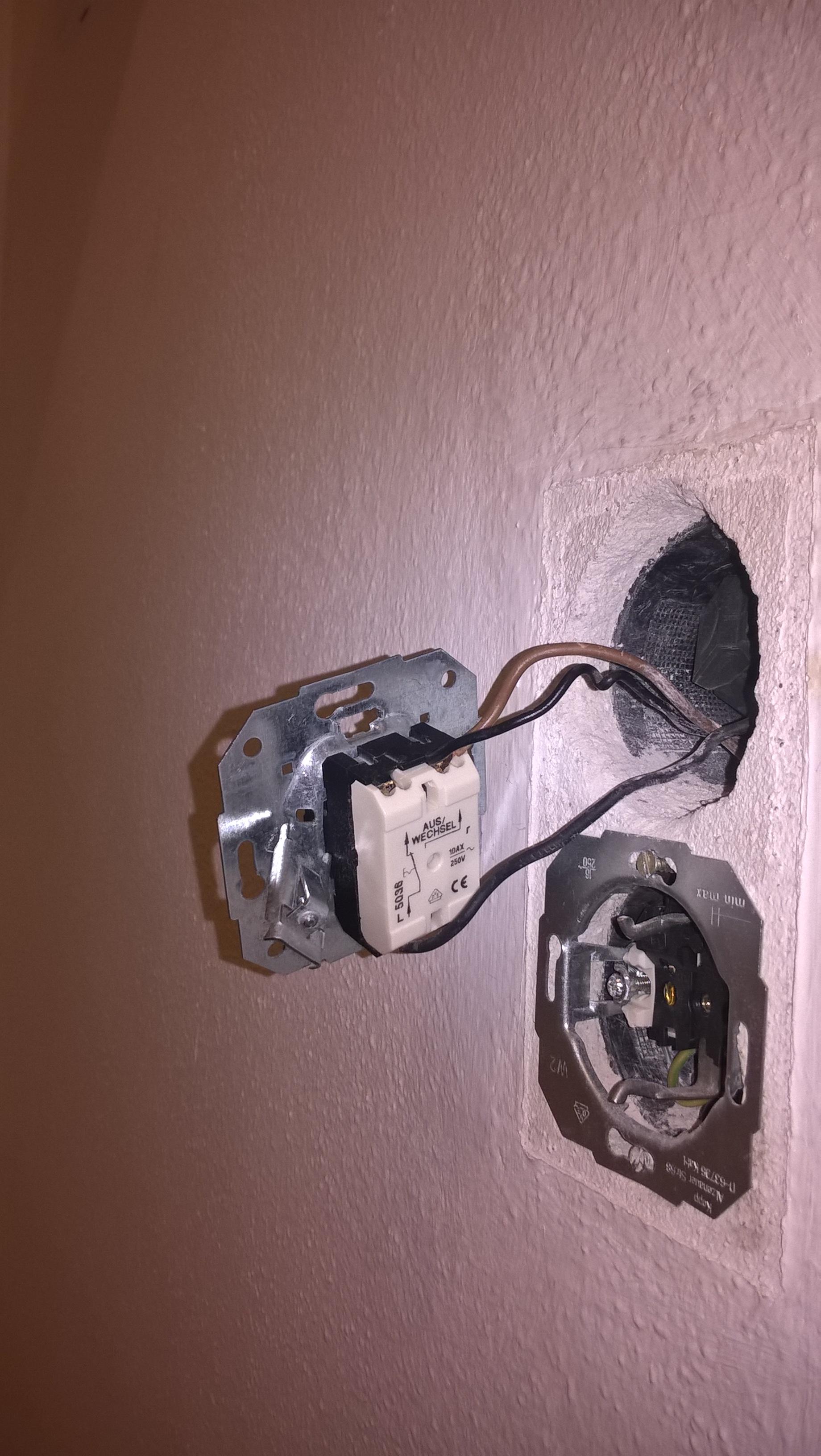

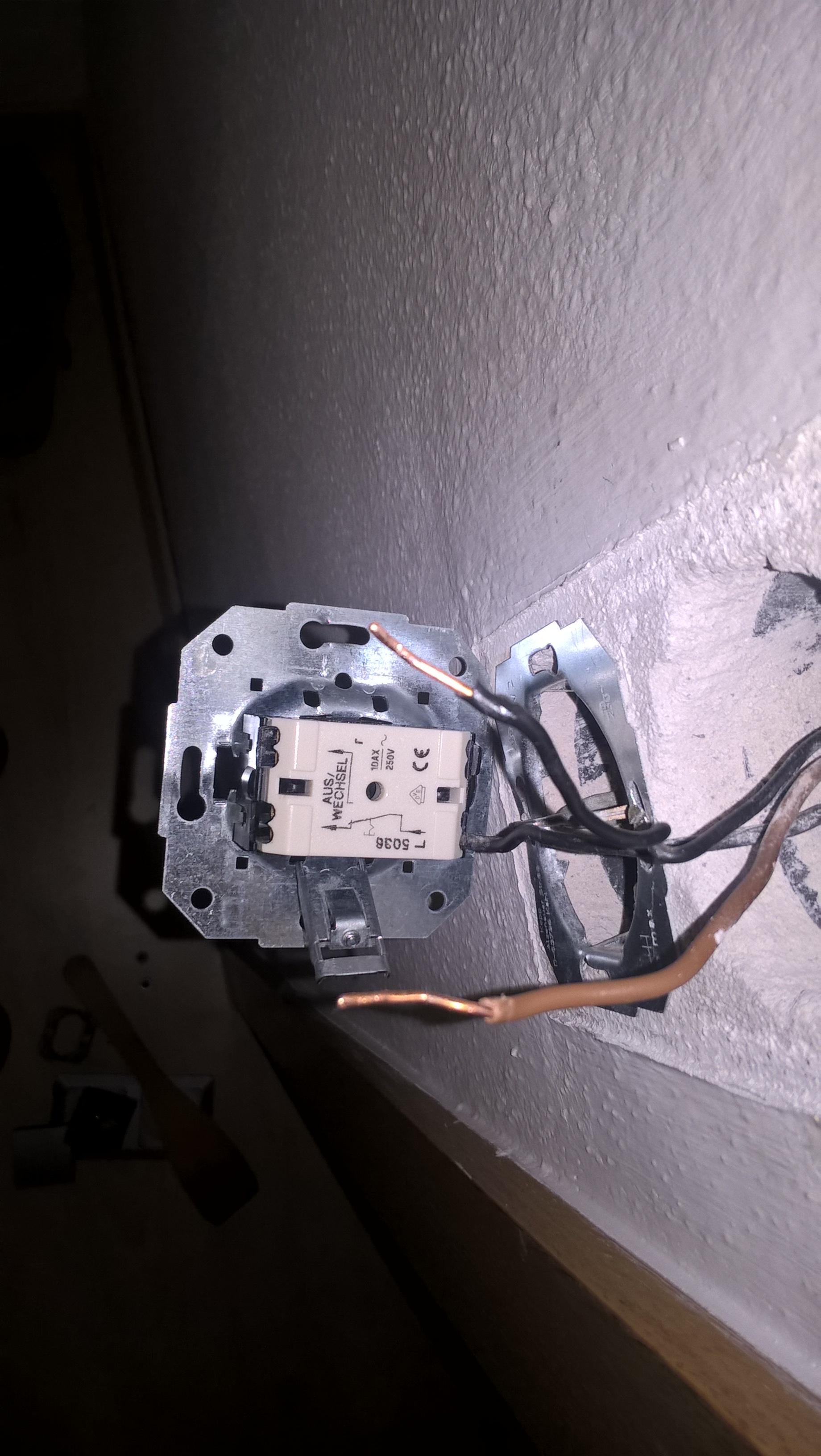

    I have a problem with a bathroom fan. The fan in the bathroom Meltem G-4 started working as the light in the bathroom was on for more than 30 sec and turned off 2 min after the light was off. I wanted to switch it to turn on a few minutes after the light was on. So I took apart the light switch from the bathroom and one of the wires fell out. I put it in the same place, but now the fan turns on as soon as I turn on the fuse. I thought maybe I had connected that wire wrong, but even disconnecting the switch didn't help. Still the fan turns on together with turning on the fuse from the bathroom, even if the light in the bathroom is off. I attach pictures of the switch.
    Is it possible that with the fan there is an adjustment for the delay time and run time?

    It seems to me that the brown one at the top goes to the fan. That black wire at the bottom is described as L, but when I turn off the black one at the top, the bathroom light does not light up.

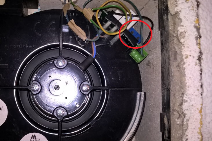

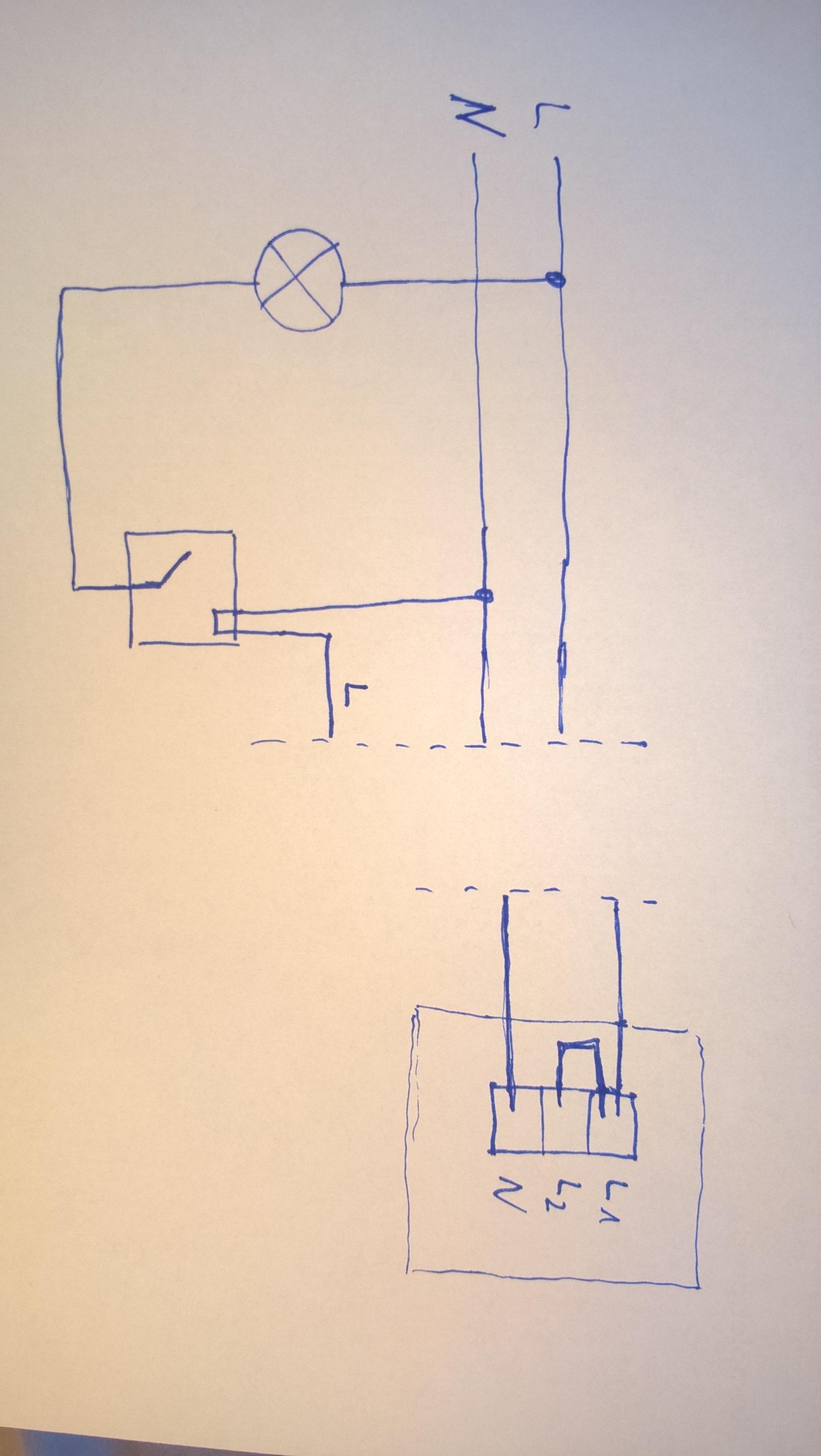

    Thanks for your reply. Your schematic is clear and that's how it should be connected according to the instructions.
    Unfortunately, there is a trick done here. In the picture you can see the connection of the fan. There are only two cables N and L coming in, L is also plugged into the Ls socket.
    I have drawn what I think the wiring diagram of the fan looks like, I do not know what happens between the dashed lines and what right it worked.

    vorion wrote:
    I've drawn what I think the fan wiring diagram looks like, I don't know what's going on between the dashed lines and by what right it worked.
    In a circuit like yours, it could only work when voltage was applied by the switch and went off as the switch was turned off.

    Looking at the circuitry of this fan, it's hard to believe that it worked with a delay....
    vorion wrote:
    The Meltem G-4 bathroom fan started working as the bathroom light was on for more than 30 sec and turned off 2 min after the light was off.
    It is likely that somewhere along the way there is still a timer controlling this fan.
    When it comes to adjusting the operation, if I see it correctly there are two blue potentiometers
    Meltem G-4 Bathroom Fan Constantly Running Despite Light Switch and Fuse Adjustments .
