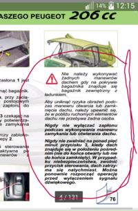

    The problem is with the roof. In the morning it opened without any problem, but when I wanted to close it in the evening, the car engine was on. when the roof was closed halfway, the engine stopped because it switched to gas (but never mind) and now I can`t do anything, finish closing or opening it, because it beeps when I press the button. Please tell me what to do now

    Peugeot 206 CC Roof Stuck Halfway: Engine Stopped, Gas Exposure, Squeaking Button Issues there is a note in the manual that the ignition must be on all the time. evidently the roof stopped after the car engine turned off. the blind must have been good since the closing started without a problem, but just in case I moved it several times but with a negative effect. as for the fuses, I will check it.

    I have already managed to fix the problem. The main cause of the roof stopping halfway through the operation, however, turned out to be a temporary lack of ignition. I put the roof down manually with the help of the sent video for which I thank you very much. after that, the roof now opens and closes automatically without any problem. I hope that the post will be useful to someone in the future ;-) ps. it was necessary to put a little more force to screw on the Allen key and nothing was damaged :-) as an amateur in these matters, I am very happy that I did not spoil anything :-)
