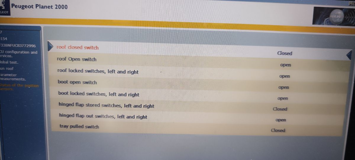

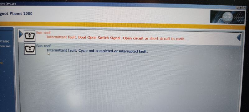

  • Request for sensor diagrams to diagnose roof fault
    #3 20610564
    ministerpl
    Posts: 169
    Rate: 74
    I have a problem with the roof, my wife opened the roof and can't close it. I downloaded the manual manual from closing the roof, but I still have an error and I can't close it. I am looking for diagrams which sensors are which and please help below I attach photos from pp2000 Peugeot 307 CC Roof Issue: Not Closing, Mechanism Faulty, Battery Clamp & Error Messages Peugeot 307 CC Roof Issue: Not Closing, Mechanism Faulty, Battery Clamp & Error Messages

  • #4 20610569
    zenekmartens
    Posts: 981
    Help: 13
    Rate: 61
    Does it have a net in the trunk?
  • #5 20610570
    ministerpl
    Posts: 169
    Rate: 74
    So first thing I check
    If the grid was not closed it would show screen not on place error on the display
    The screen shows two errors, the first error is root mit closed, the second one after pressing the roof opening or closing switch, after about 5 seconds, the Fallout mechanism appears
