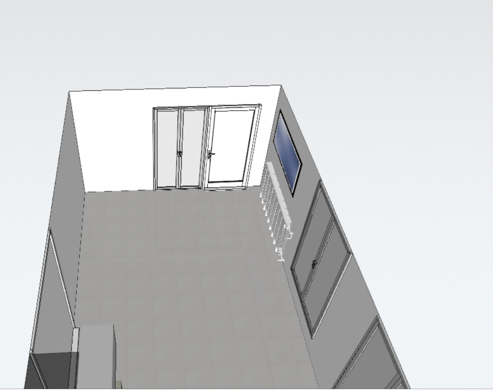

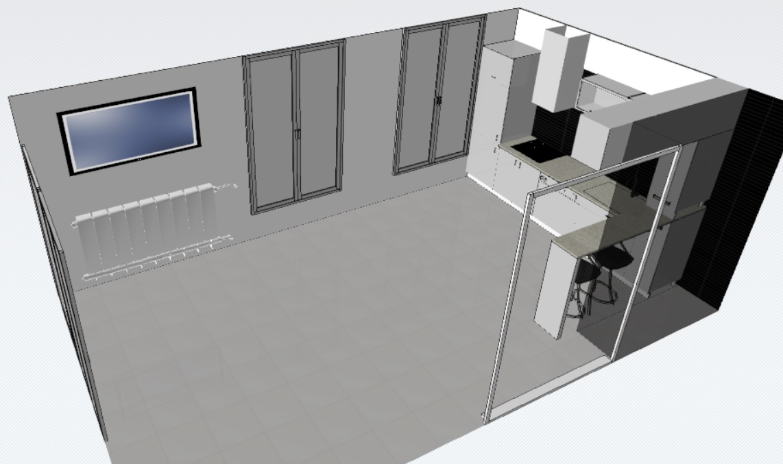

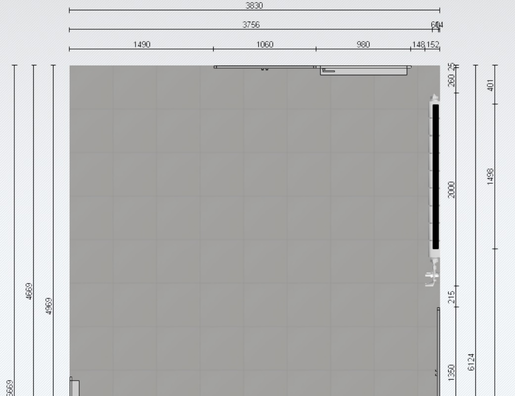

    Hello, not a typical question today.
    The problem is that my living room is not very regular (Photos below).
    Influence of Radiator on TV Placement: Effects on Usage & Alternatives (2000x900x152 mm) Influence of Radiator on TV Placement: Effects on Usage & Alternatives (2000x900x152 mm) Influence of Radiator on TV Placement: Effects on Usage & Alternatives (2000x900x152 mm)
    All lines (electricity and optical fibers) are led out on the radiator side.
    Question ?
    Is it possible to place the TV above the radiator (the dimensions of the radiator are: 2000x900x152 (mm)), may it have some effect on future use? Is it better to give some do not know a shelf or a valve between them so that the heat does not hit the TV?
    I would like to add that I do not want to move the TV to the other wall because then I will be forced to block the radiator with a corner, which is one for the living room and kitchen, so a light lime tree.
    Thanks for your help :)

    As much as possible at the height of the radiator, not above - the heat rises up.
    It is enough to put a TV table and a TV on it, at a minimum distance of 30-40 from the radiator and the matter is settled. If we place the TV over a radiator, the heat from the radiator will be sucked in by the TV, the internal temperature of the device will increase, which will contribute to faster wear / damage to the TV.
