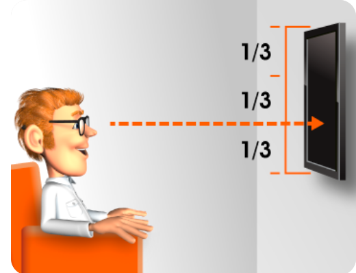

    I found interesting articles on this topic:
    https://www.tvinstallationservice.ca/optimal-tv-height-viewing-distance/
    https://www.tomsguide.com/us/how-to-mount-tv,news-24719.html
    One of them states that:
    "The maximum height of the TV should be determined by the size of the screen so that your eye level is in the bottom 1/3 of the TV screen. If you choose to mount the TV at a higher level, the higher you go, the more it will get in the way."
    Choosing the optimal height for 55 and 65 TV in a wall unit - 4m distance from sofa
    For a viewing level of 110 cm (eye level) and a 55" TV (approx. 70 cm high) the calculation to determine the bottom edge of the TV from the floor looks like this:
    110 - (70/2) = 75 cm -> the center of the screen is the height of our sight, i.e. 110 cm.
    110 - (70 / 3) = 87 cm -> 1/3 of the screen is at eye level, i.e. the center of the screen is 122 cm (87+35).
    The center of the screen for viewing at the level of 110 cm should be in the range of 110-122 cm (optimally - max). Average: 116 cm.
