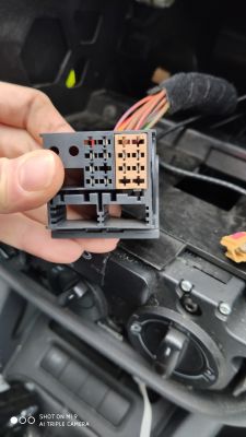

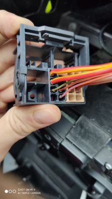

    I bought a Chinese 7018B radio.
    I bought an adapter from the original ISO cube to the new radio, I don't know which wire is for what (original ISO cube). I am also uploading the scheme of the old radio and the scheme of the new one. How to connect new ones? Connecting Chinese 7018B Radio to Volkswagen Golf 5 Using ISO Cube Adapter
    Connecting Chinese 7018B Radio to Volkswagen Golf 5 Using ISO Cube Adapter Connecting Chinese 7018B Radio to Volkswagen Golf 5 Using ISO Cube Adapter Connecting Chinese 7018B Radio to Volkswagen Golf 5 Using ISO Cube Adapter
    I know that one cube is for speakers, i.e. the brighter one, but I do not know which wire is used for what from this black cube, I do not want to spoil the radio
  • #2 18375431
    aras4don
    Posts: 50
    Take an ordinary meter, find the mass in the cube and 3 plus 12V. One +12V is constant, the second and third when the ignition is turned on. Regards
  • #3 18376269
    Szymon7507
    Posts: 151
    Help: 6
    Rate: 55
    That's all I know. The only question is which one is from the battery, which is from the ignition and which is from the memory, etc
    There are 6 wires in this cube and I want to know which one is for what.

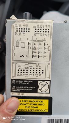

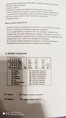

    #4 18461951
    gradek83
    Posts: 9123
    Help: 930
    Rate: 2106
    Your original radio is controlled from the CAN bus, so in my opinion the connection should look more or less like I drew, but I don't know if it will work. You have an optionally connected car alarm with the original radio and here I am not sure if the alarm will work for you after replacing it, so this Chinese radio is probably not dedicated to your car. Of course, you can try to combine it for a short time and check it yourself, but what will come out of it, you will check it yourself and let me know if this solution will suit you. If not, look for a radio dedicated to your car model. But from what I see you have a basic sound system, i.e. a simple stereo.
  • #5 18461975
    Szymon7507
    Posts: 151
    Help: 6
    Rate: 55
    I have already done. But thank you. I did so. I connected the battery to the radio's memory, speakers, camera, etc. as it should be, and as for switching on the radio, I did the following: in the fuse box I found + 12V after turning the key to position 1, i.e. not yet ignition, later I checked if there is + 12V on the ignition too that it is. So in place of this fuse, I entered the bypass and plugged in the old and new fuses, pulled the wire to the ISO cube of the radio and connected it. The radio works fine. It only doesn't work when the key is removed, but that's not a problem. I know Chinese radio is... But I only bought it because it's an old car that my fiancée drives, so she doesn't need a better one and it's still way better than the original. Here is a mirror link etc. I have only one problem with the reversing camera. When the key is turned to position 1, everything is fine after putting the reverse gear on. Looks beautiful. But when the engine is running, the picture jumps and shows no signal and turns on and off. It's likely that the interference is caused by the unshielded cable. I bought a new one, I'm waiting for the courier to bring it, when I connect it, I'll tell you what and how.
  • #6 18461997
    gradek83
    Posts: 9123
    Help: 930
    Rate: 2106
    Szymon7507 wrote:
    after turning the key to position 1, i.e. not yet ignition, later I checked if there is + 12V on the ignition, it turned out to be
    This is ignition, i.e. ACC / ON, engine start is Engine START, i.e. supplying voltage to the starter. With ACC/ON without starting the engine, you already have the necessary voltages in the circuit.
    Because you cut off ACC / ON, you would have to connect the Battery + cable directly to the battery, so that when the Ignition Switch or ACC / ON runs out of voltage, the radio goes to sleep.
    Szymon7507 wrote:
    it's so much better than the original
    Well, there are more goodies, that's for sure.
    Are you talking about the camera? reversing?
  • #7 18462036
    Szymon7507
    Posts: 151
    Help: 6
    Rate: 55
    Yes, the reversing camera
    Because you cut off ACC / ON, you would have to connect the Battery + cable directly to the battery, so that when the Ignition Switch or ACC / ON lacks power, the radio goes to sleep.
    Am I to understand that two wires are to be connected from the battery to the radio? Because one of the batteries is memory and the other is also from the battery but to excite the radio?
  • #8 18462169
    LWD11
    Posts: 1406
    Help: 223
    Rate: 486
    Are you sure you connected the power supply of the camera directly to the reverse bulb? :D
    You need to control the camera's power supply so that it is powered from a different +12V point than the reverse bulb. / e.g. as is, power supply from the rear cigarette lighter,. etc... / The easiest way to control it is to use the relay controlled by the reverse bulb.
    BUP 12V on which there should be voltage all the time, in the original cube it is like that, use it.
    To the ACC radio, connect a plus from the car that turns off with the key / the easiest way is to look in the fuse box /
    This radio must have the ACC positive connected to put it to sleep
  • #9 18462188
    gradek83
    Posts: 9123
    Help: 930
    Rate: 2106
    You have the choice of either SMALL anti-interference filter for reversing camera. - it doesn't always work.
    Or power the camera from the battery and the reverse light will turn on relay 12V power supply from the battery to the camera and the A2 Back IN cable.
    Battery + is the memory of the radio, i.e. when you turn the ignition switch to OFF, i.e. turned off, the radio goes into sleep mode after a while and a small current is drawn from the battery to maintain the radio memory.
