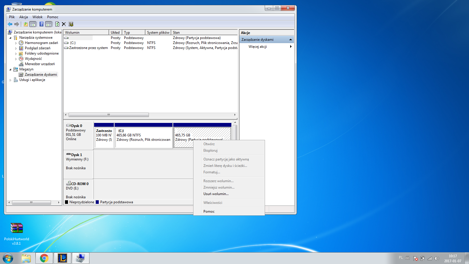

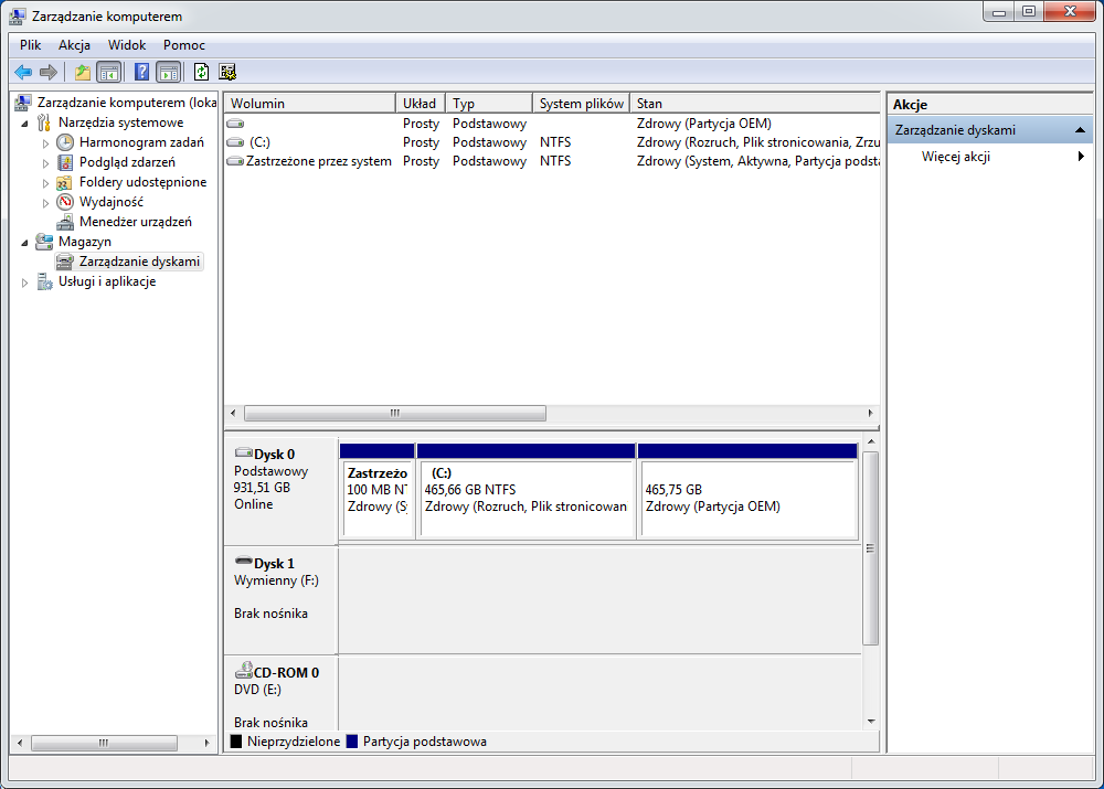

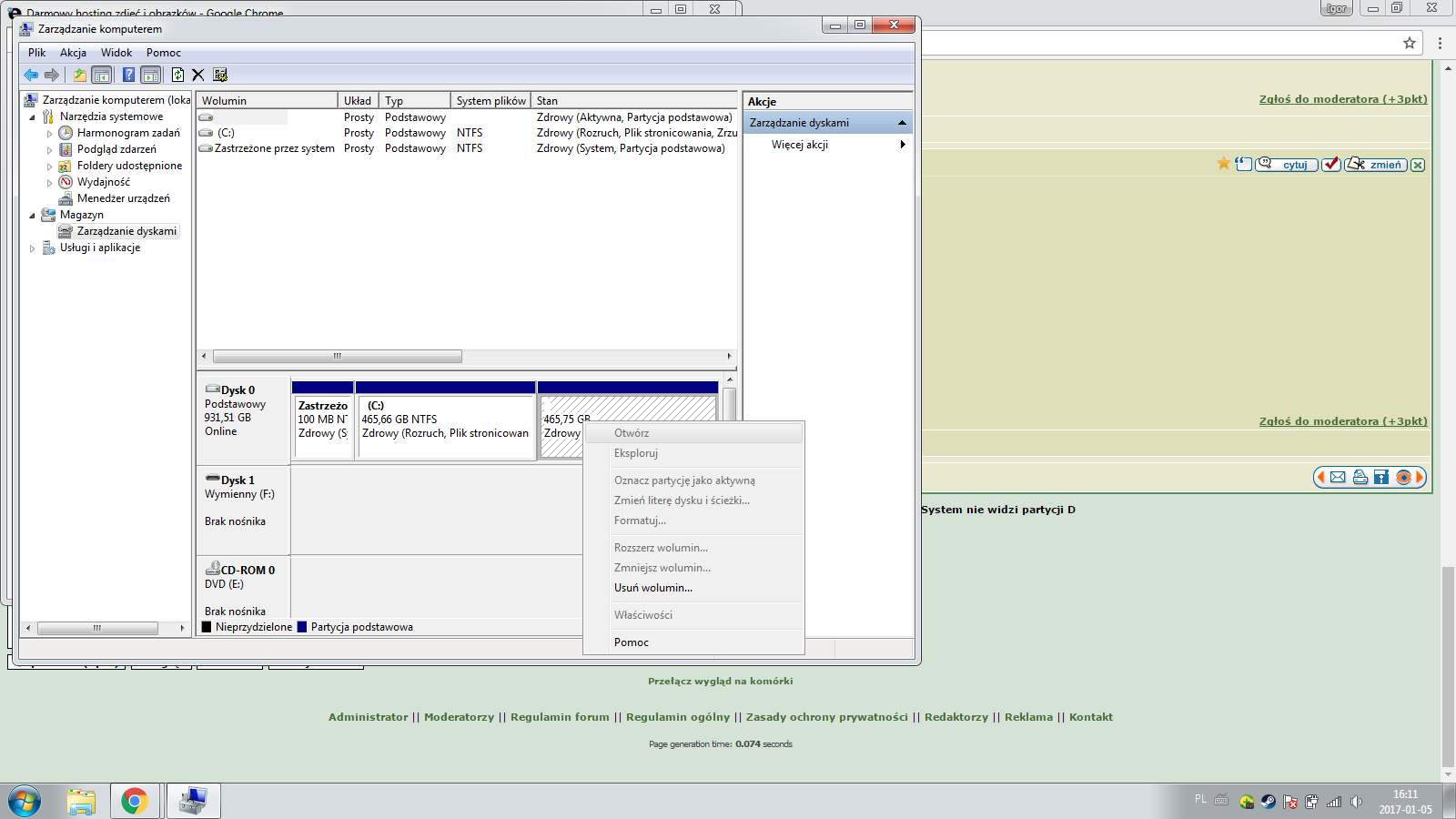

    Hello, after the C partition format with the system and reinstalling the win 7 home premium 64 bit system, I can't see the D partition next to the partition where I have a lot of important data. I'm a little green so I don't want to touch anything myself and I say right away that the format is out of the question. I will add attachments.
    • Win 7 Home Premium 64-bit: D Partition Not Visible After C Partition Format & Reinstallation Bez tytułu1.png (61.7 KB) You must be logged in to download this attachment.
    • Win 7 Home Premium 64-bit: D Partition Not Visible After C Partition Format & Reinstallation Bez tytułu.png (61.89 KB) You must be logged in to download this attachment.

    Please start by trying to assign a letter.

    I do not see such an option after right-clicking on this partition Win 7 Home Premium 64-bit: D Partition Not Visible After C Partition Format & Reinstallation
    Please use ppm on the partition shown at the bottom of the applet - where drives are listed - and choose "Properties" first.

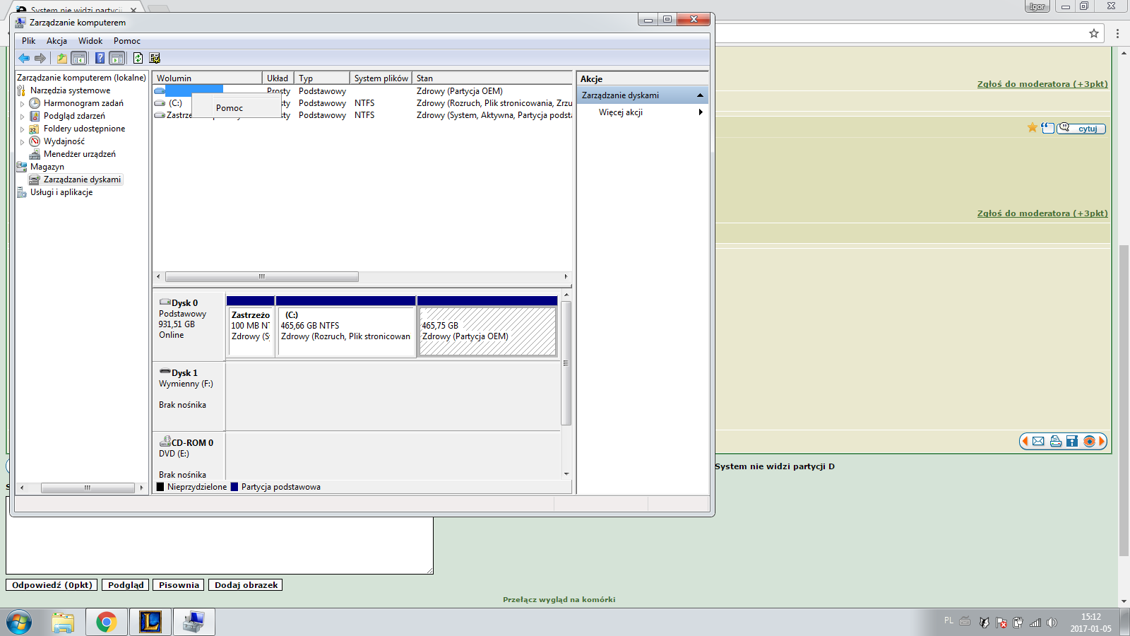

    When I use PPM, only help appears at the bottom. I will not delete the partition because I have data on it that I do not want to lose. As for the program, I downloaded the test disk, I do not know if it is suitable and too much how to use it

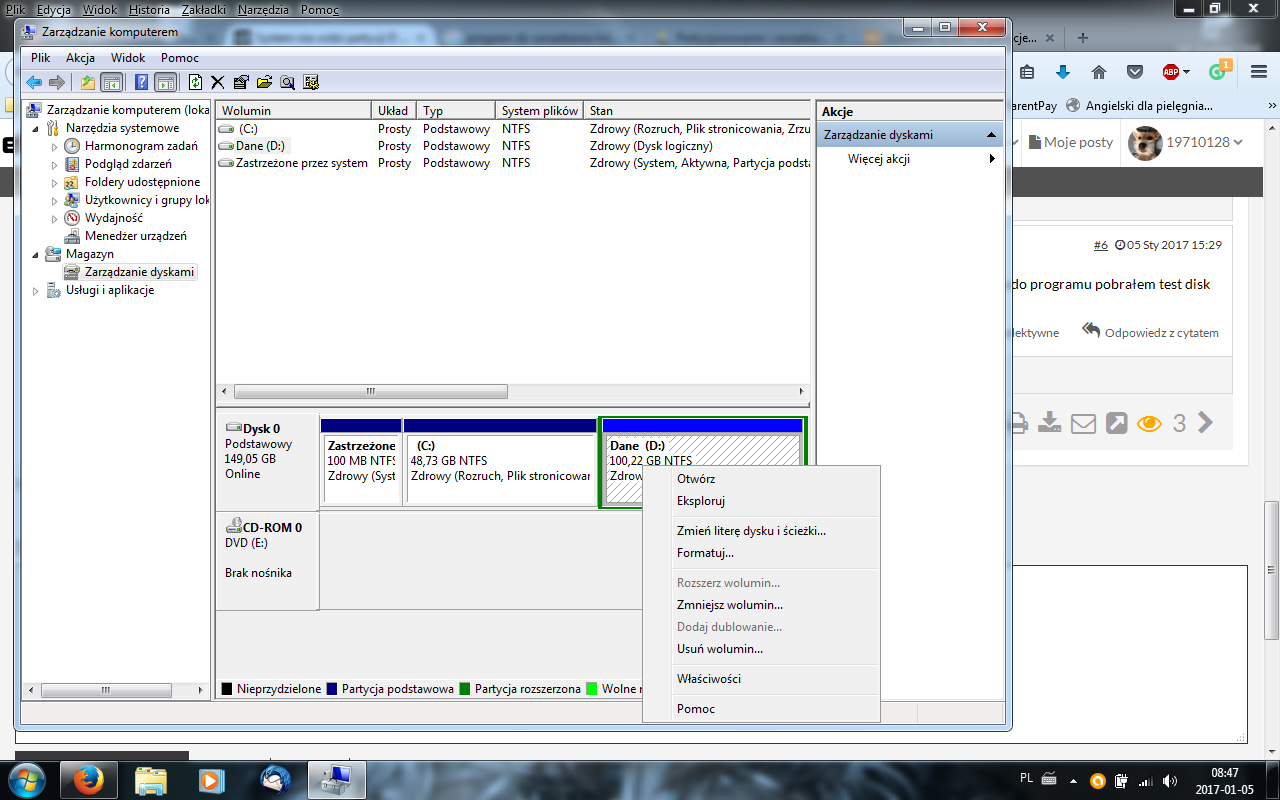

    As matuzalem advises, click on the partition with the right mouse as the window opens, the third position from the top "change the drive letter ..."

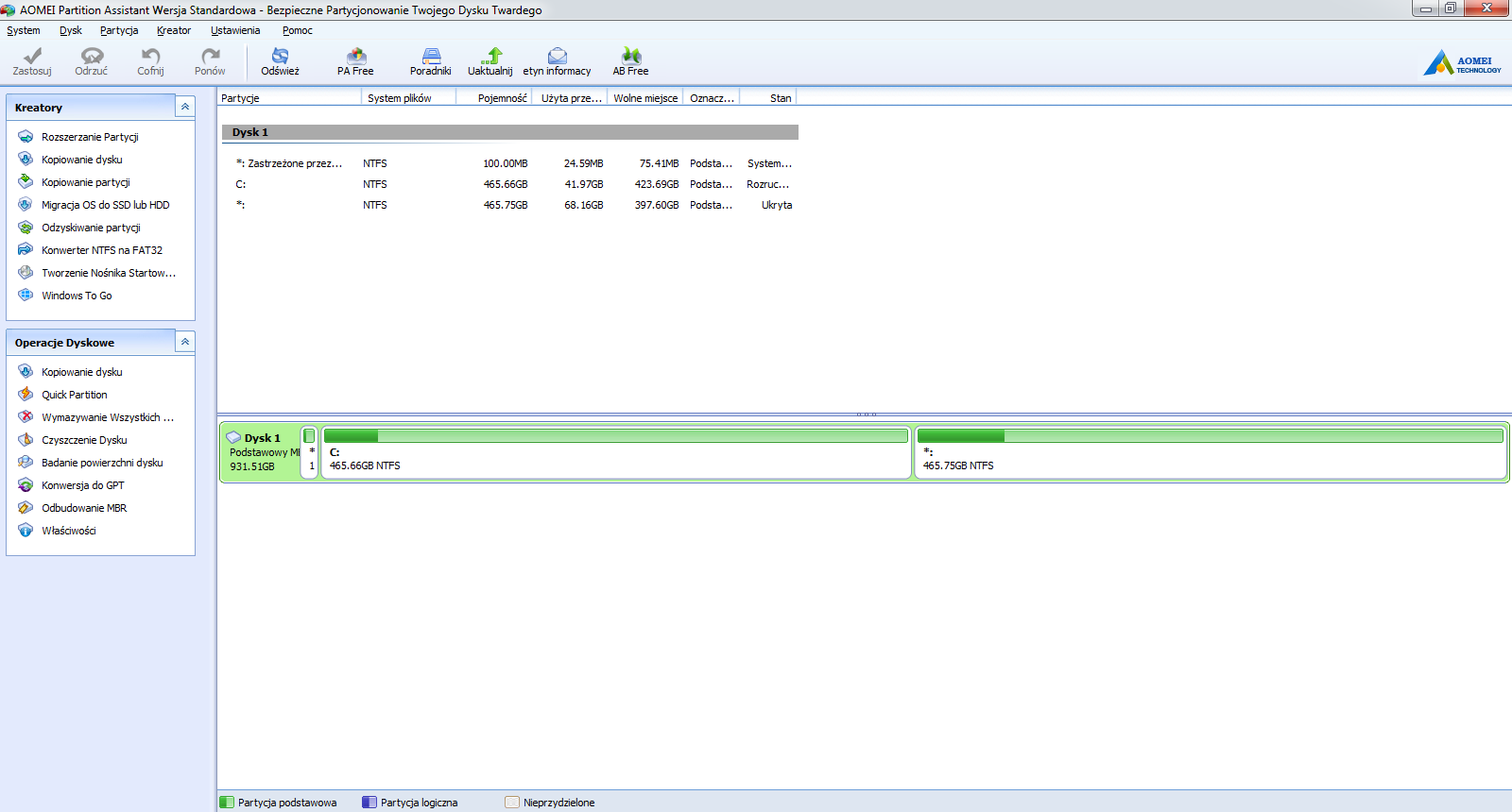

    Added after 3 [minutes]:

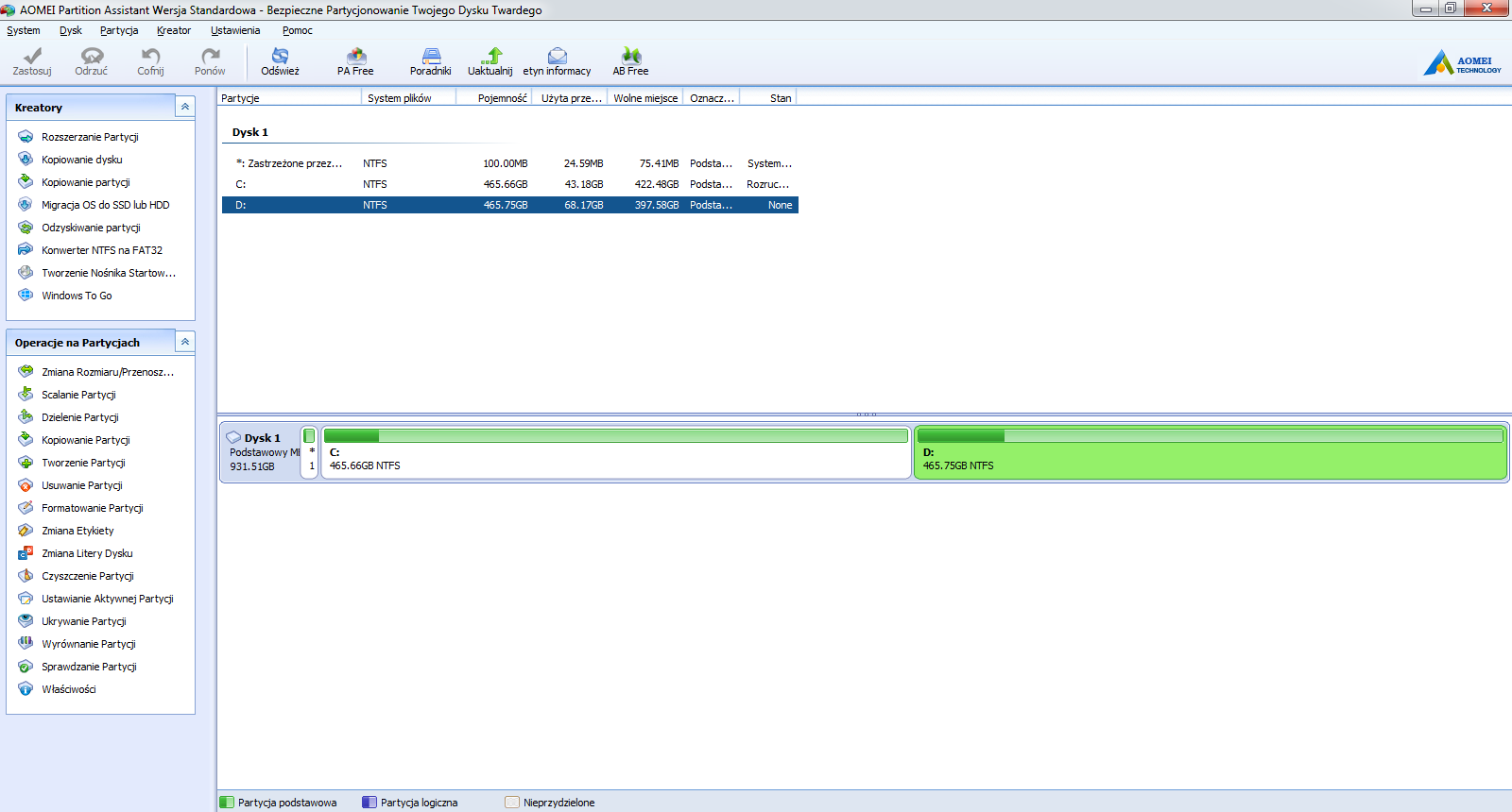

    I downloaded AOMEI Partition Assistant
    Added after 8 [minutes]:
    I will add pp Win 7 Home Premium 64-bit: D Partition Not Visible After C Partition Format & Reinstallation
    Added after 15 [minutes]:

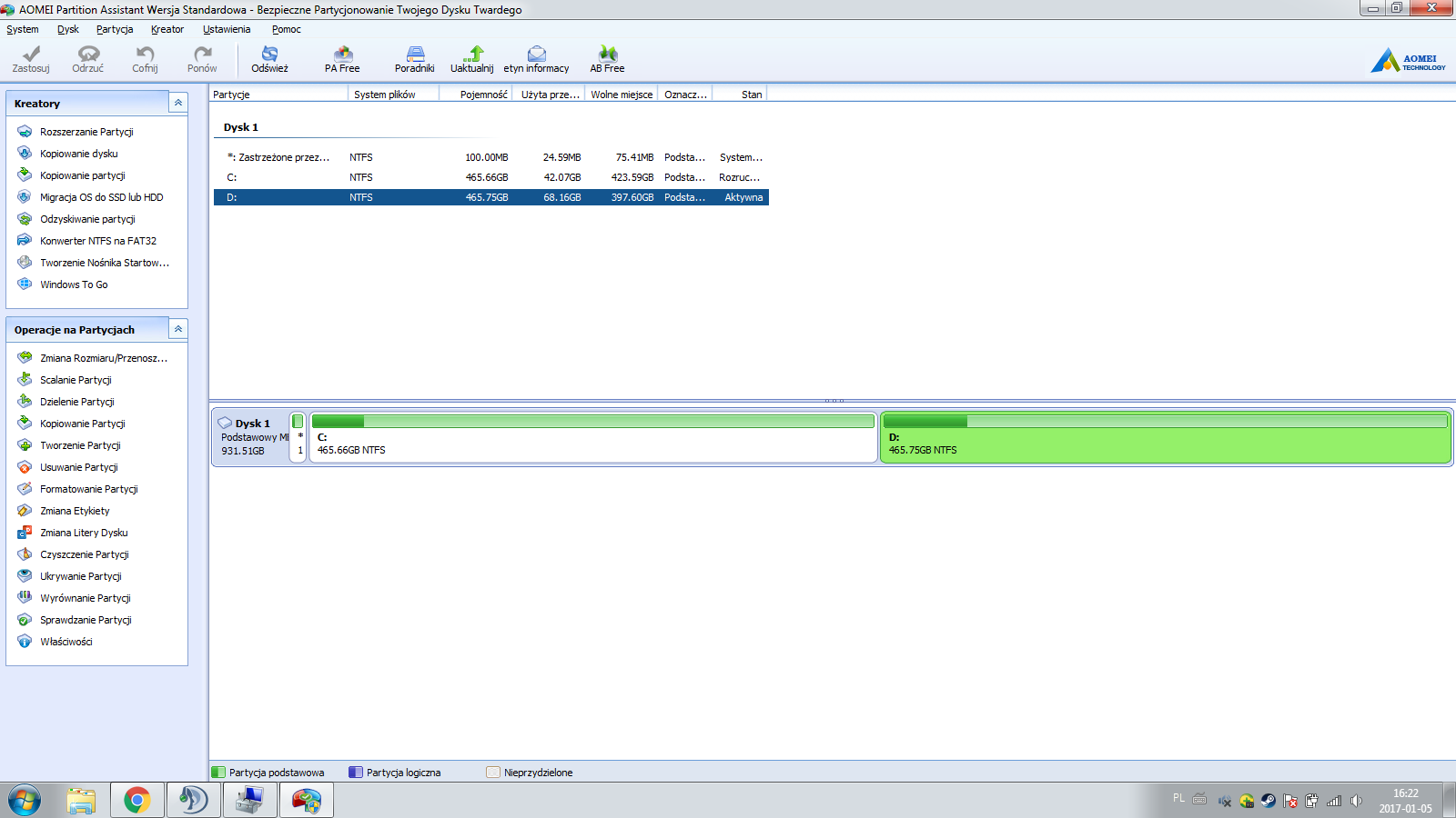

    The partition was hidden, I discovered it using a previously downloaded program. I tried to use it to give a letter as if it showed that it was successful, but for the partition there is no letter I will add that now there is an option but they are gray, I can't click them Win 7 Home Premium 64-bit: D Partition Not Visible After C Partition Format & Reinstallation
    Added after 11 [minutes]:
    Here it shows everything to that there is a letter and NTFS and here it is missing.

    Something not like that, show the DMDE screen from the partitions window view after selecting this disk from physical devices - wrong partition type. Lest it sometimes turns out that it is a created backup partition, or a recovery partition with other than your data and data is partially overwritten.

    The partition was assigned an OEM ID (ID = 12) as if it were a Recovery partition, and Windows does not see any filesystem on it. You are too hastily to operate on this partition without having a copy of the data ...
    Why did the partition become active? If it's not a system partition, now you won't be able to boot from that disk. Only one partition on the disk can be active, and that should be the partition where the boot sector is located.

    Now change c to active and since there is a letter it should be fine. After making changes, you must select the apply button in the program. Usually the computer restarts and then check.

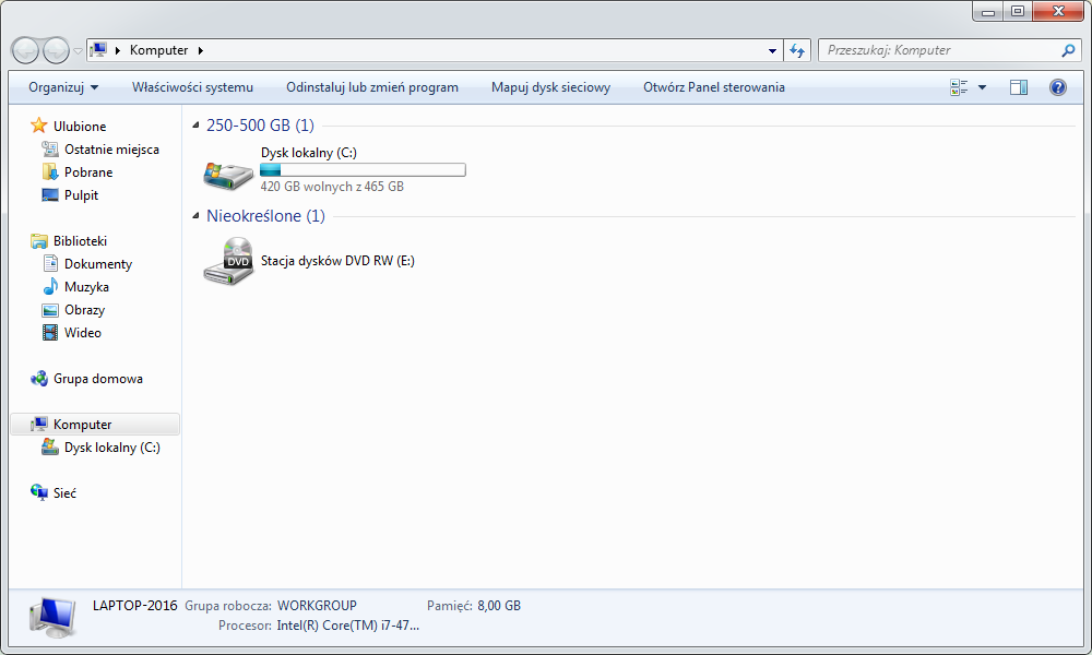

    When it is discovered, the explorer or my computer should see it.

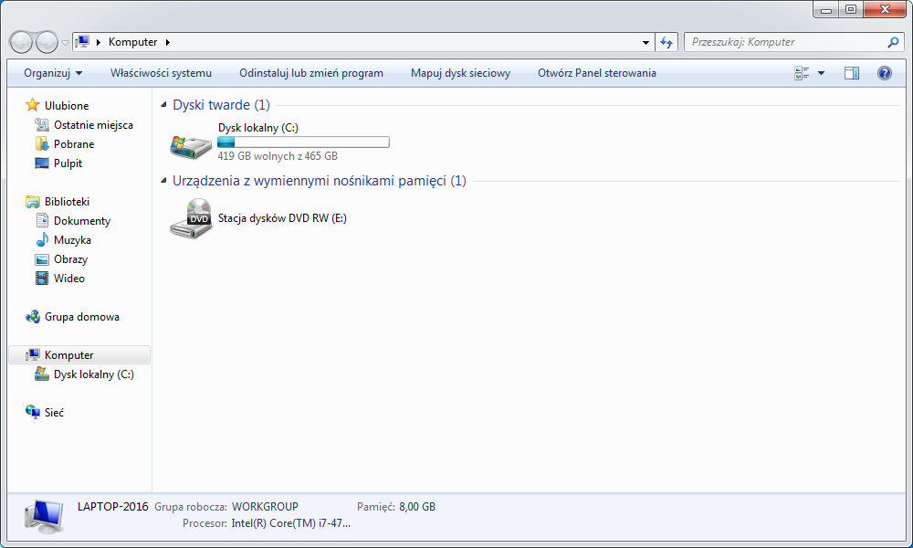

    but he can't see Win 7 Home Premium 64-bit: D Partition Not Visible After C Partition Format & Reinstallation

    There must be a letter. But if, after the last time, the program set it active itself, there must be a boot sector on it. Are you sure the data is there? did you use this partition? Use the program again just pay attention to active partitions.
  • #20 16179697
    NeedArcher
    Posts: 18

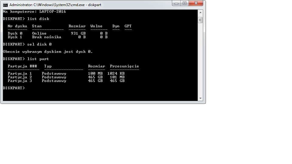

    I accidentally set the partition to active. The data there even shows that out of 465 397 are available. And I think I know why you can't see the partition. I followed these tips because the button didn't work for me and I had to select partition D and gave it set id = 12.
    Is there a chance to get it back now?
    Added after 34 [seconds]:
    https://support.lenovo.com/pl/pl/documents/ht069233
    I chose the 3rd partition (because it said that it is usually the last and highest-numbered partition) and entered set id = 12.

    Change the ID to 07. Also show the DMDE screen from the partitions window view after selecting this disk from physical devices. Maybe it is not your previous data partition, but one created during installation. Did you only have 30GB of data on it ?.

    I set this id to 07 and after re-typing the partition is already visible thanks for your time and help. Subject to be closed
