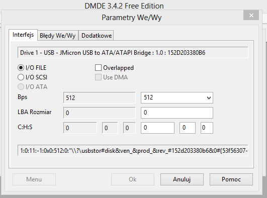

    So briefly:
    I had Win 8, wanted to upload Win 7. Installer went from bootable pendrive, UEFI bios set to "legacy". I deleted the entire C partition with the adjacent parts (system reserved) with the installer. An "unallocated space" was created. When you try to create a new partition (with the installer) from this space, it pops up that it can't be done because the disk has the GPT partition style. I unplugged the disk, connected it to another computer through the bridge (win 8). There - the disk has not been initialized - initialize - it will not work because GPT and too small. (1 TB disk)
    I know, I can format the entire disk to MBR and it won't be a problem, but I want to recover data from the D partition, which is still there (it is visible when installing the system), but I don't have access to it (and the disk).
    So, does anyone have any idea? Maybe in one of the Hirens there is a tool that will come in handy. When loading MiniXP, an error crashes.
    Thanks in advance for your help.

    I am asking for a screen from SMART - to rule out corruption, and from the DMDE program, window partitions current partitioning after selecting the disk.

    I'll drop you off in a minute. I will just add that the AOMEI Partition Assistant program shows the disk capacity: 0.00 kb
    Added after 5 [minutes]:
    DMDE cannot cope - after selecting the disk "incorrect parameters" pop up. Adds a screenshot under the "parameters" button Recovering Data from GPT Partition After Win 7 Installation Attempt: Hirens Tools Usage

    You do not even read the disc, probably the fault of a poor-quality adapter for a dozen or so zlotys. Still don't know what you wanna do? Convert to MBR without data loss? It's that simple. Or maybe something else?

    So first you have to do for the drive to detect properly. Connect directly via SATA or other adapter through which it will be possible to work with this disk. Then show the DMDE screen from the Partitions window view after selecting this disk from physical devices.

    GParted brought this partition back to life, although Win 7 still cannot be installed. I decided to install Win 8 (I think it will go to GPT, huh?), I will download all the data and convert the entire disk to MBR. Such a plan. We'll see what comes out
