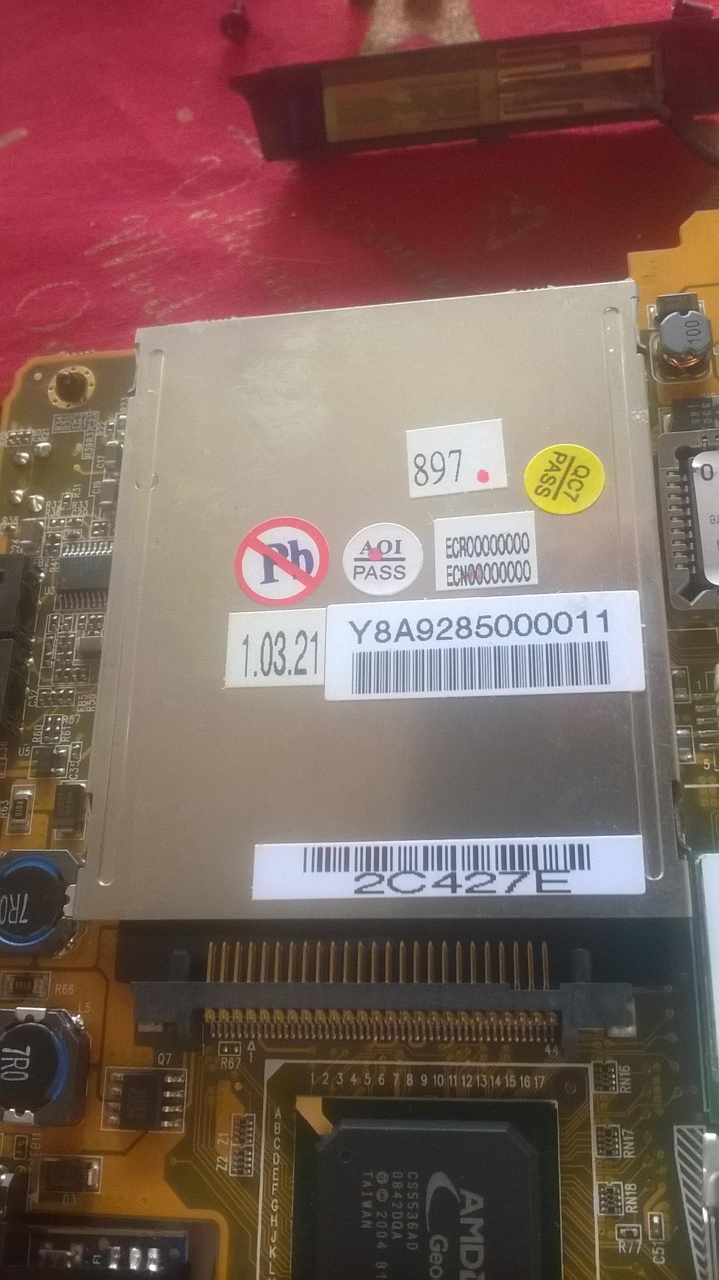

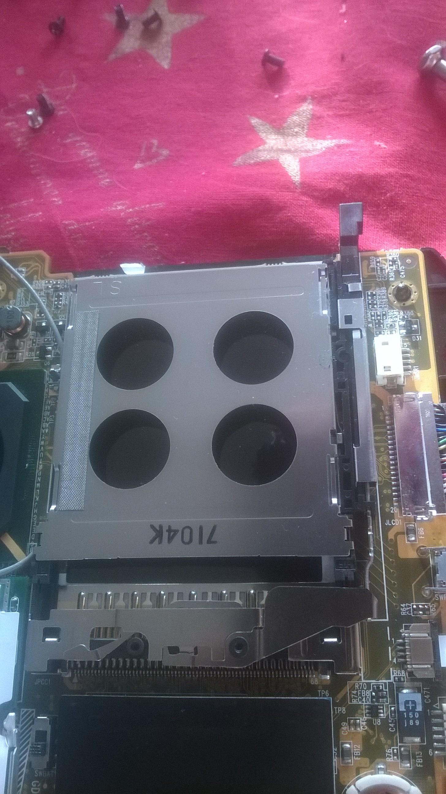

    The slot visible in the photo on the right has a flap for 1 screw that is attached to the cable, and there is a tape on it.
    The slot from the left photo has a button - ejector and hinged flap.
    I suspect that one of them is a CF card, but I have never dealt with it, and I do not want to invest a few zlotys in the dark to check if it suits. And the second slot I have no idea. Someone will help?

    The smaller slot is CF (Compact Flash), the larger one is PCMCIA (also called PC Card).

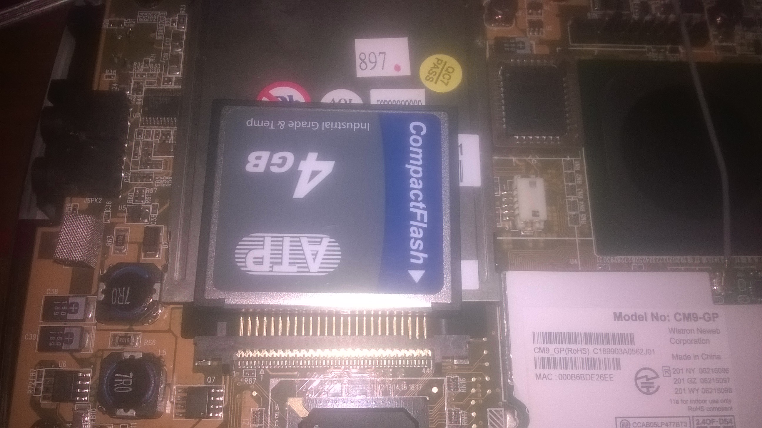

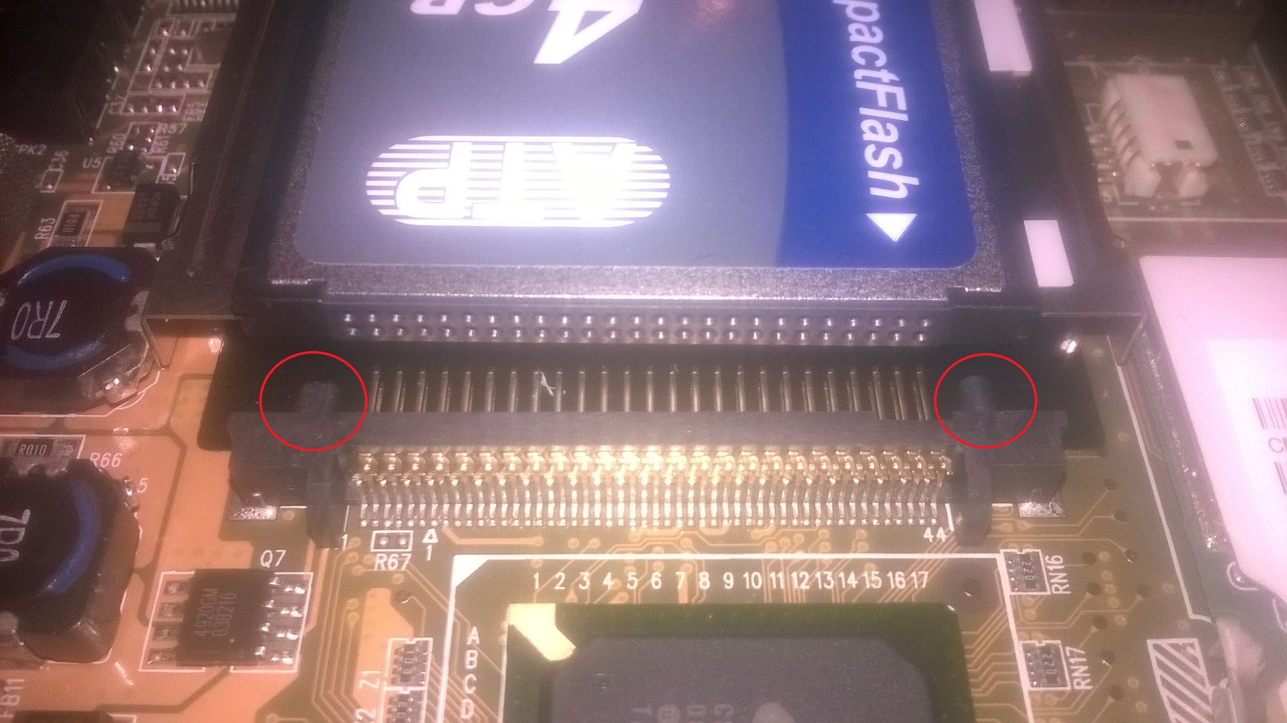

    Unfortunately, I have to go back to the topic. I got a CF card, it doesn't match. Like the number and distribution of pins agrees, but on the sides of the pins are plastic pins that effectively prevent the insertion of the card (pictured in red circles).
    In addition, the card is much, much smaller than this slot.
    AZENTEK DT360- what are the expansion card slots? AZENTEK DT360- what are the expansion card slots?
    We return to the question - what could this nest be for?

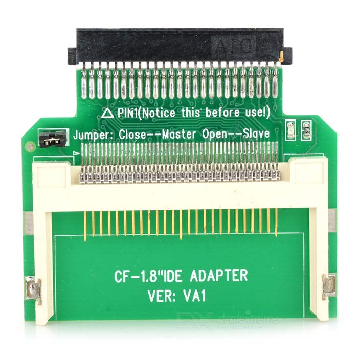

    HDD socket for TOSHIBA 1.8
    If you want to connect a card you must have a CF adapter -> Toshiba 1.8-inch IDE Hard Drive
