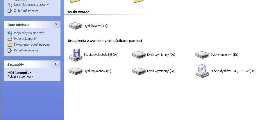

    Hello, I have a computer with Windows Xp sp3. I installed the ICR-Z1 card reader in it. After inserting a 2 GB SD memory card, an AutoPlay window appears on the computer desktop but cannot play the memory card. I put screenshots. What can you do to make your computer see the memory card? I am asking for a quick reply, thank you in advance. Windows XP SP3, ICR-Z1 Card Reader Not Recognizing 2GB SD Memory Card: AutoPlay Issue Windows XP SP3, ICR-Z1 Card Reader Not Recognizing 2GB SD Memory Card: AutoPlay Issue Windows XP SP3, ICR-Z1 Card Reader Not Recognizing 2GB SD Memory Card: AutoPlay Issue

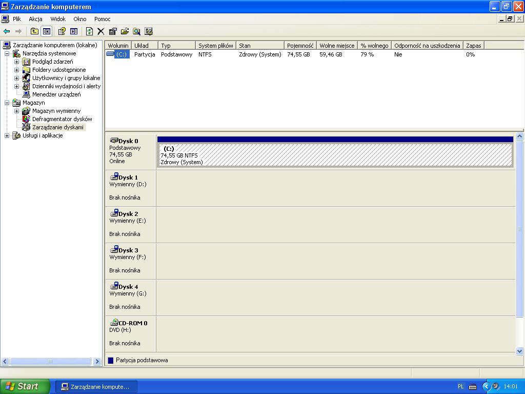

    Show disk management tab.
    Right click on My Computer -> manage -> disk management
  • #3 16449870
    Zbychuelektronik
    Posts: 21

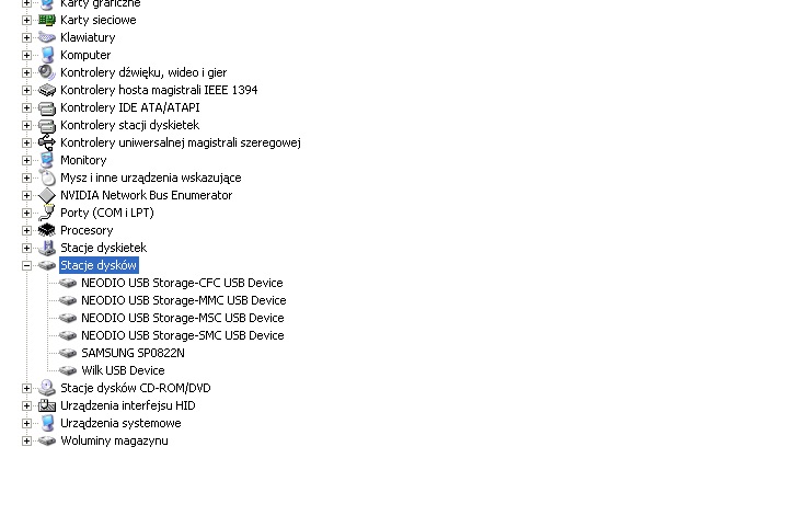

    Show hidden devices in the Device Manager in the view menu.
  • #5 16450179
    Zbychuelektronik
    Posts: 21
    I showed hidden devices. I was still thinking about the reader and it turned out that the pin 9 of the sd card reader was bent. I corrected it and measured it with a meter or connections, but it did nothing. Windows XP SP3, ICR-Z1 Card Reader Not Recognizing 2GB SD Memory Card: AutoPlay Issue
  • #6 16450284
    kindlar
    Level 42  
    Posts: 7901
    Help: 919
    Rate: 1624
    Click "view" - show hidden.
  • #7 16450327
    Zbychuelektronik
    Posts: 21
    I clicked, there are only drivers incompatible with plug play
