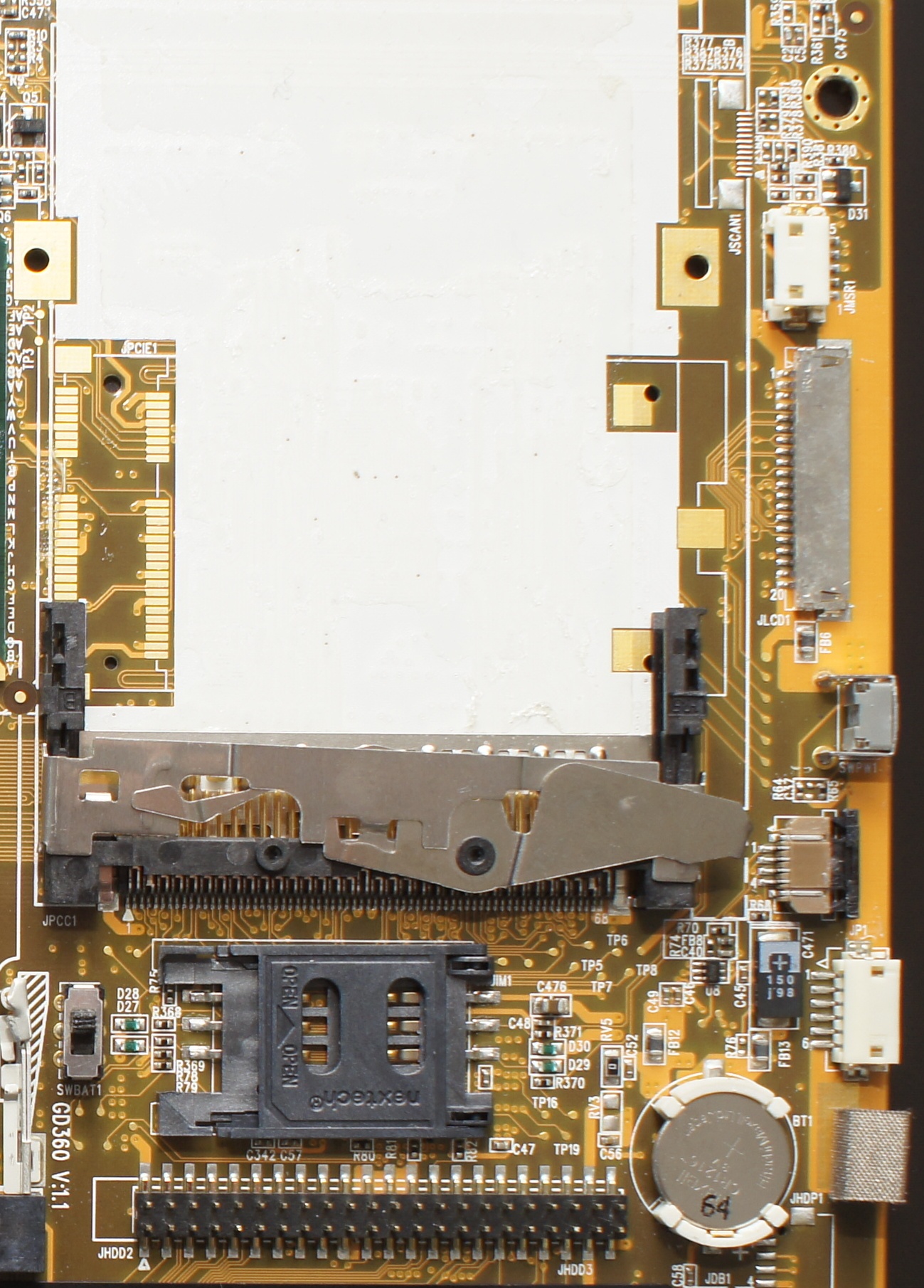

    The tablet is powered by a DC12V adapter. 3.5A
    The tablet has two slots:
    1) HDD 1.8 inch TOSHIBA
    2) PCMCIA (PC Card)
    It also has a 44PIN slot with an SSD with a 1GB system
    on Aliexpres there are disks " Zheino 44pin ide / pata dom slc ssd horizontal + socket "up to 64GB but I don't know if this disc supports that much.
    Power Supply and Disk Space Requirements for AZENTEK DT360 Tablet for Volkswagen Diagnosis

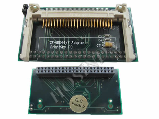

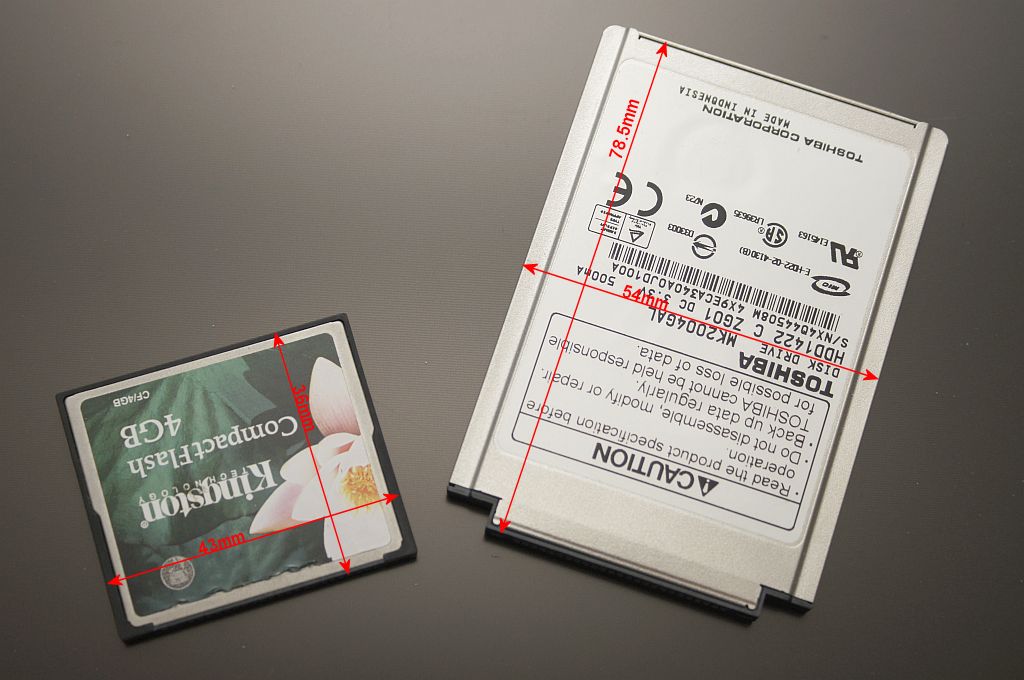

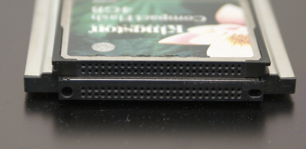

    This CF slot is not a regular CF slot, it is a HDD1422 1.8-inch IDE Hard Drive TOSHIBA slot
    Power Supply and Disk Space Requirements for AZENTEK DT360 Tablet for Volkswagen Diagnosis Power Supply and Disk Space Requirements for AZENTEK DT360 Tablet for Volkswagen Diagnosis
    But you can buy a CF to Toshiba 1.8-inch IDE Hard Drive adapter
    And it should work.

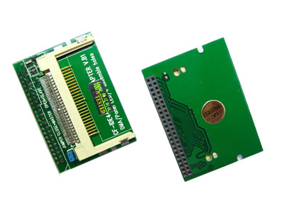

    Or other horizontal angle adapters or what to call them:
    Right-angle Laptop 44-Pin Female IDE To CF Card Adapter
    SLCI4404

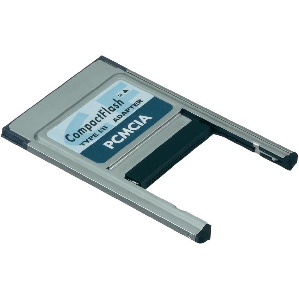

    Alternatively, connect the Compact Flash Type I and II adapter to the aforementioned second PCMCIA socket

    k_mac wrote:
    Hmmm, i.e. you can't use the CF slot even with a Microdrive card?
    Theoretically, having the CF adapter mentioned above is a Toshiba 1.8-inch IDE Hard Drive only I don't have one and I won't confirm that it works.

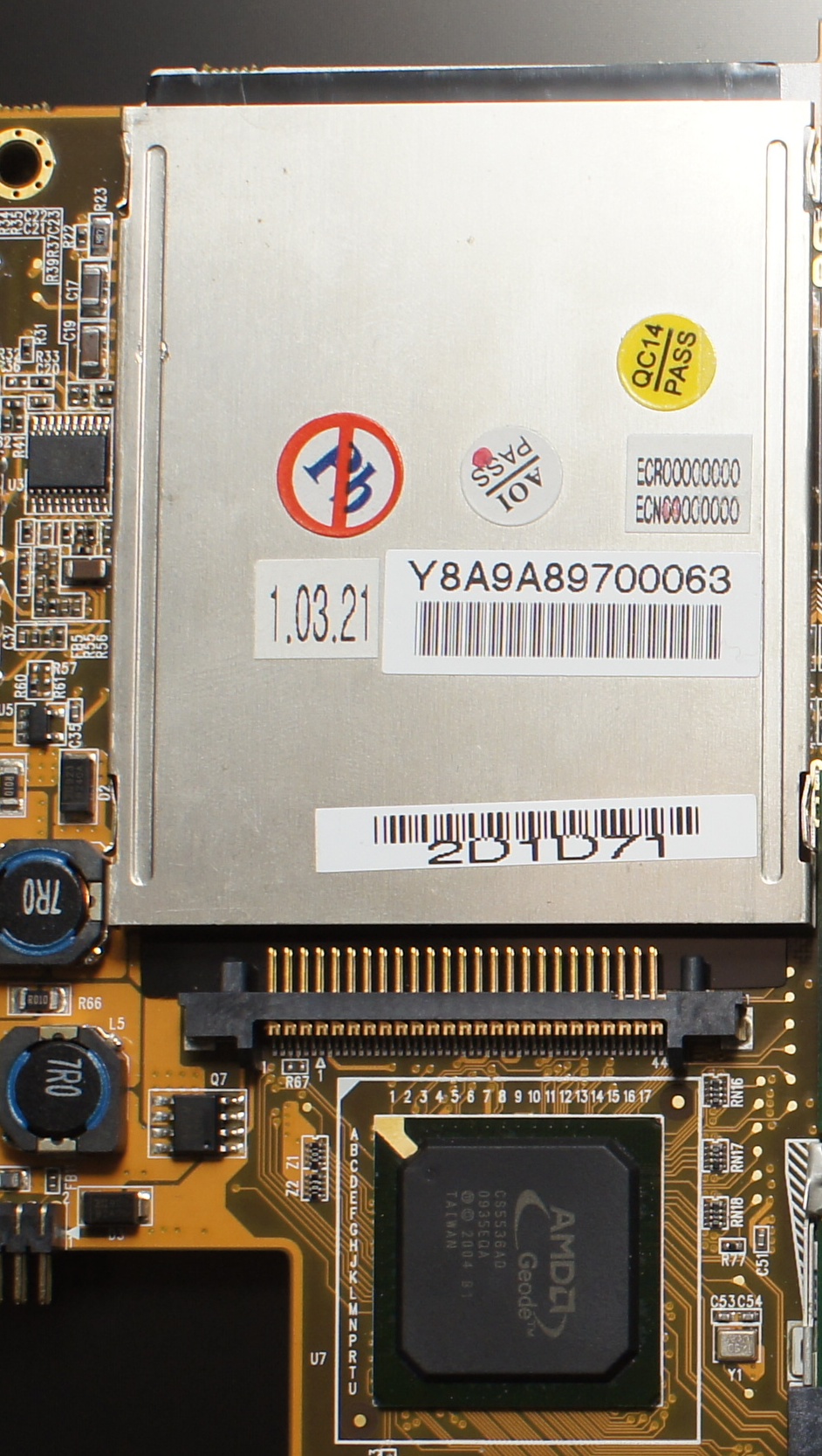

    I got batteries from China yesterday and after some time I would like to have more capacity. In addition, I will replace the fluorescent lamp with LED in backlight to further relieve the equipment. At the moment, the plan is to make it a GPS navigation Tablet has bluetooth so it should handle the connection with an external GPS from NOKIA LD-3W
    Karaczan wrote:
    If I were you, I would let go of this shit ...
    Maybe szajs or maybe not the question of approach and self-denial to play can be.
    And what is interesting from what I see is the tablet can be expanded and has an advanced and expanded BIOS.
    By getting rid of the PCMCIA socket you can solder from what I see the PCIEXPres socket plus a SIM card slot by connecting a WWAN modem we have a mobile net. However, by getting rid of the CF 1.8-inch IDE slot, there is room for a SATA slot for disks. In the model DT312 above mentioned sockets are present so who knows maybe after soldering we would be able to use them.
    Power Supply and Disk Space Requirements for AZENTEK DT360 Tablet for Volkswagen Diagnosis Power Supply and Disk Space Requirements for AZENTEK DT360 Tablet for Volkswagen Diagnosis Power Supply and Disk Space Requirements for AZENTEK DT360 Tablet for Volkswagen Diagnosis Photo source: Allegro
