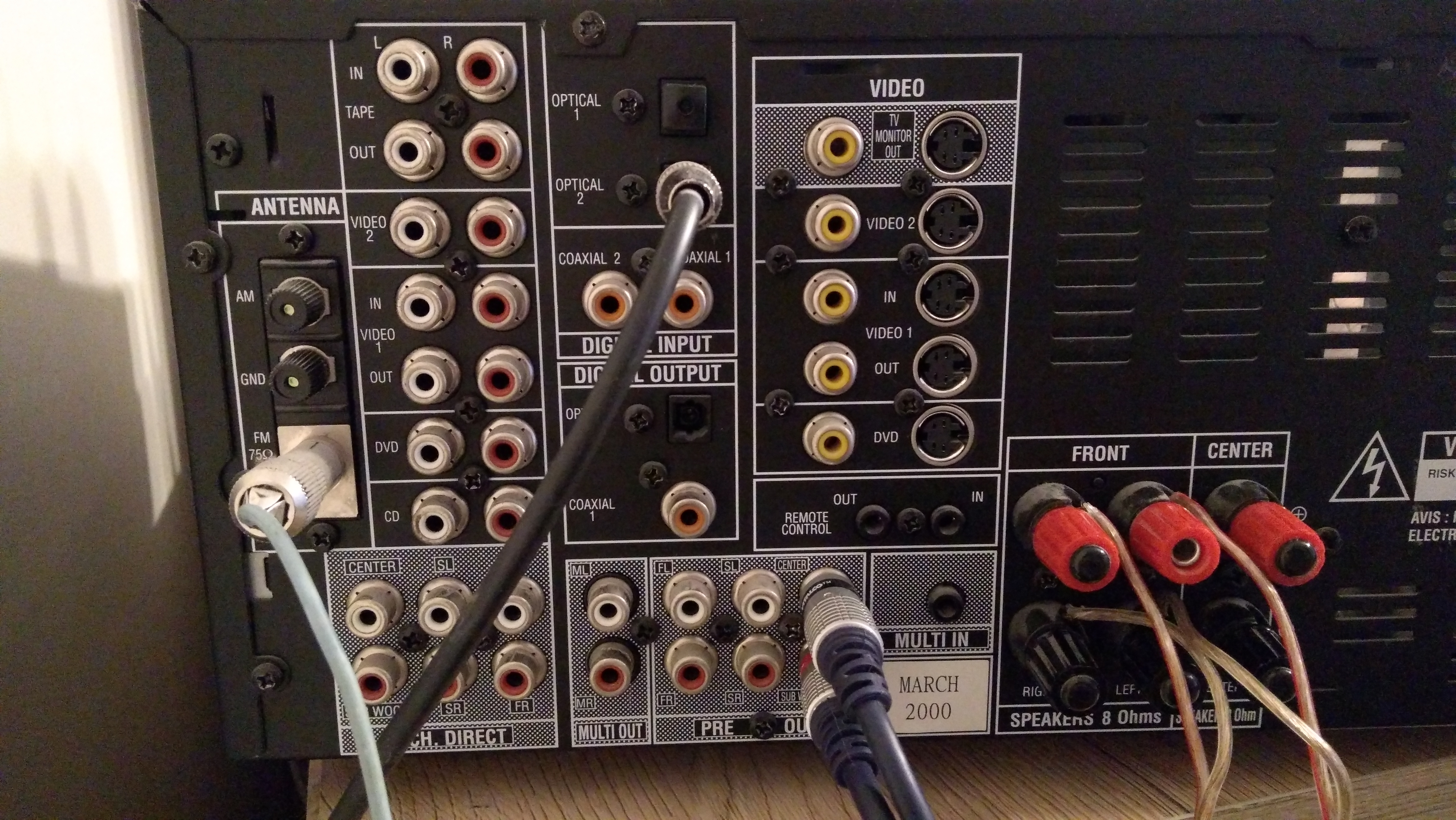

    The speakers are connected directly to the receiver under FRONT a
    Subwoofer with an RCA cable (Chinch) from LINE IN to PRE OUT SUBWOOFER on the receiver

    Thank you buddy for your earlier reply. I connected the wires as you wrote and everything worked, but only on the radio. After connecting the TV to the optical cable under optical 2 and turning this setting on, only the speakers work on the receiver. Should I connect the subwoofer differently after such a TV connection or combine it with the settings of the receiver although I honestly admit I have no ideas.
    https://obrazki.elektroda.pl/9155276600_1546700785.jpg

    The outputs are always the same, you have to combine with the settings, speaker mode or how it is with you.

    Exactly. The issue of settings on the receiver

    Thank you guys, as you wrote, it was a matter of setting up the receiver, the equipment plays great ?
