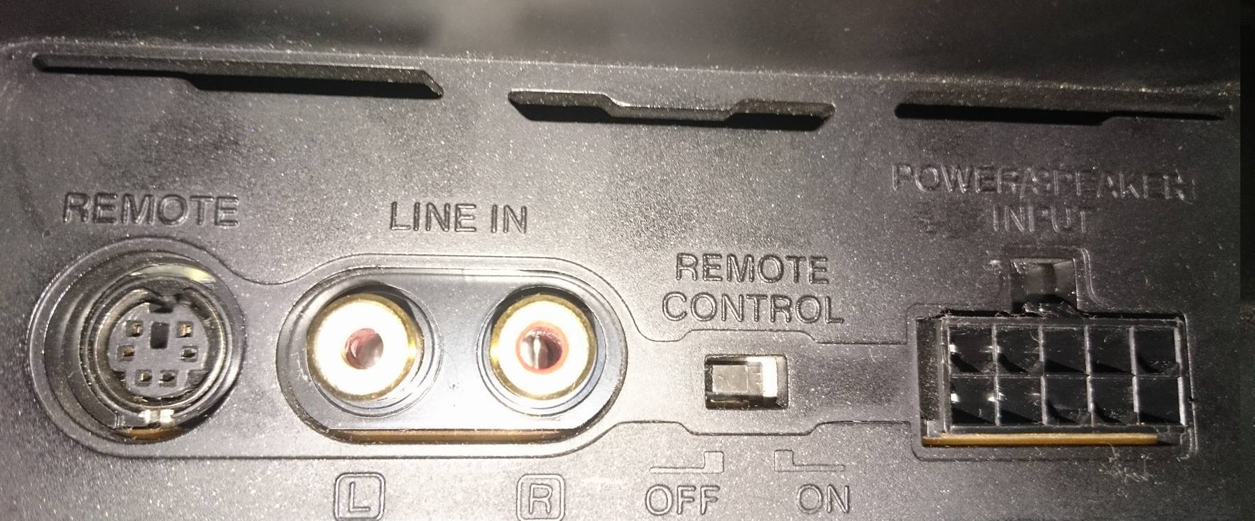

    Hello. I received an occasional subwoofer of low power KENWOOD KSC-WA62RC . From the beginning I will say - I am green in this topic, hence I am writing here, and I am not trying to search for knowledge myself. From what I was able to find out, this subwoofer has a built-in amplifier (2x30W). I would like to ask how to connect it to the car radio? If the subwoofer has an amplifier, will it only work when the RCA cables are connected, or do I also need to connect the power supply to it from the battery? Besides, I'm not sure if my radio (SONY cdx-l280 4x45w) is suitable for this. Attached is a photo of the inputs/outputs of the subwoofer. I am hoping for a detailed answer. Thank you in advance.

    Of course, no amplifier is perpetual motion and needs power. The RCA output from the radio is a low-amplitude and low-current signal, and the speakers need power first of all. Hence, the amplifier without battery power will not play :)
    Here http://inform3.kenwoodusa.com/manuals/KSCWA62RC.pdf you have on page number 5 beautifully described how to combine and you will learn what is five ;)

    This clipping you posted shows only the connection of the signal.
    Go back to the previous post and read until you understand why the amplifier needs power :)
