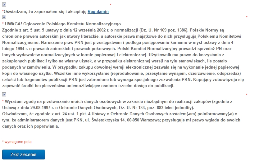

    Exactly :
    WARNING! Announcement of the Polish Committee for Standardization
    In accordance with art. 5 paragraph 5 of the Act of September 12, 2002 on standardization ( Dz. Of Laws No. 169, item 1386 ) Polish Standards they are protected by copyright as literary works, and the copyright to them is vested in the Polish Committee for Standardization.
    Violation of PKN's rights is a criminal offense and is subject to criminal proceedings under the Act of 4 February 1994 on Copyright and Related Rights.
    The Polish Committee for Standardization sells PN and other standardization publications in paper and electronic form.
    The user has the right to use the purchased publications only for his own use, and in the case of the electronic version for as many positions as specified in the order.
    If you purchase any electronic version, you will be allowed to make one paper copy for your own use.
    Any other use (reproduction, transmission, rental, lease, resale) of all or part of PKN's publications is prohibited or requires special permission from PKN.
    The buyer undertakes to provide security measures that prevent third parties from accessing the publication.
