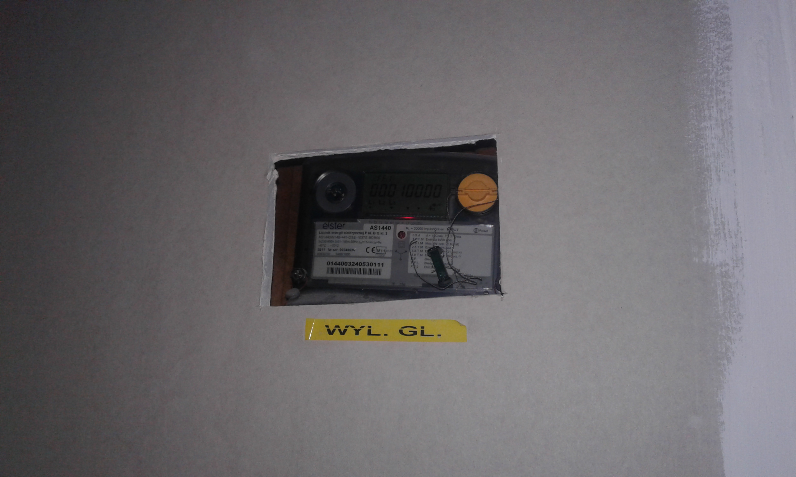

  • #8 18201509
    Wojtasekowski
    Posts: 82
    retrofood then I have a different question. I can give the distribution box itself in the partition wall because it will fit, but what about the meter? I have a 30 cm door recess and it would be fine to stuff it there, but is it possible?
    In the photo I marked what I mean.

  • #18 18203479
    Łukasz-O
    Admin of electroenergetics
    Posts: 21789
    Help: 654
    Rate: 4290
    maurycy123 wrote:
    You're right. But still someone allows it to be used.
    When buildings are made of furniture, nobody is there for a long time.
    bartekfigura wrote:
    I have also cut GK boards several times, completely destroying a piece of a nice wall ...
    Unfortunately, I also meet:
    Regulations for Installing Electrical Switchboard in Cabinet Recess with Sliding Doors Regulations for Installing Electrical Switchboard in Cabinet Recess with Sliding Doors

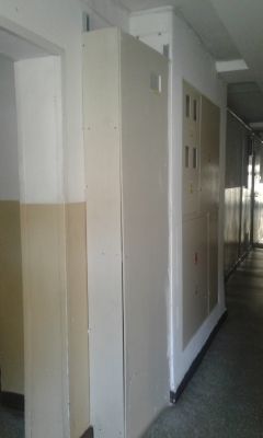

  • #26 18203838
    Łukasz-O
    Posts: 21789
    Help: 654
    Rate: 4290
    maurycy123 wrote:
    So, in your opinion, I should install switchboards near the floor?
    No, you can go a little higher:
