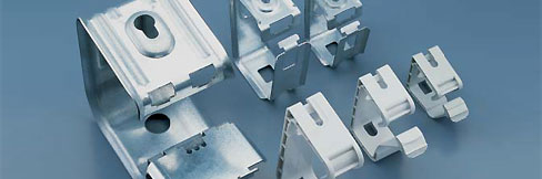

    I am waiting for a complete renovation of the 50 sqm apartment. I am trying to replace the entire electrical installation. In the whole apartment, I will lower the ceiling by about 50 cm. Are there any contraindications for cables to sockets and lighting to run in the ceiling? I would attach the cables to the CURRENT ceiling, i.e. they would NOT be on the boards. I would save mainly on forging in the walls, I would simply lead cables to the sockets directly from the ceiling.

    Isn't it better to put it in the walls, not on the ceiling?
    Unless you are going to save, and lead the wires "shortcuts"
    EDIT - It was supposed to be on the walls, not the walls.

    After all, I am not writing about forging, but about placing the wires on, for example, spacing brackets on the wall, ABOVE the planned suspended ceiling.

    You can also install troughs (or sections of troughs) on the ceiling and lead the cables from them where the accessories will be installed.

    morrph wrote:
    I am waiting for a complete renovation of the 50 sqm apartment. I am trying to replace the entire electrical installation. In the whole apartment, I will lower the ceiling by about 50 cm .
    Regards.
    Everything about it. We are not talking about a few centimeters, but about half a meter :D
    PS. In companies, behemoths, etc., perforated troughs are mounted on the walls above the suspended ceiling, and the cables are placed there.
    It is an unnecessary expense for you.

    A colleague elpapiotr writes well, if we have enough space, the cables can be mounted on the wall between the existing and suspended ceilings .. ;)
    The passes then become redundant.

    Why don't you use the troughs? - attach them to the wall and after the trouble.
  • #25 14129108
    TWK
    Electrician specialist
    Posts: 2326
    Help: 220
    Rate: 510
    What for? How much is a meter of a trough and how many 2 or 4 handles shown by elpapiotr? How much time is the trough assembled and how much time such holders?

    This can be done even faster than @elpapiotr proposes :)
    Cable Routing in 50 sqm Apartment: Replacing Electrical Installation with Suspended Ceiling
    I especially recommend the plastic ones, they are great to use even when working alone. You have to drill, but you can insert and remove the wires many times.
