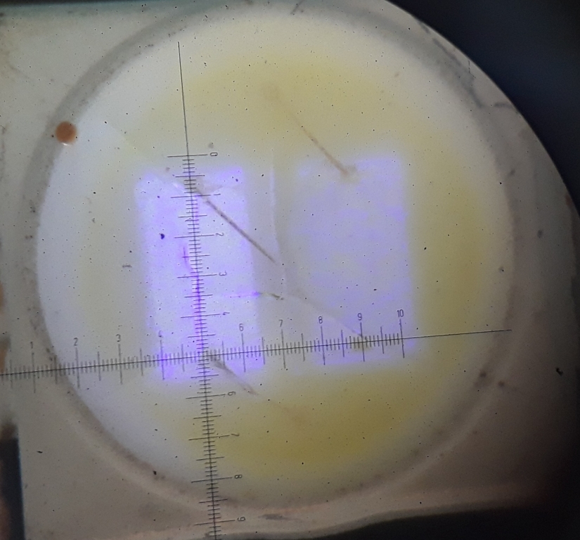

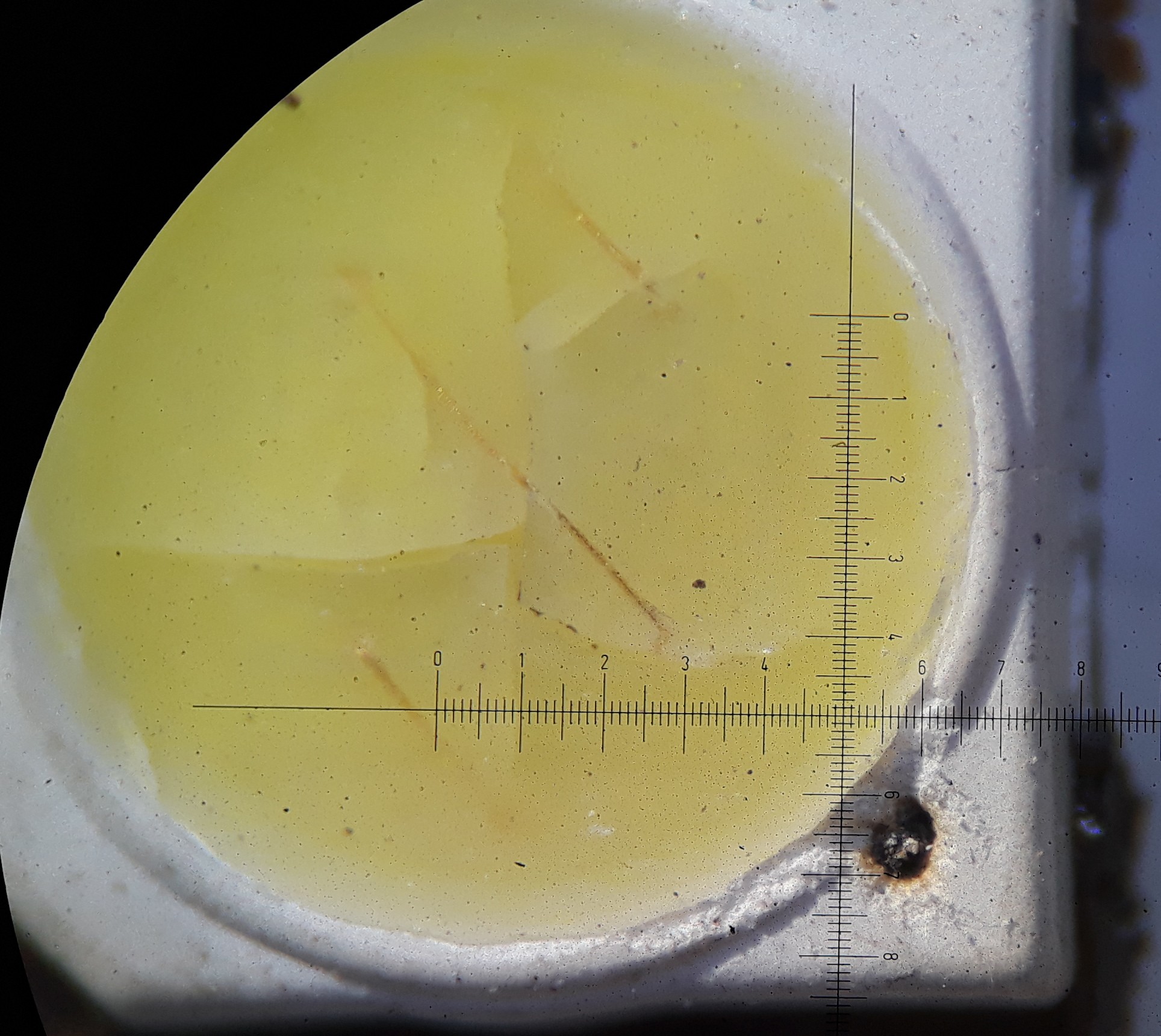

  • #19 16382796
    Kristek
    Posts: 288
    Help: 8
    Rate: 40
    Hello!
    And I would suggest to exchange all diodes (or new slats) and from one bin - we have peace of mind for the next few years. After exchanging only a few pieces, you may be surprised to watch the white background on such a TV ... besides, the greater the probability that the ones not replaced - they will be damaged because they are already "worn" and the complaint is ready ...
    See how they look at the magnification:
    LG 32LB561B Innotek DRT 3.0 - LED Diodes Parameters, Type_A vs Type_B Differences, & Purchase Links
    The encapsulator is all cracked and so is in all backlite diodes.
    In the above picture there was a break - you can see why - in the bottom right corner let go of the link - until it snatched a piece of housing.
    Below - as the title of the curiosity, photo of a glowing chip, you can see two segments of 1W each:
    And what are the differences between "A" and "B"? According to me, only technological holes - red circles on the photo below (and there is also a thesis that with the quality of diodes - I will examine whether the diodes from versions A and B have the same parameters ...
    Below the parameters at 20mA, 100mA, 200mA currents. I took off for the three "used" diodes 3535:
    I did not have a catalog notice so I started with 20mA.
