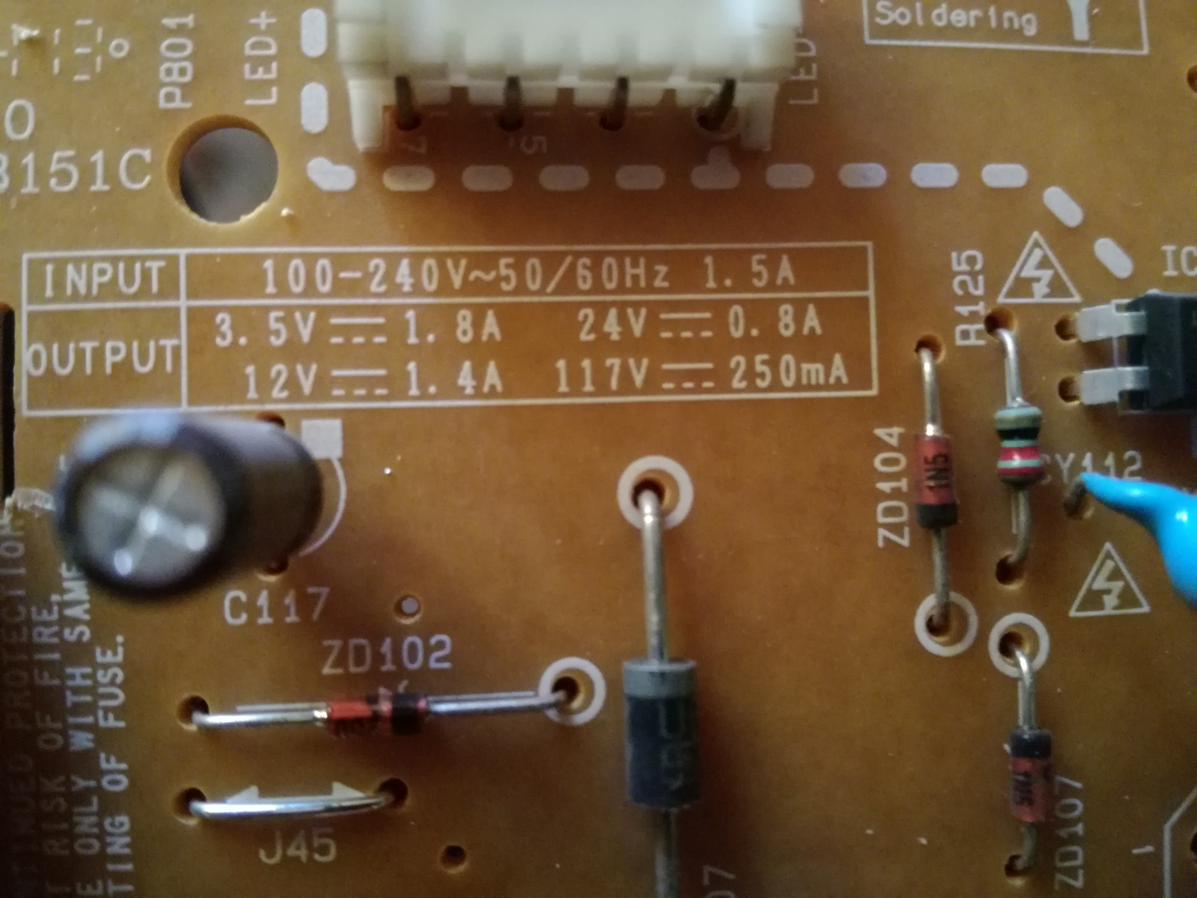

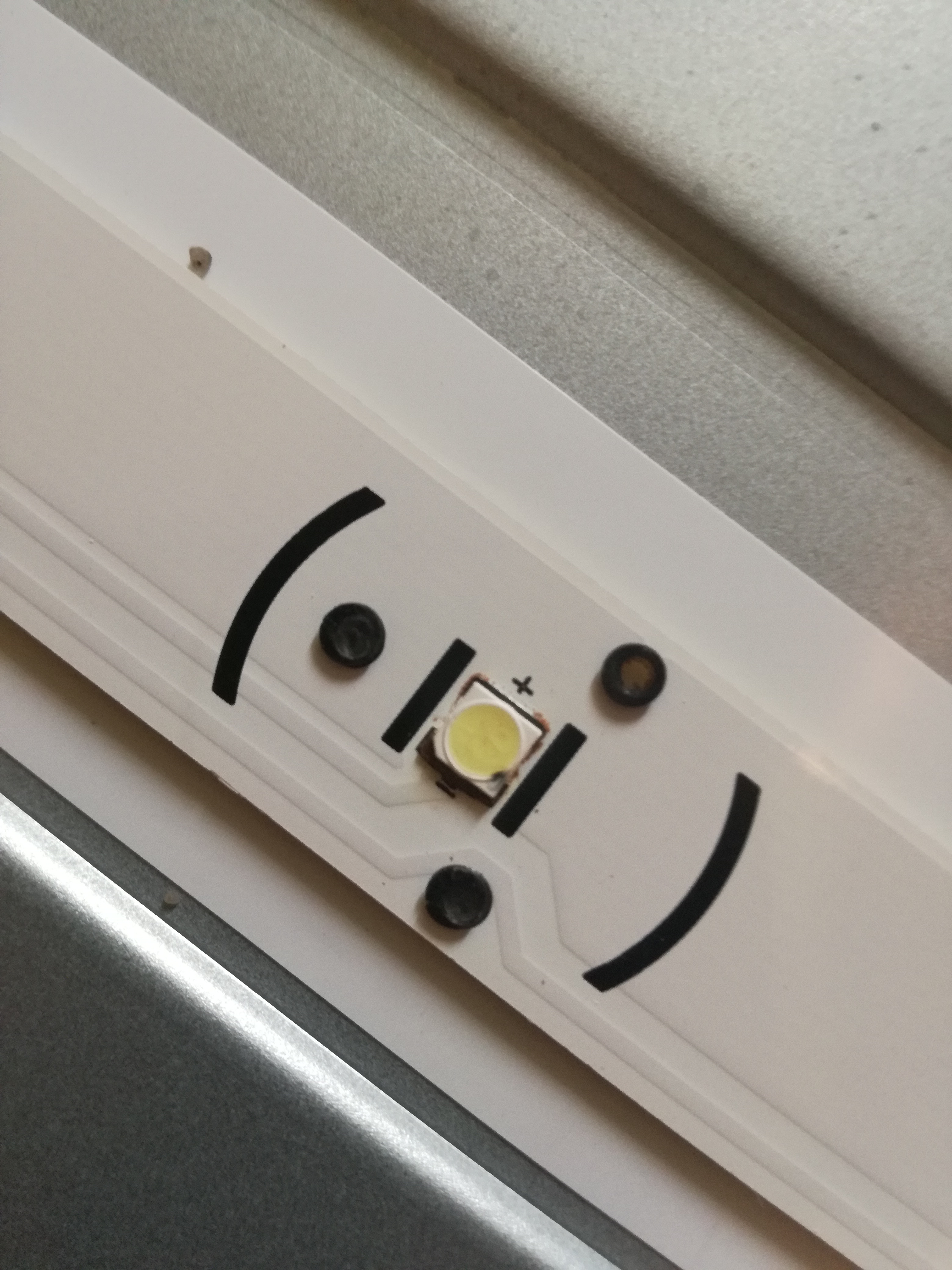

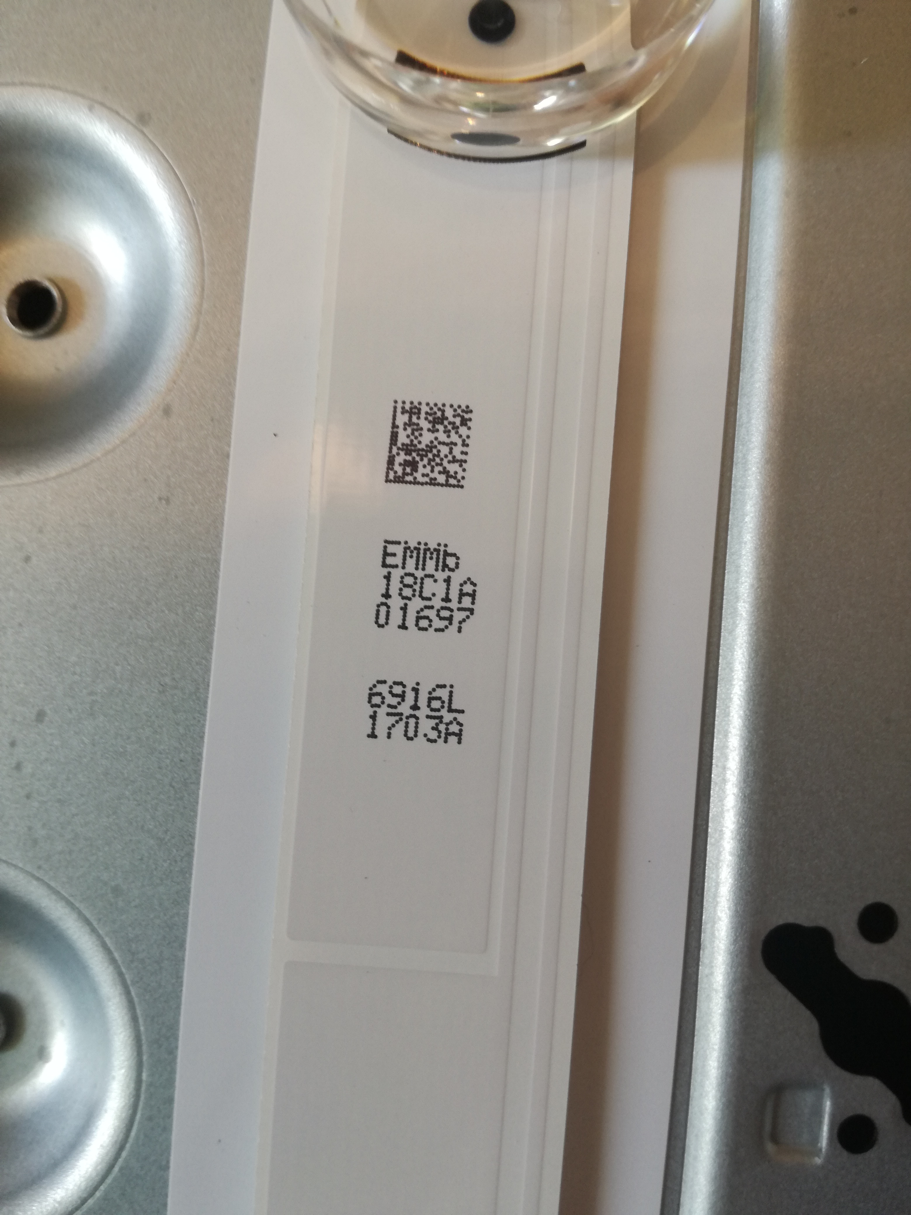

    Hello, I got the TV LG 32LB5610 for the proverbial "half a liter", in which the backlight ended a week ago, and after dismantling the matrix, I found a damaged diode, which is probably the culprit of the entire defect. The LEDs are located on 3 strips of 6 pieces and are connected in series. The question is: what diodes should be chosen for replacement? Should you replace all of them at once or only the damaged one?
    I add photos of the power supply and the damaged diode.

    And you don't know basic maths? ;) You can use an online calculator, since simple division is such a problem. ;)
    Replace one. As far as you can. And so soon there will be a repeat of the entertainment.
    Or wait for new slats. They will probably appear sometime. It's just that after simple assembly, they won't last that long. ;)

    A colleague will replace it with a hot air :) Why shouldn't they last long?
    Will the LG 3535 6V - 2W diodes (with alledrogo) be good?
