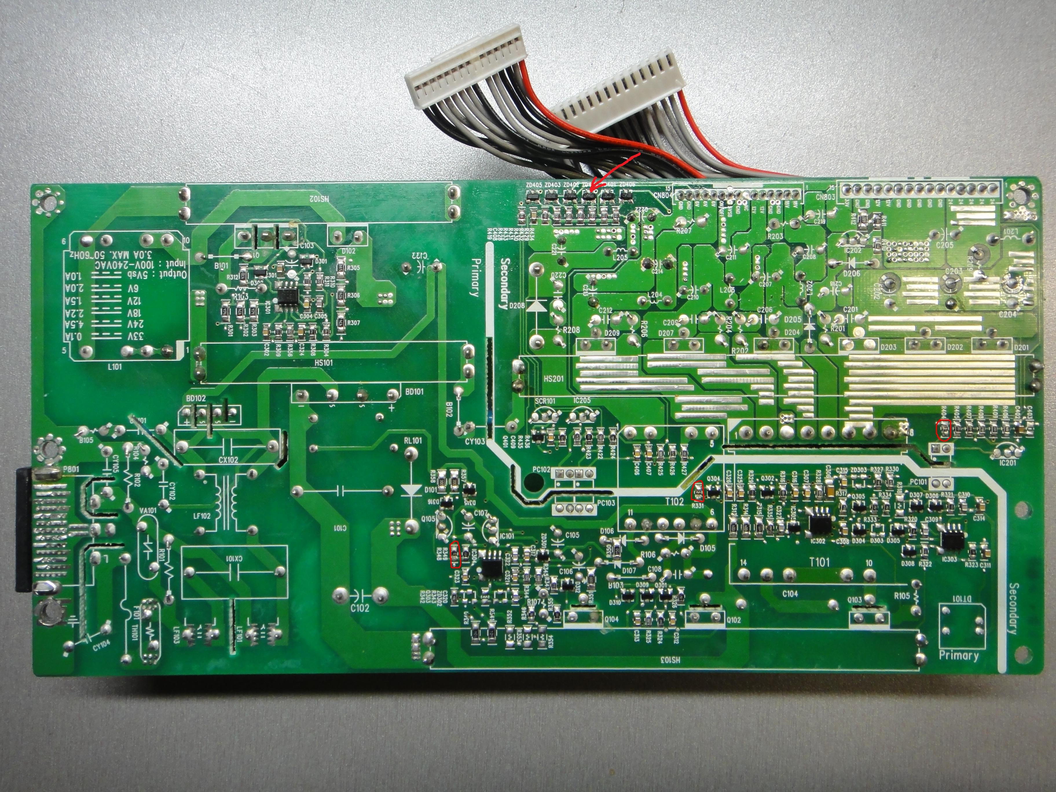

    I spoiled my power for YP2632T. Destroyed znenerové diodes that ZD402 and ZD404 can not be read. Can anyone tell me what the diodes are?
    Thank you

    ZD401 correspond à : ZD401 0DR050008AA SD05.TC R/TP SEMTECH SOD323.
    ZD402 il est inscrit "Y3"
    Look for Link_ parts view 32LX2R
    parts ZD308

    Well look at applications FAN7601. (IC302 / 304) * FAN7601, LAF0001)
    - you can pre-draw this part of the layout on a piece of paper + pencil
    to see what pin.IC304 can it be? Zener diode connected

    I exchanged the IC302. ZD404 is burned only. I apologize for my Polish, I Slovak.

    Read on the Forum about Lgp32-Atn-Power Supply Yuyang Telecom.

    The correct hint is "analyze the LGP32 ATN scheme and compare it with your motherboard. Maybe you can deduce what parameters the diode should have."

    I preanalizoval scheme Lgp32-Atn-Power Supply, but I am not mudra.
    It could probably be a Zener diode to 6V, but I'm not sure.

    Then draw us where this LED is on. Just.
  • #15 14798580
    aadam07
    Posts: 6
    At the top is marked with an arrow ZD404.

    We know where it is on the record!
    We want to know where it is in the electronic system.
    Please make a freehand drawing (diagram) of this piece of power supply.
    If you can not think of a model based on the LGP32 scheme, then maybe we will succeed.
    Or maybe there is no similar solution there and you have to move your head. ;)
    So a pencil, a card and to work. Exactly - where the cathode, where the anode plus all the elements associated with it. If it has any connection to the transistor, then what does this transistor do next.

    The diode is Y13, essentially 36V.
