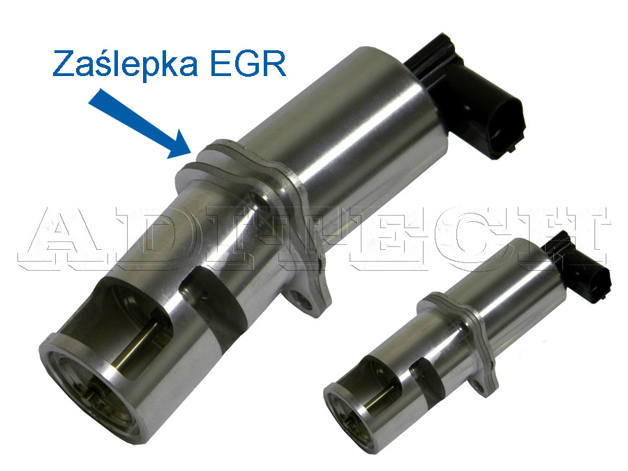

    Hello!!!
    I wanted to know how to blind egr in my lagoon II 1.9 dci 120 km 2002, because the pipe from this egr is round and attached to the collector on some band, so I do not put any end caps there
    I'll just add that the EGR is electronically controlled and I do not know what to do to make everything right.
    I thought to remove the egr and some of the collector to throw it out, and there, push some empty tube, and screw the other part back to the collector
    On the Allegro at this link http://allegro.pl/532-zaslepka-egr-renault-1-9-dci-opel-1-9-dti-kpl-i4885736840.html I found a blank I just do not know if I should put it in only between 2 parts of egr and everything will be ok ???

    You have to unclip the tube from the collector to the EGR, insert a cap there, they are in the shape of a bowl. Egr you leave hooked. With the EDC15C2 controller there will be no emergency mode, only an error as you read the computer. You can additionally work the driver, but it works without it.
    Where to buy such a plug and what it means to work the driver because I do not really understand

    And what about this blindness because I am looking and looking and I did not find such a blind, and what I gave in the link is in the description that it fits my car
    Added after 6 [minutes]:
    Laguna II 1.9Dci 120HP: Blinding EGR Valve - Electronic Control, Round Pipe, & Allegro Kit
    and what if I use this plug as in the picture, the producer says in the assembly instructions like this:
    General assembly rules
    The spot of blindness is shown in the picture above. Do not forget to seal the connection site with new gaskets or high-temperature silicone. Then we start the engine and check that there are no blows next to the plug. If everything is ok, we can enjoy blinded EGR.
