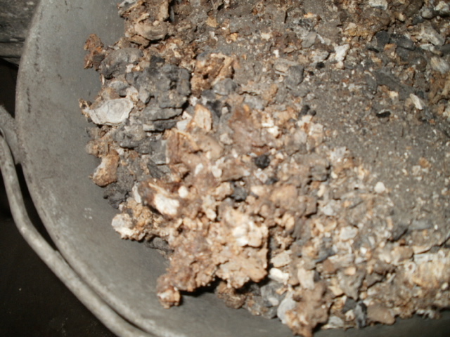

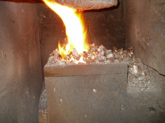

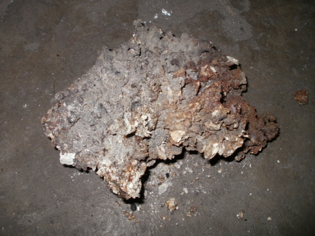

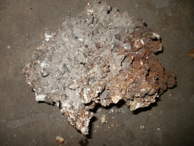

    The second year I have a boiler with a screw feeder for coal. This year, there are so large sinters that after one day of burning, the sinter reaches from the bottom of the hearth to the deflector and it is very difficult to feed peas. Maybe someone knows what the reason is and what parameters are best to control so that the sinter is not. Regards Jacek

    The reason is eco-pea coal not to bake.

    Thank you for your response. I also thought so a bit because a year ago there was no problem. Can you write something closer about what is wrong with this fuel?

    Is there any way to minimize it at least?
    Buy eco-pea coal of the lower type, e.g. 32 (i.e. low calorie) and mix with what you have - at least the sinters will be smaller and may allow the feeder to work.
  • #7 16223550
    malez4
    Posts: 549
    Help: 48
    Rate: 375
    Air. Too much air - more sintered.
