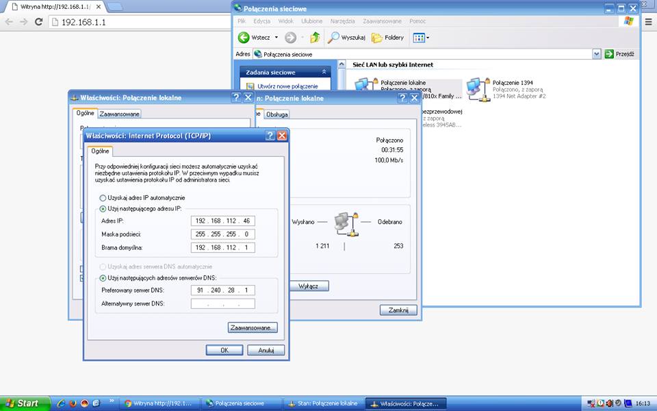

    Hello, I have a problem with the router configuration.
    I warn you that I am not very familiar with this topic and maybe I will ask banal questions.
    I have a Flashnet network - it is a radio network (no login required) and the settings are as in the attachment
    I have tried in different ways ...
    When I open the router's page, that is "192.168.1.1" - if I remember correctly, it does not enter at this ip address that I have.
    in turn, when I change my ip address, the website enters me - I search for wi fi but after connecting there is no internet anyway ... HELP ME

    How are the cables from the supplier to the router plugged in?
    For LAN or WAN port?
    Do you have any antenna / receiver outside the building? Where is it connected to which port on the router?
    Your gate is
    192.168.112.1 - it may be an address, but not necessarily, depends on settings, connection

    I have a cable from the supplier plugged into this single socket in the routeze, not lan, and from lan I plugged into the computer, the worst thing is that with the ip that is in the picture, I can not enter the router configuration page and if I change the ip, there is no internet

    When connecting a computer with a totolink, you should have an automatic address set and the router will assign you an address.

    I do not get it anymore .. when I set the ip from the machine, there is no net further .. the router itself is enough or do I have to eat something in addition to this?

    In sequence
    1. You set up automatically on the network card in your computer
    2. You log in to the totolink configuration page
    3. You set the IP addressing you had on the computer in the WAN configuration of the totolink.
    AD2. the configuration page address is the same as you will see for the gateway address in ipconfig.
  • #7 16229199
    twaist
    Thank you very much it worked :)
