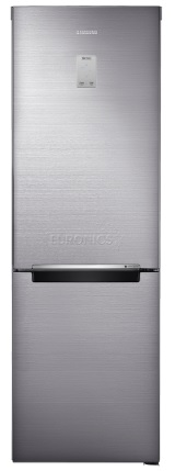

    I would like to move the door of my fridge-freezer in such a way that the door of the refrigerator compartment opens to the left and the freezer door to the right.
    Can any of the dear forum members tell me whether there is such a possibility and how to do it, if any.
    Thank you for all the tips.
    Greetings,
    Adam.

    You had to want to do some "hinged" combination. Because with a "normal" spacer it is not a problem, except that the middle hinge is a common hinge for the lower and upper doors and you would have to buy a second one and both middle hinges should be modified somehow. The second thing is whether with such a hinge assembly just the middle ones will not interfere with closing the door.
    #3 16224475
    mrhari
    Posts: 7981
    Help: 835
    Rate: 3239
    Theoretically, this is possible, assuming you have an additional top hinge. (Should be included)
    You will need an additional hinge DA97-13564A and screws fixing it.
    https://north.pl/karta/zawias-drzwi--srodkowy--do-lodowki-samsung-da9713564a,706-AK-0518.html
    It is possible that after cutting one roller, the idea is right.

    Thank you for the hints :-)
    With a little free time I will get on the spacer, before buying an additional middle hinge.
