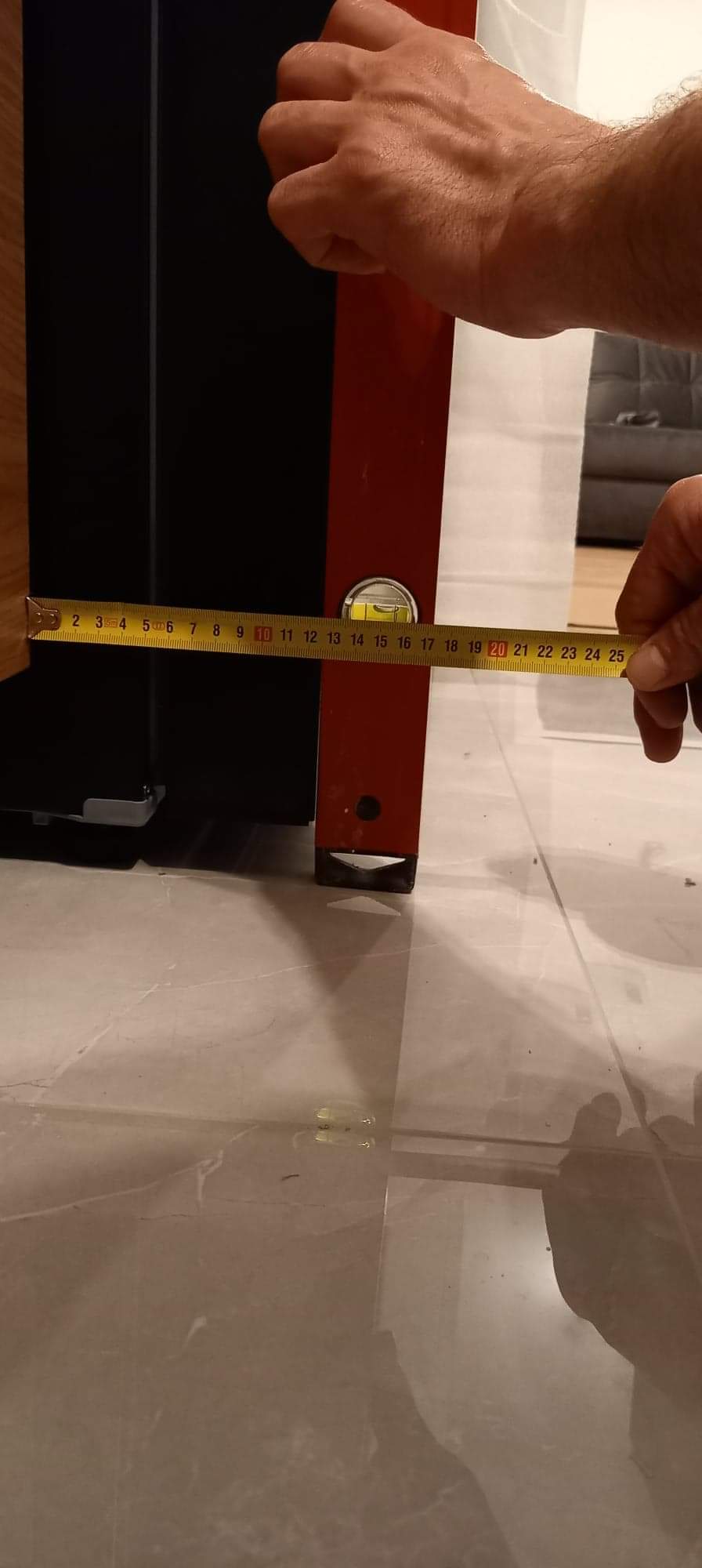

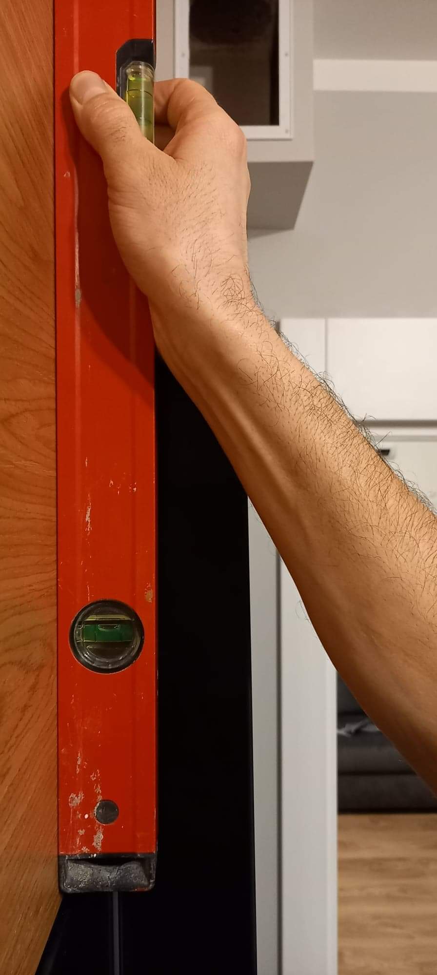

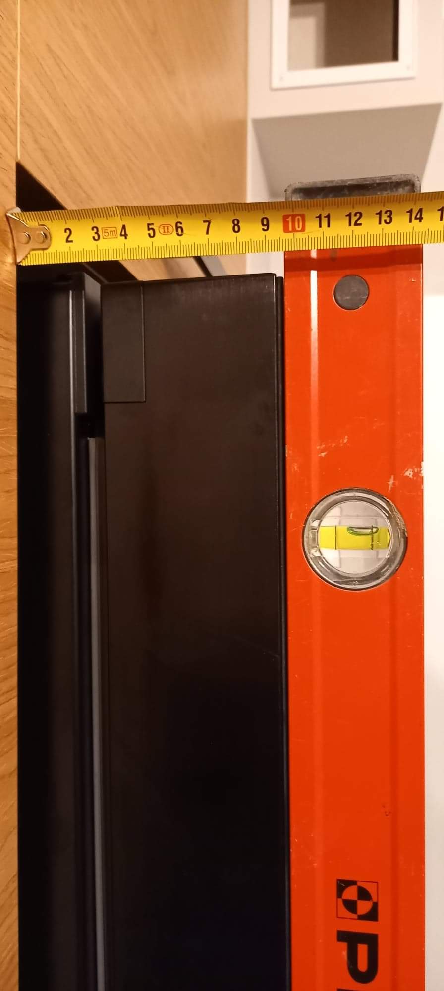

    #14 19160425
    Krzysiek0408
    Posts: 8
    And I bought a Samsung RB37K63602C fridge-freezer (black glass fronts). The instruction states that you should level it by slightly tilting it backwards. For me it is slightly a few mm, the difference for the eye is acceptable even with the construction, as in my case.
    The device has 2 wheels on the back and 2 adjustable feet on the front. After screwing the legs all the way in, it turned out that the refrigerator is tilted from the vertical by 30mm over a distance of 2 meters (this is the height) to the back. As the device is built-in, the difference in tilt can be seen very clearly. By turning the front feet, I can only increase the rear tilt. I wrote to Samsung enclosing pictures, they say there is an ok- quote "backward tilt should be 3 to 5 degrees" but the manual does not give these values, it only says a slight deviation.
    I also spoke to the home appliance installer and he confirmed my fears that there was something wrong. The installer mounts the refrigerators by applying a spirit level and the eye of the spirit level slightly tilted back as I wanted to do it. I have installed several refrigerators in my life and never had such a problem.
    I asked Samsung to analyze the case by the technical department and not by the customer service department or the arrival of a service technician under the warranty. I am waiting for feedback full of nerves. Pictures of what it looks like in the attachments
    Kisses

    To this "show" of the tilt in the photos, I would also like to see how the furniture stands according to which it is measured ...
    Because it is not known whether the cupboard you measure is perfectly vertical, or whether it is an appropriate "template" ...
    Or maybe it is slightly tilted forward? :evil:

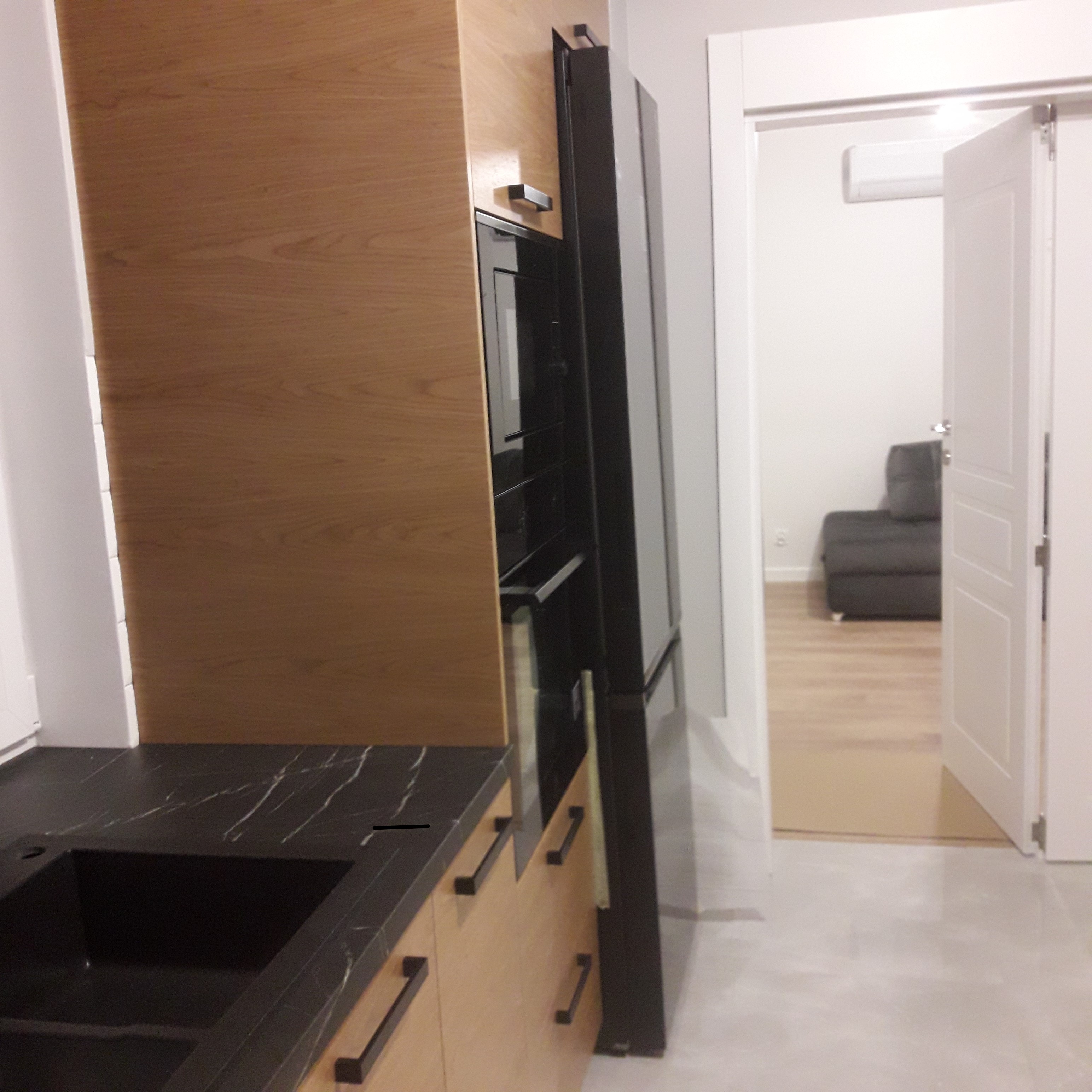

  • #16 19160473
    Krzysiek0408
    Posts: 8
    Please, Wojtek :)
    I anticipate the question about the spirit level - EFFICIENT

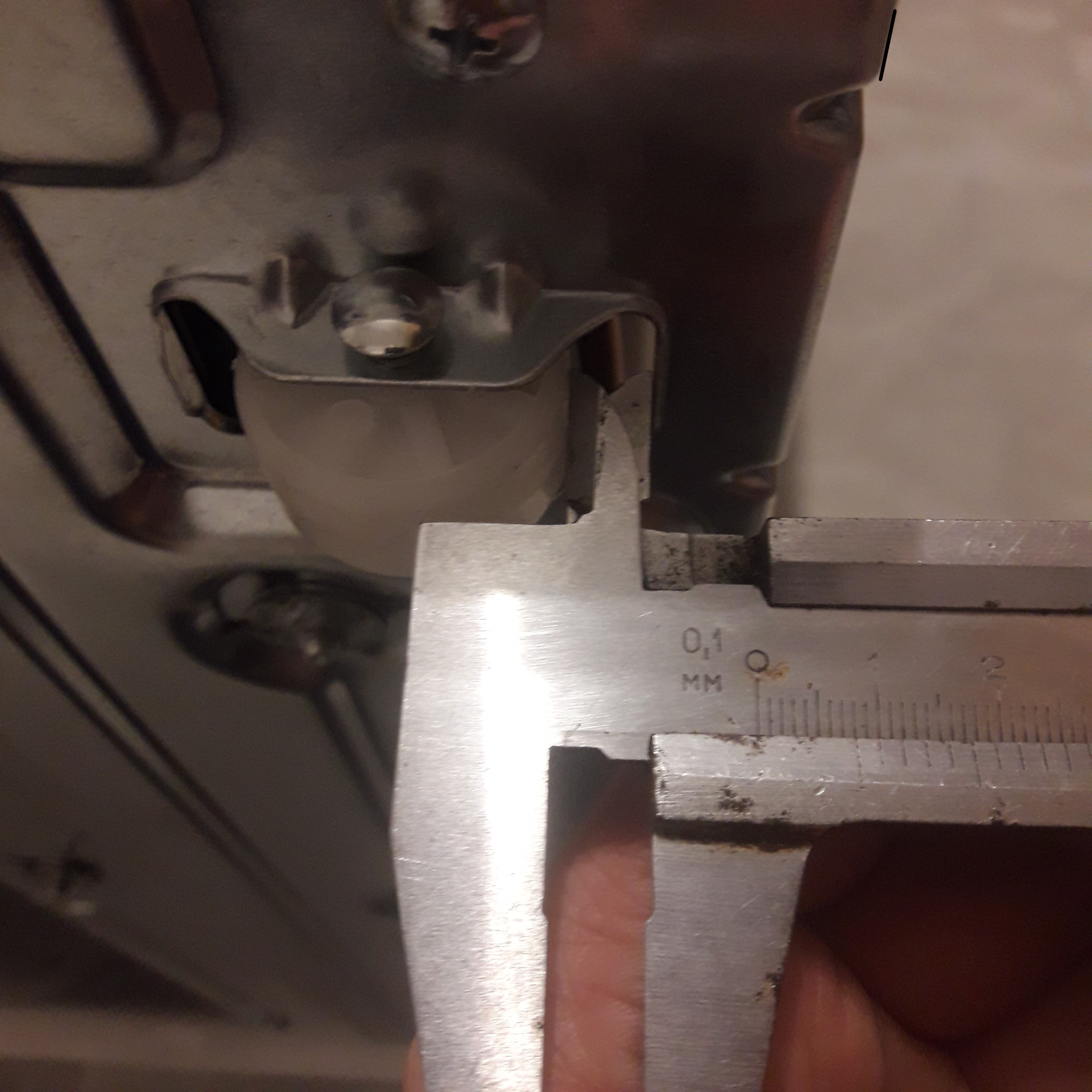

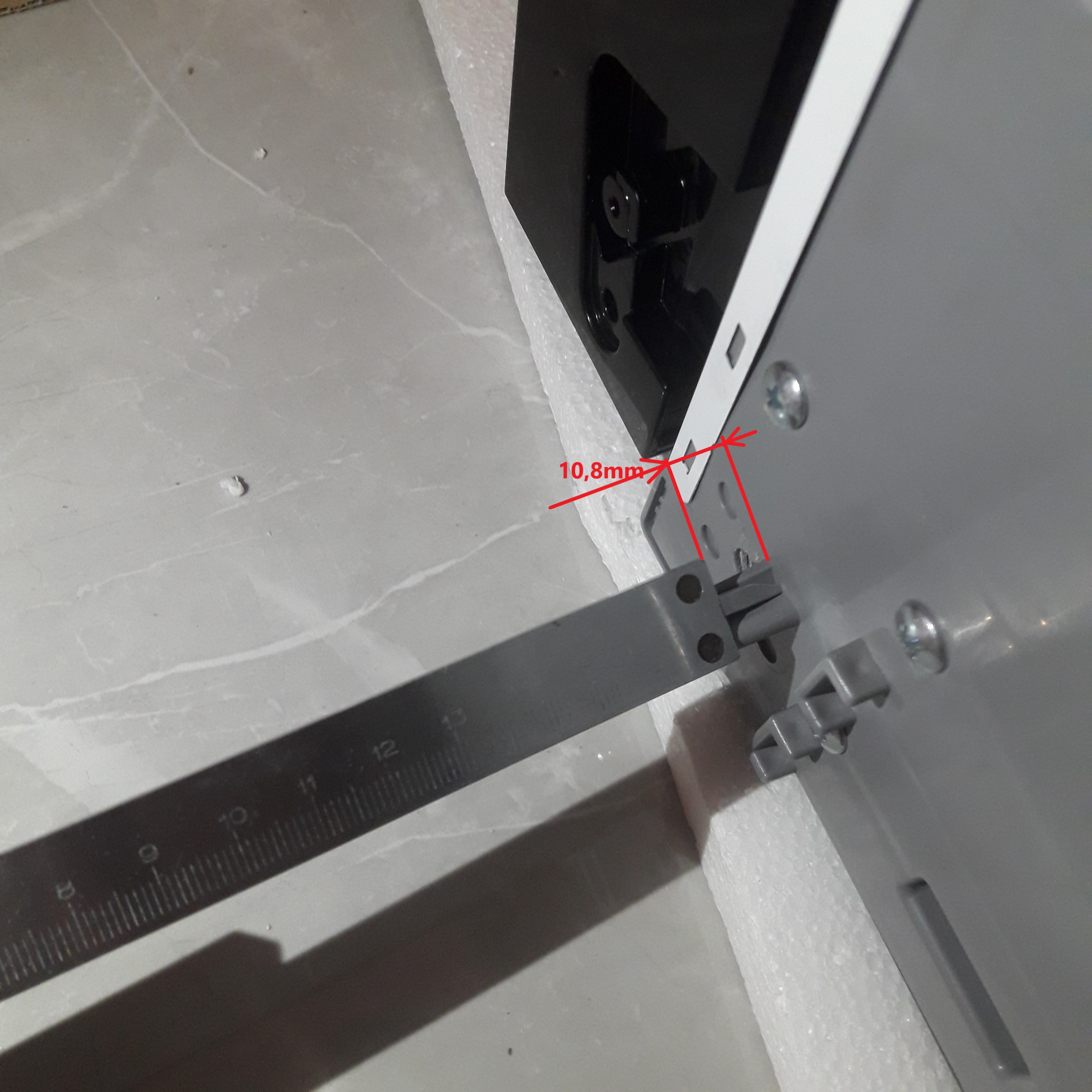

    #20 19160681
    Krzysiek0408
    Posts: 8
    1.Yes, the floor is level,
    2. The axles have not slipped out, the wheels themselves could have been higher, there is room for this
    There is a distance of 3 cm on the back of the refrigerator which prevents the refrigerator from being pushed all the way to the wall. There are gaps of a few cm around the refrigerator and a gap of about 1 cm between the cabinet and the wall above the refrigerator - it may not boil over.
    The wheels on the back could be higher, so maybe you are right that the Chinese assumed the wrong diameter. In order not to mechanically interfere with the mounting of the wheels (because the wheel axle is pressed), I thought about making half rings for polyurethane wheels.
    Removing the plastic stops under the front wheels would also help, but it is also a mechanical interference - it must not be done according to Samsung.
    • Samsung Side by Side Refrigerator - Leveling the refrigerator 8 ogranicznik przód prawy bez nózki.jpg (1.33 MB) You must be logged in to download this attachment.
    • Samsung Side by Side Refrigerator - Leveling the refrigerator 7 ogranicznik przód lewy bez nóżki.jpg (1.43 MB) You must be logged in to download this attachment.
    • Samsung Side by Side Refrigerator - Leveling the refrigerator 6 kółko tył1.jpg (1.38 MB) You must be logged in to download this attachment.
    • Samsung Side by Side Refrigerator - Leveling the refrigerator 5 kółko tył.jpg (1.36 MB) You must be logged in to download this attachment.
  • Raise rear wheels and anchor top to wall
    #21 19160698
    jack63
    Posts: 11792
    Help: 851
    Rate: 2822
    Krzysiek0408 wrote:
    THE BACK OF THE REFRIGERATOR IS 3CM THAT DOESN'T ALLOW THE REFRIGERATOR TO BE PUSHED INTO THE WALL. AROUND THE REFRIGERATOR GRADES A FEW CM AND ABOUT 1CM BETWEEN THE CABINET AND THE WALL ABOVE THE REFRIGERATOR - IT MAY NOT BOILER
    It doesn't look good, which is a typical pseudo-carpenters' maniana.
    See yourself a cabinet on / above the fridge from IKEA. There it is not 1cm, but 6cm from the wall. So the channel, not the stomata.
    Put something under the rear wheels and try to balance the refrigerator with the door open and there are several bottles of soda on it.
    May it not turn out that the hypothesis is a valid theory ...
    Then you need to fix the top of the refrigerator to the wall.
