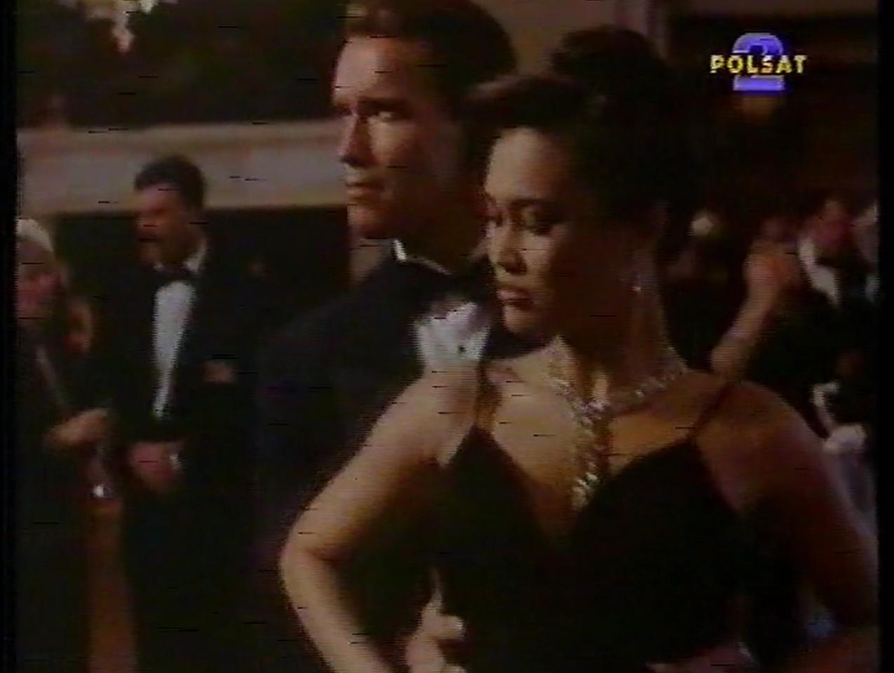

    Hello, I have a Media-Tech MT 4169 video graber, I use Debut Video Capture Software for image capture. I have a question, is it possible to improve the quality of the recording in some program, my point is that (as you can see in the photo, you can see the actress's arm), jagged contours of the figure are visible, can it be eliminated?

    The first thing that catches your eye are the many horizontal black lines.
    It may be the fault of the VCR - worn head or the cassette itself is in such a bad condition.
    I propose to play this cassette on other working equipment and compare it with my own.
    If the cassette is in such a bad condition, there is not much to improve it at home.

    I am sorry because I forgot to write, the black lines do not come from the VCR but from the recording of the image source, i.e. from the analog satellite (long ago, when digital decoders were new, there were analog satellite decoders and they liked to collect dirt when the signal was weaker), the VCR is in a great condition, and all I did with it was replacing the drive belts because it was not rewinding the cassette to the end.

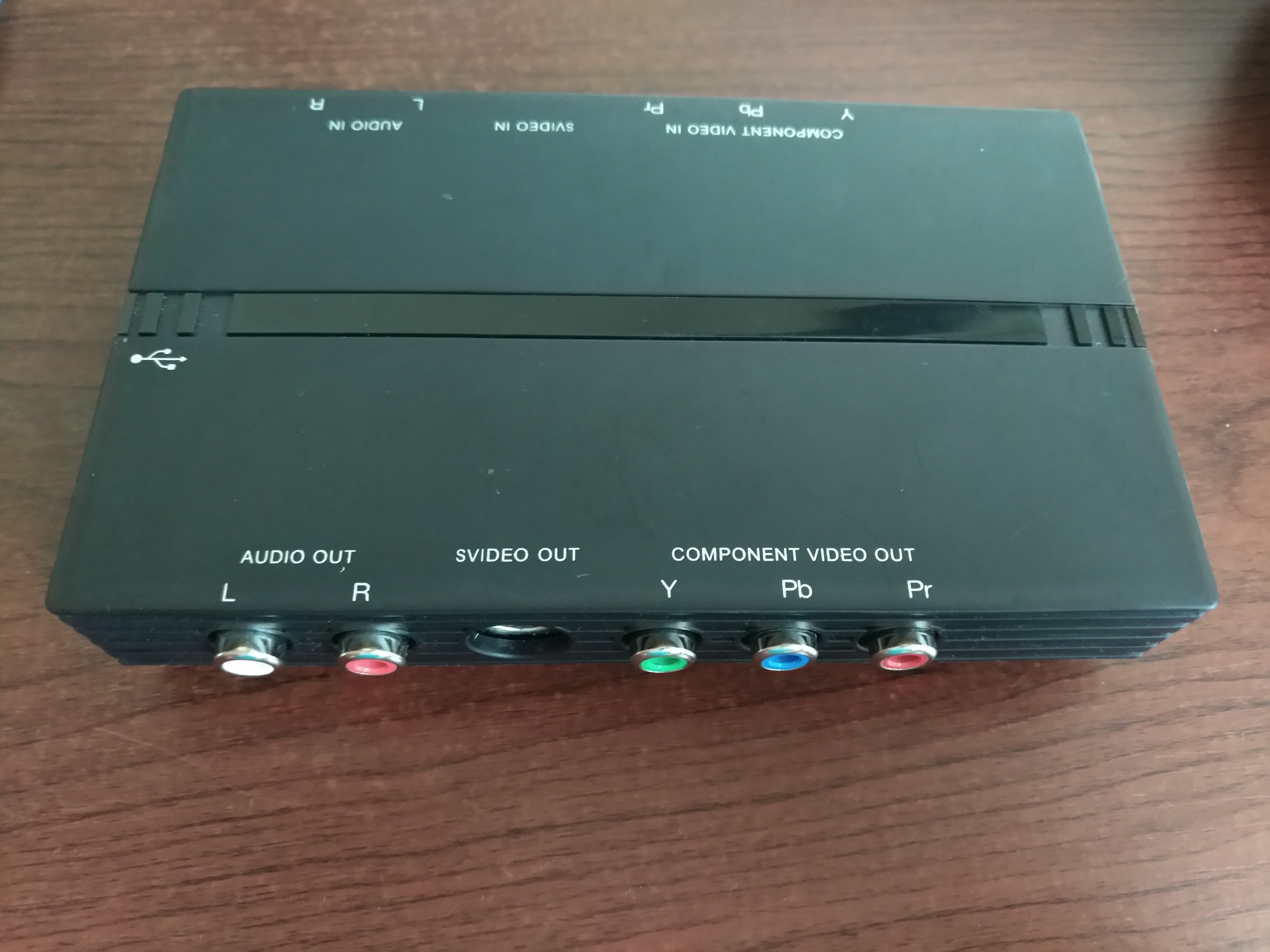

  • MPEG-2 codec gave best VHS capture quality

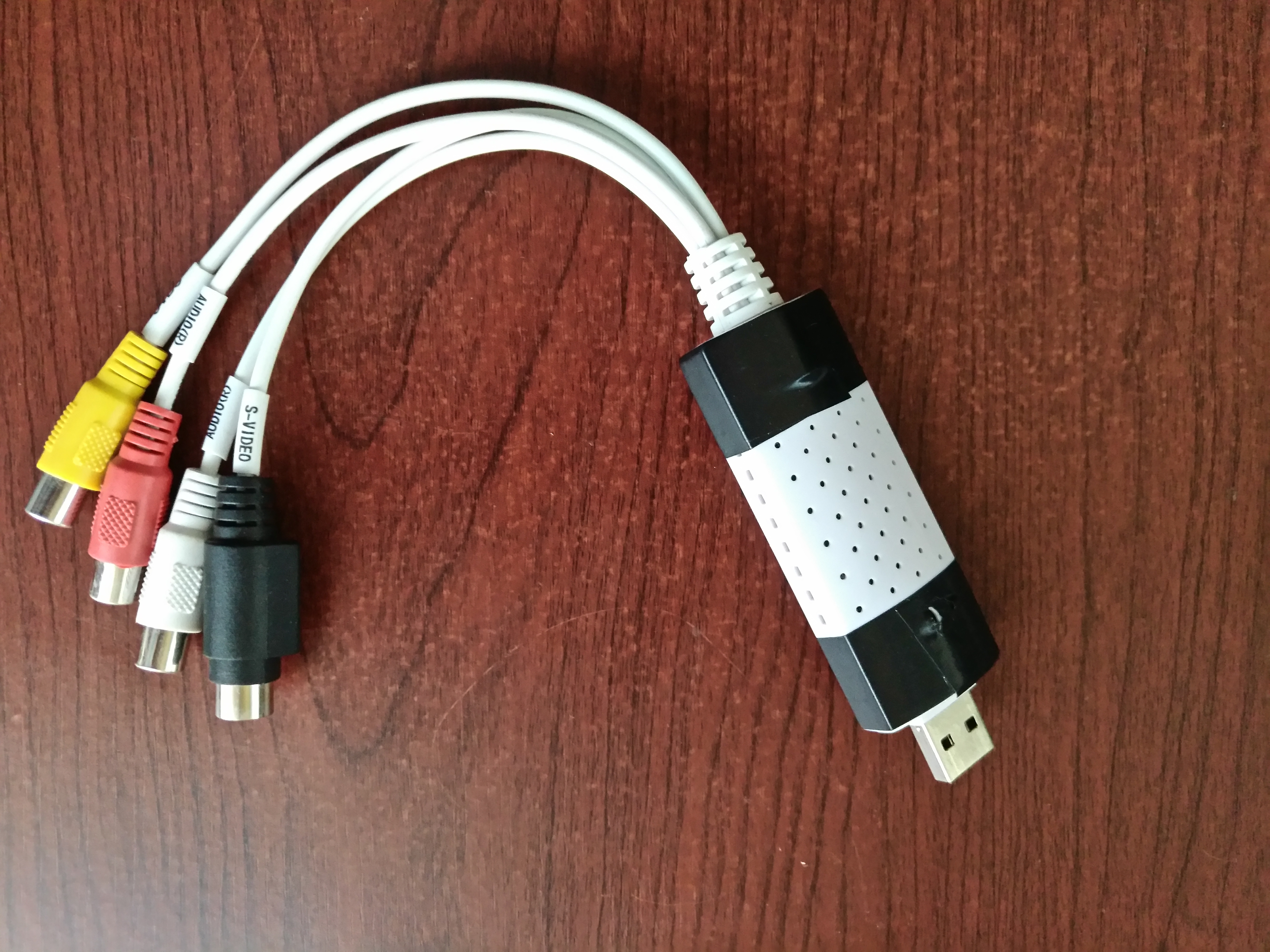

    I was playing with a USB Grabber which the effects were very poor. Lots of combinations to make me happy with the quality of the material.
    Improving Ripped Image Quality from VHS Tapes with Media-Tech MT4169 Video Grabber & Debut Software
    Then a TV card in a PC that lost frames terribly.
    The last equipment in England I also bought for USB with a cable like in a printer.
    It mimicked image and sound very well. The most important thing is to choose a codec. I probably chose MPEG-2, and VHS is DVD v3.0.
