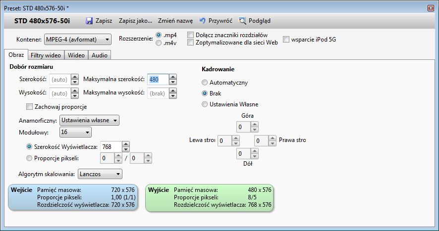

    Convert mp4 to VOB (DVD-Video) while maintaining the properties of the source fi
    now VidCoder settings (version 1.5.35.0, newer have a pixelated setting of pixel aspect ratio)
    project settings, tab 1

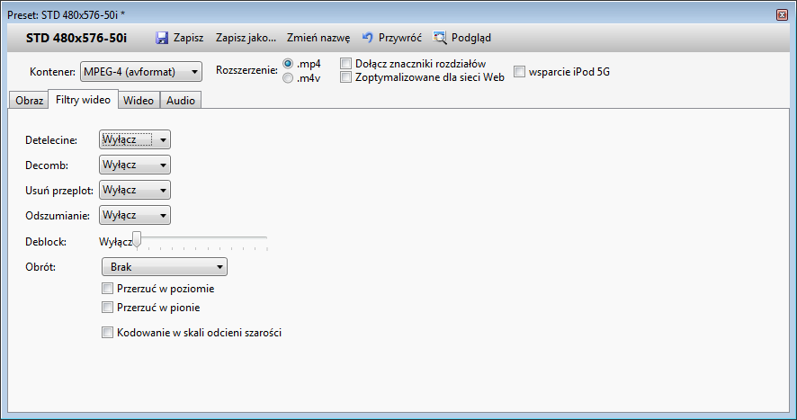

    project settings, tab 2 (no changes)

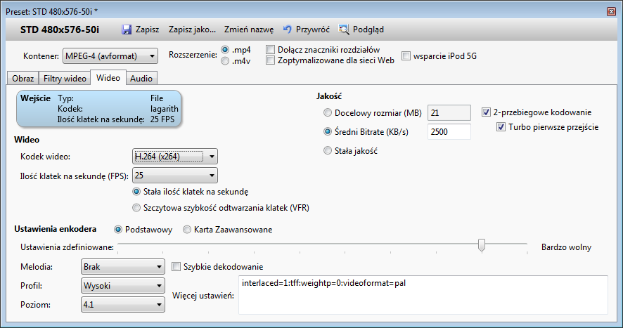

    project settings, tab 3

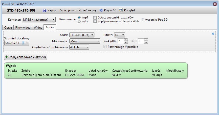

    project settings, tab 4
