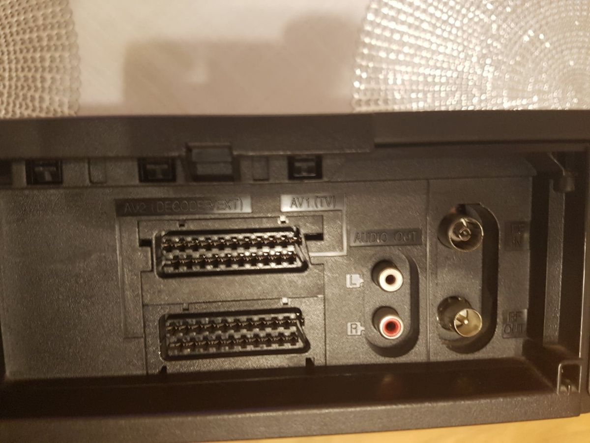

    Hello!
    I'm green on ripping, hence my question. Does any of your colleagues know what I need to buy to transfer VHS tapes to the computer at the same time? without losing quality ? I would like to do it professionally, once and for all.
    I've heard about "grabers", but as far as I know, quality is losing on them. I am aware that some quality will be lost for sure, but I want to do it in the best possible way.

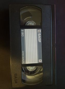

    I mean such specific cassettes:
    Transferring VHS Tapes to Computer Without Quality Loss: Using Gigabyte Z390 AORUS ELITE Transferring VHS Tapes to Computer Without Quality Loss: Using Gigabyte Z390 AORUS ELITE

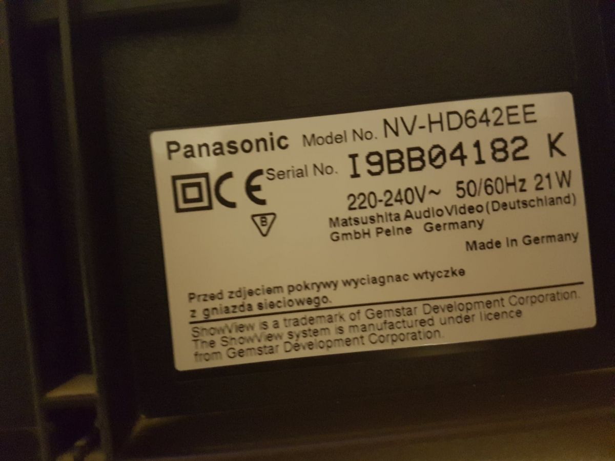

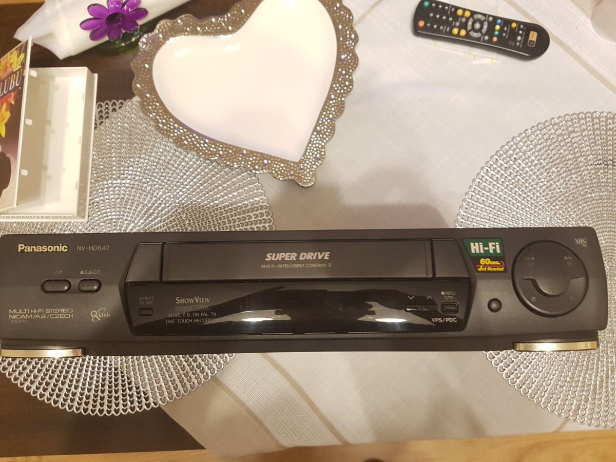

    This is my player (fully functional):
    Transferring VHS Tapes to Computer Without Quality Loss: Using Gigabyte Z390 AORUS ELITE Transferring VHS Tapes to Computer Without Quality Loss: Using Gigabyte Z390 AORUS ELITE Transferring VHS Tapes to Computer Without Quality Loss: Using Gigabyte Z390 AORUS ELITE Transferring VHS Tapes to Computer Without Quality Loss: Using Gigabyte Z390 AORUS ELITE
    Motherboard: Gigabyte Z390 AORUS ELITE
    Graphics: Gigabyte GeForce RTX 2070 GAMING OC WHITE
    System: Windows 10
    Will this ripping consist of playing these cassettes on this VHS player, and catching it directly on the PC?
    I do not know anything about it ... And I have a lot of it, so I would probably pay a few hundred zlotys on the website.
    What do I need to buy to connect such a "player" to the computer?

    if your computer (standard does not have any video input) then you need to buy a video grabber or some other video adapter card, each card will slightly modify the signal (ADC converters) theoretically more expensive card = better quality.
    On the other hand, I would not exaggerate with this quality, the signal from the VHS system is not the top quality.
    Connections: the grabber and to it you get videoOut, Lout and Rout signals from the SCART-AV1 connector during normal playback of the cassette by the VCR.
    Another issue is the format to which you rip, if you use any compression then you may notice a loss of quality here.
