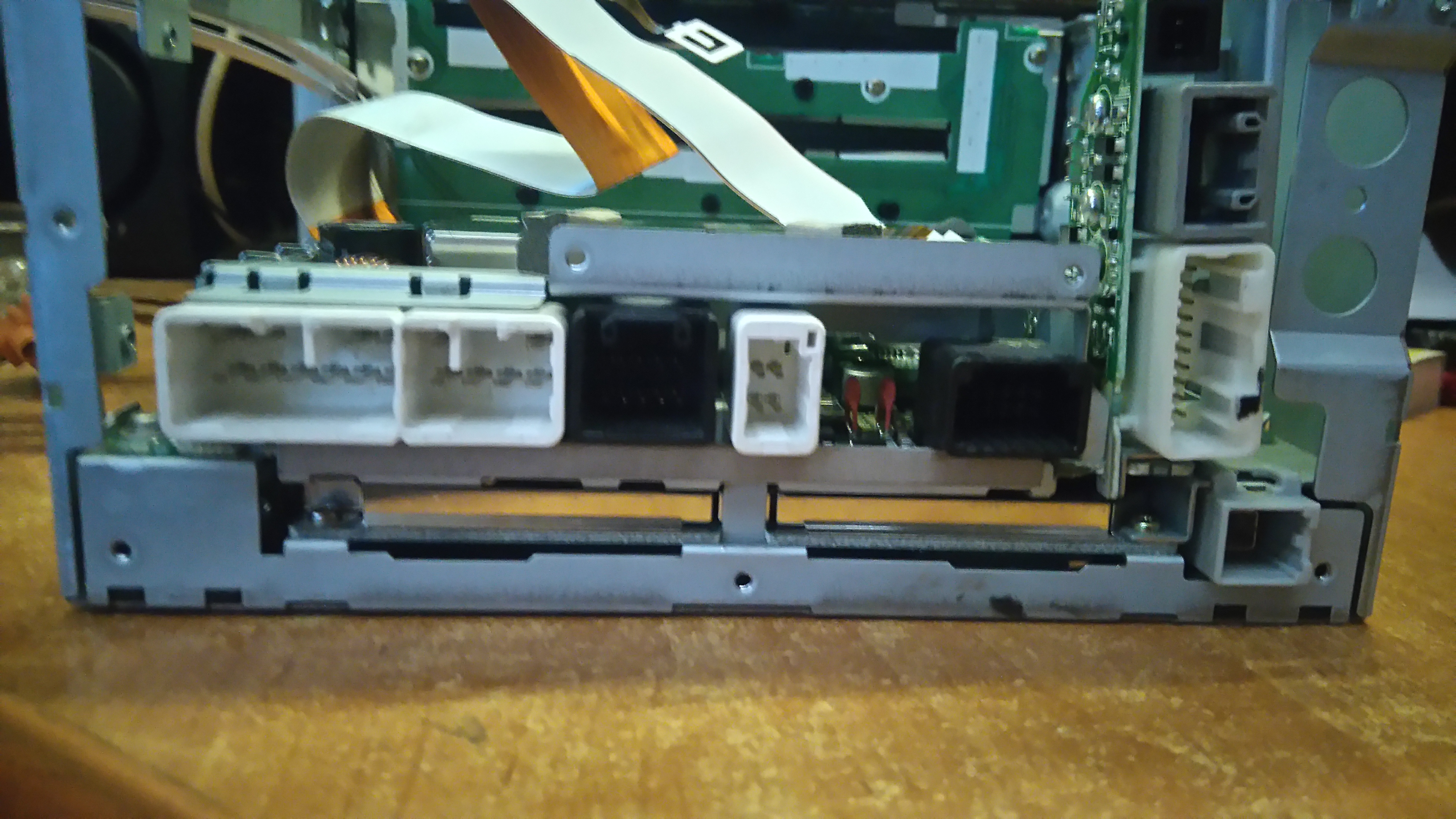

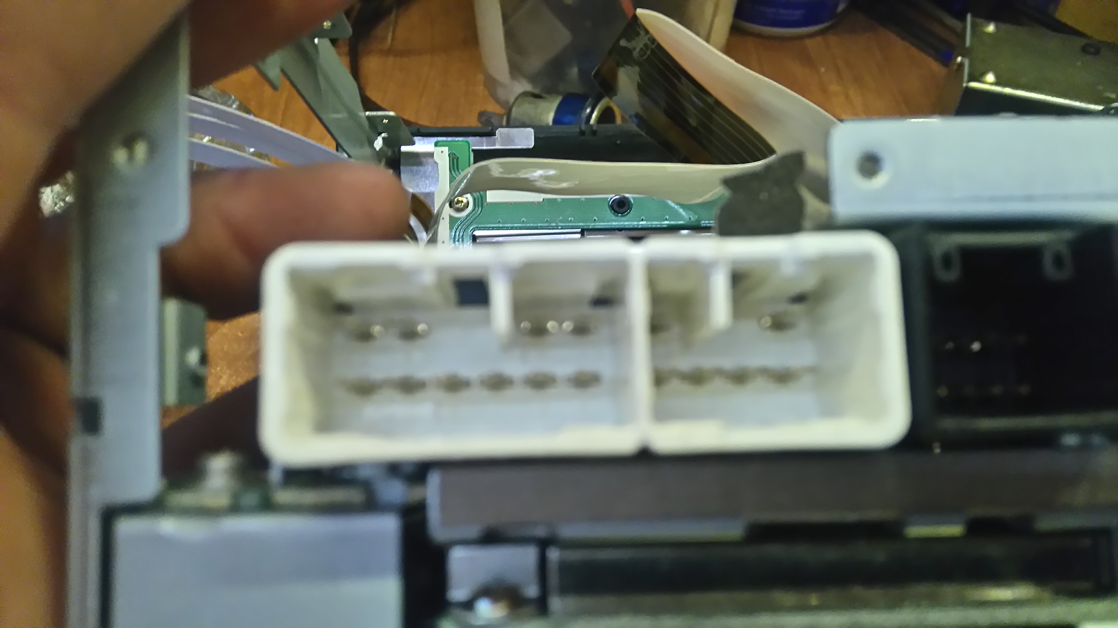

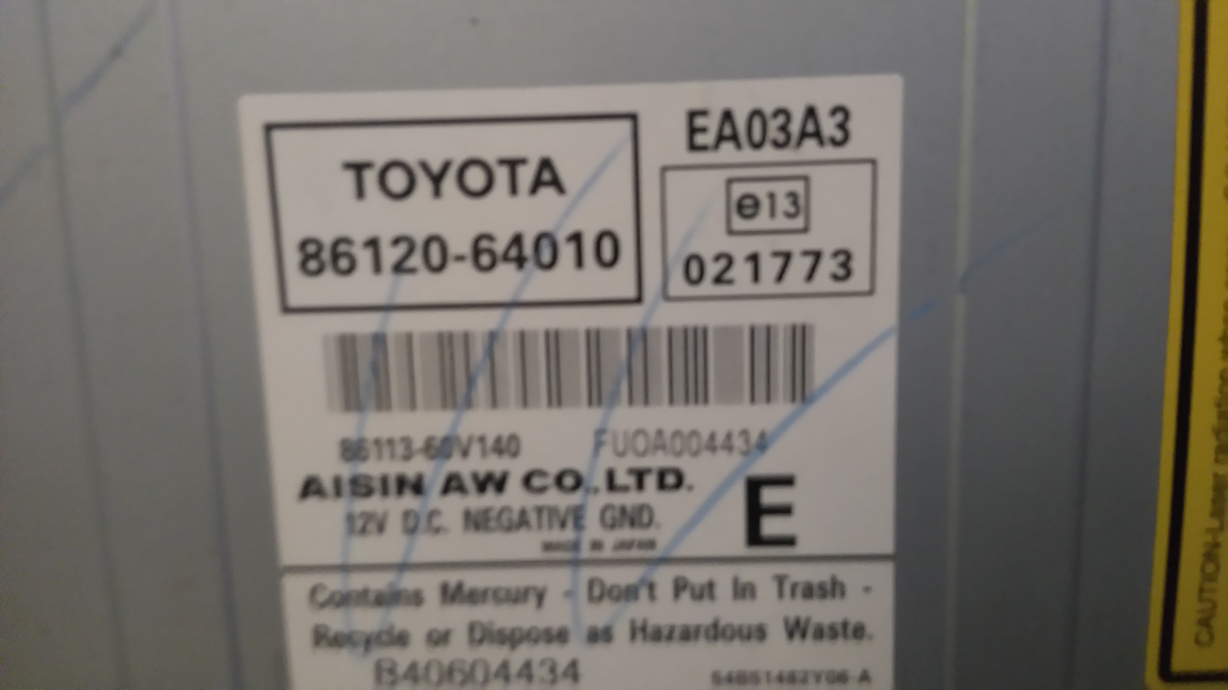

    Hello. I have such a radio on the table, I need a list of power pins. Any help is appreciated.

    I connected the cn701 plug pin 3,4 + 12v, 7 mass and nothing puzzles me yet pin 10 what are you nato

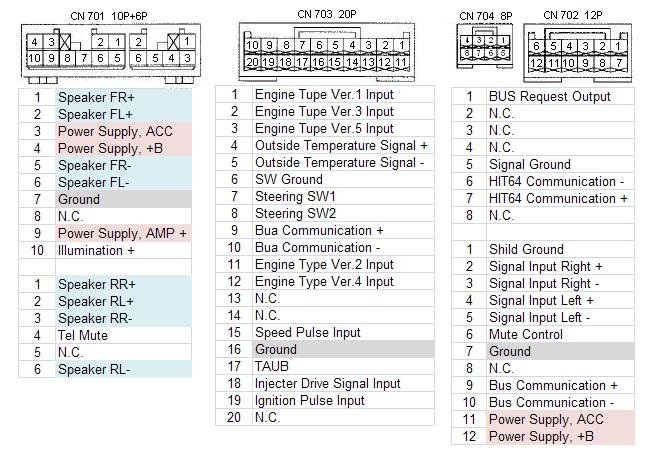

    pin list

    CN701 pin 10 this is the display backlight + 12V.

    Ok thanks for helping the radio work
