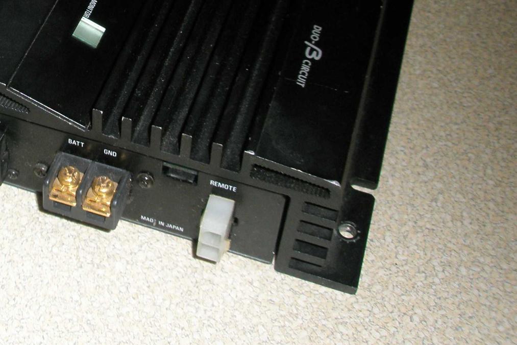

    Maybe a bit of a stupid question, but I have a problem.
    There is a cube on the amplifier with the inscription remote - I wonder why this cube has 2 pins. Which pin (top or bottom) should I apply 12 volts to to start the amplifier? In other amplifiers I used, the remote input was between +12V and gnd
    Below is a photo of the amplifier.
    Which Pin for 12V on ALPINE 3544 Amp's Remote Cube?
    I`m waiting for specific answers
    Best regards, Łukasz (lenin10)

    Test the plus with a light bulb tester (low power, of course) and you will see whether two are needed or just one.

    Serve on top

    The remote is in this cube and, as I wrote, applying voltage to the upper pin solves the problem

    There should be a special cube, but it rarely is ;) Pass it to the lower one - the upper one seems to pass it further to the next amplification.

    Of course there should be a cube :) At the moment I have Alpine 3550 and 3517 at home, in 3550 the remote control is on the top pin, I assume that Alpine would not change such matters

    Always on top!

    Damn - of course when you write - I know it`s at the top, but I wrote the opposite. Is it late or what? ;) Sorry

    of course, the top pin is responsible for the remote - let this be a topic for future generations :)
    I think it can be closed
