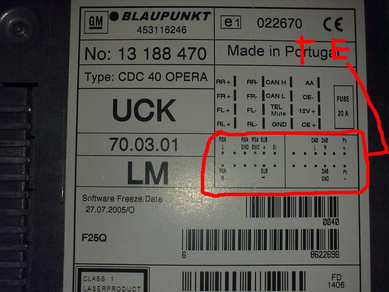

    Hello, I need a description of the 2008 Opel CD30 mp3 radio cube.
    I am mostly concerned with where to connect to the AUX input
    In the radio I have the AUX active with TECH2 and the function is active, only the pins need to be wired in. Please help .
    Photo of my cube with pins.
    https://obrazki.elektroda.pl/60_1265983714.jpg

    The attached photo shows TEL MUTE. If I turn on the signal, the radio will automatically go down.

    TEL MUTE is responsible for controlling the radio from the hands-free set (usually the set comes out yellow, i.e. minus after starting or receiving a call)

    Maybe you still have a description of the markings for this radio. I mean the ones that I marked with a circle. I have them in the other car.
    Photo:
    https://obrazki.elektroda.pl/32_1266826972.jpg

    mialczyk wrote:
    Maybe you still have a description of the markings for this radio (...)
    I don't understand what description are you looking for?
    What do you want to connect to this radio?
    The most important pins are described in your photo.

    here I also want to connect AUX and here are other markings, I connected to these dabs and nothing works. I don't know what the next pins are for -EL, RSA, SUB is probably a Subwoofer, Ph is probably a phone, and these DAB is what it is like AUX, why doesn't it work?

    T0 what is Dab and others

    DAB - opcjonalny tuner radia cyfrowego
    CDC40 with DAB tuner option Do not use AUX input
    AA = Connection to Twin Audio
    CE = center speaker ground
    CE+ = center speaker signal
    RSA L = signal connection to Twin Audio
    RSA R = Signal Connection to Twin Audio
    RSA GND = Ground Connection to Twin Audio
    RSA SWC = Control line to Twin Audio
    SUB+ = control line to info display
    SUB - = control line to the info display
    EI = connection to the telephone unit plug
    Ph + = connection to the Twin Audio
    Ph - = Connection to Twin Audio

    The CDC40 with the Tuner DAB option does not have an AUX input
    AA = Twin Audio Control
    CE = mass of center speaker
    CE + = Center speaker signal
    RSA L = Twin Audio Signal Connection
    RSA R = Twin Audio Signal Connection
    RSA GND = ground for Twin Audio
    RSA SWC = Twin Audio Control Line
    Sub + = Display control line
    SUB - = Display control line
    EI = connection to Tel. hands-free kit
    Ph + = connection to Twin Audio
    Ph - = connection to Twin Audio
