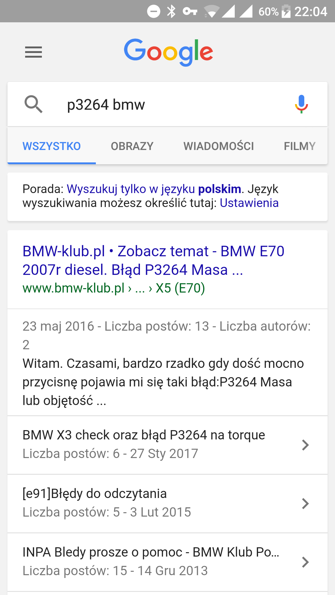

    ewenement22 wrote:
    I don't know the error description. Torque gave only the number.
    I searched but did not find what exactly this error meant. Anyone have any page with a list of errors for BMW ??
    Well, probably a sketch .....
    • BMW X3 E83 - BMW X3 check and P3264 error on torque and some questions. Screenshot_20170129-220416.png (254.69 KB) You must be logged in to download this attachment.
  • #7 16238468
    ewenement22
    Level 21  
    Posts: 830
    Rate: 93
    I saw it but it was not confirmed for me because I also saw other descriptions of this error.
    I was looking for a list of BMW errors and did not find this code in any of the found lists.
    If this is the correct description, please -
    :P 3264 Mass or volume of airflow too low due to sensor failure
