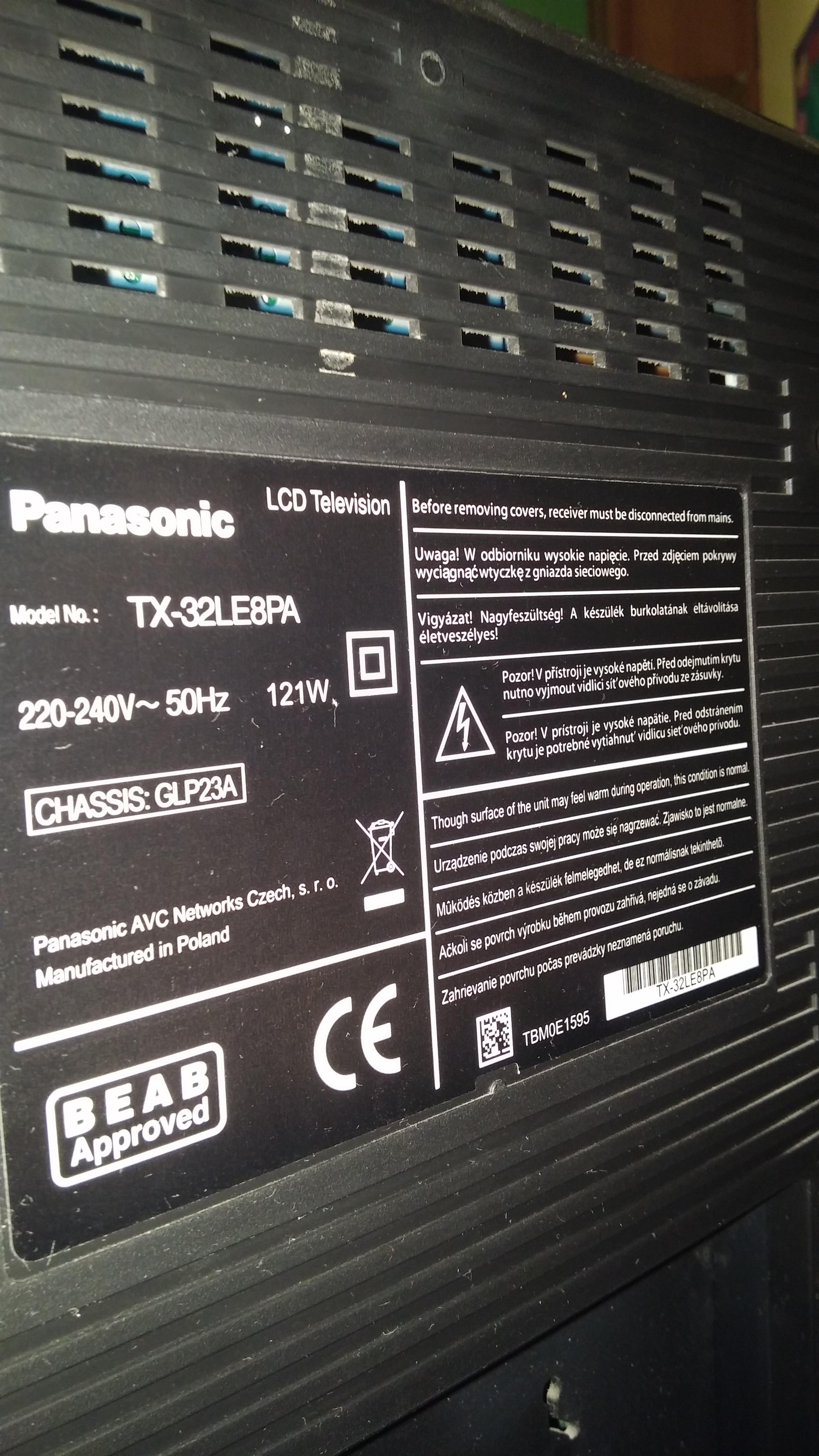

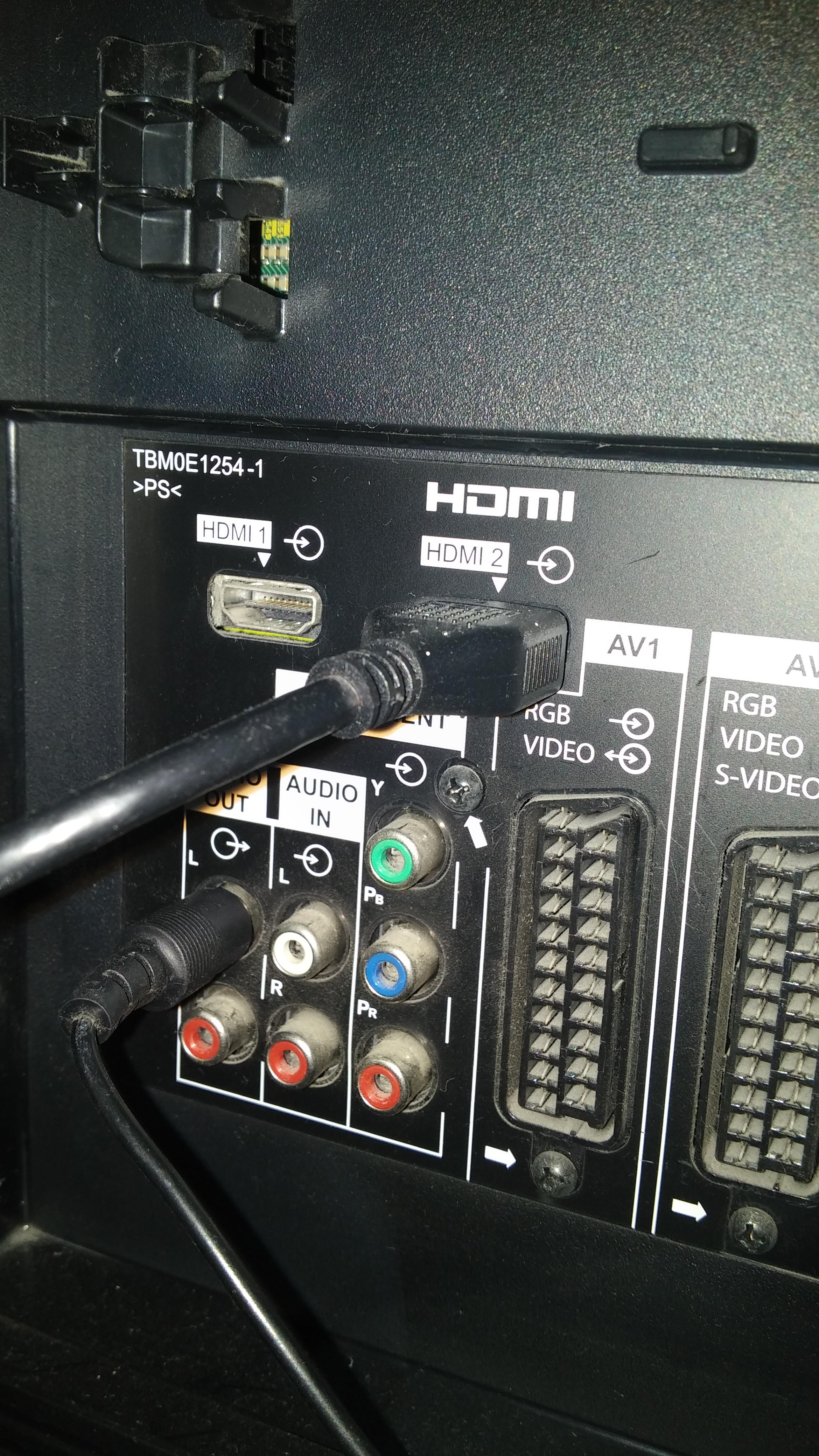

    I have (I think) a Pioneer vsx-c501-s receiver with five speakers and a subwoofer.
    I would like to connect everything to a Panasonic TX-32LE8PA TV with a PS4 console.
    I don't know which cable to use and which port should I connect it to.

    But in PS4 I only have USB and HDMI, which is not present in the receiver.

    It is, however. You say to connect with an optical cable, but to which port?

    To optical port (if tv has one).
    And if the tv does not have it, then the optics, including the KD (provided that the KD has an optical port as a signal input).
    The tv and KD manuals should explain this.

    I do not have instructions for this pioneer and the tv does not have such an input. But how do I connect the ps4 optical cable with this pioneer and the PS4 HDMI cable with the TV, should it work?

    The receiver has two optical inputs. So how do you finally have the optical output in Ps4?

    Well, you connect the PS to the KD with an optical cable - you configure the console (if necessary), select the appropriate input on the cinema remote control and that's it (you may also need to configure it, but connect and check first).
