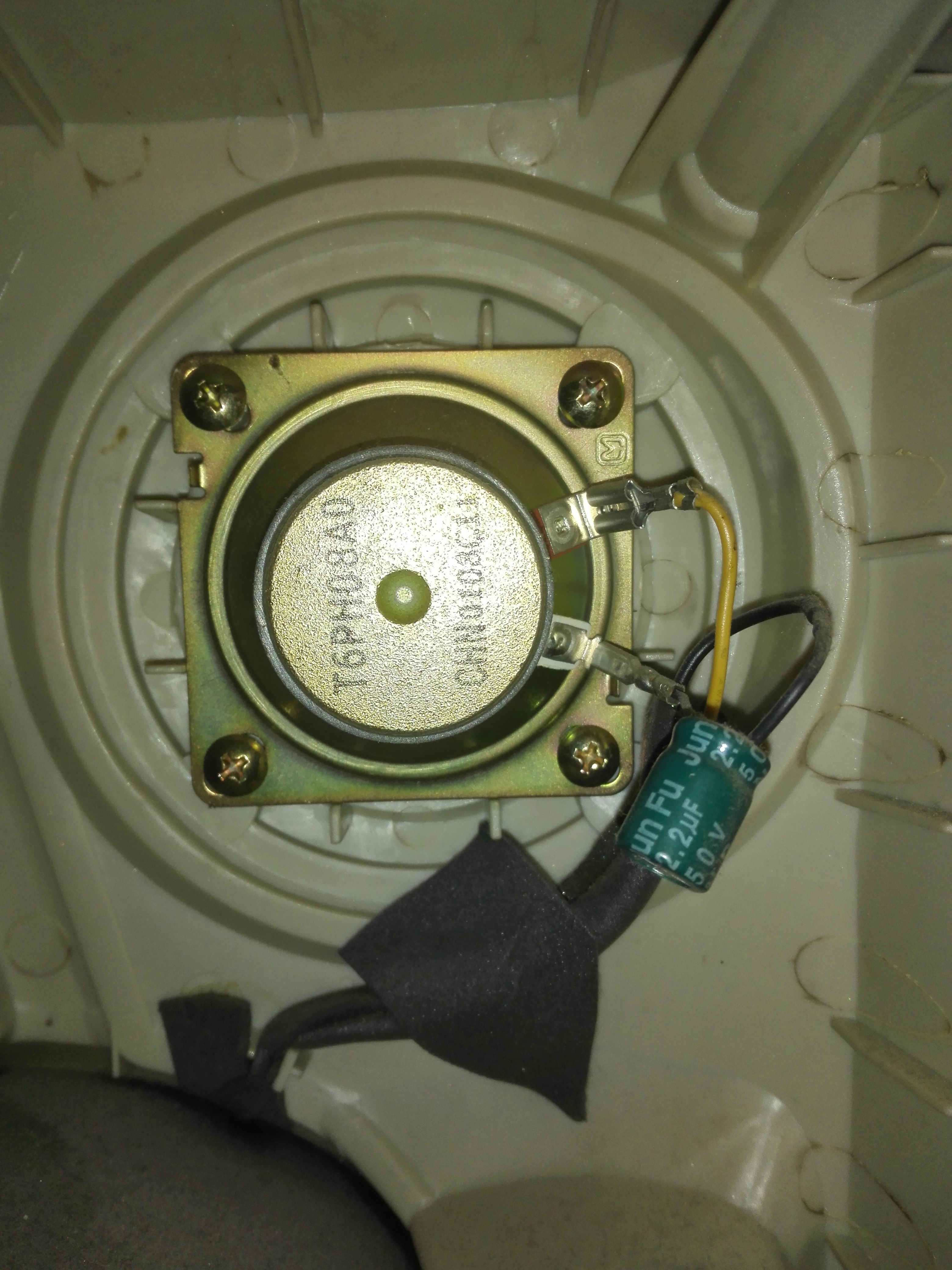

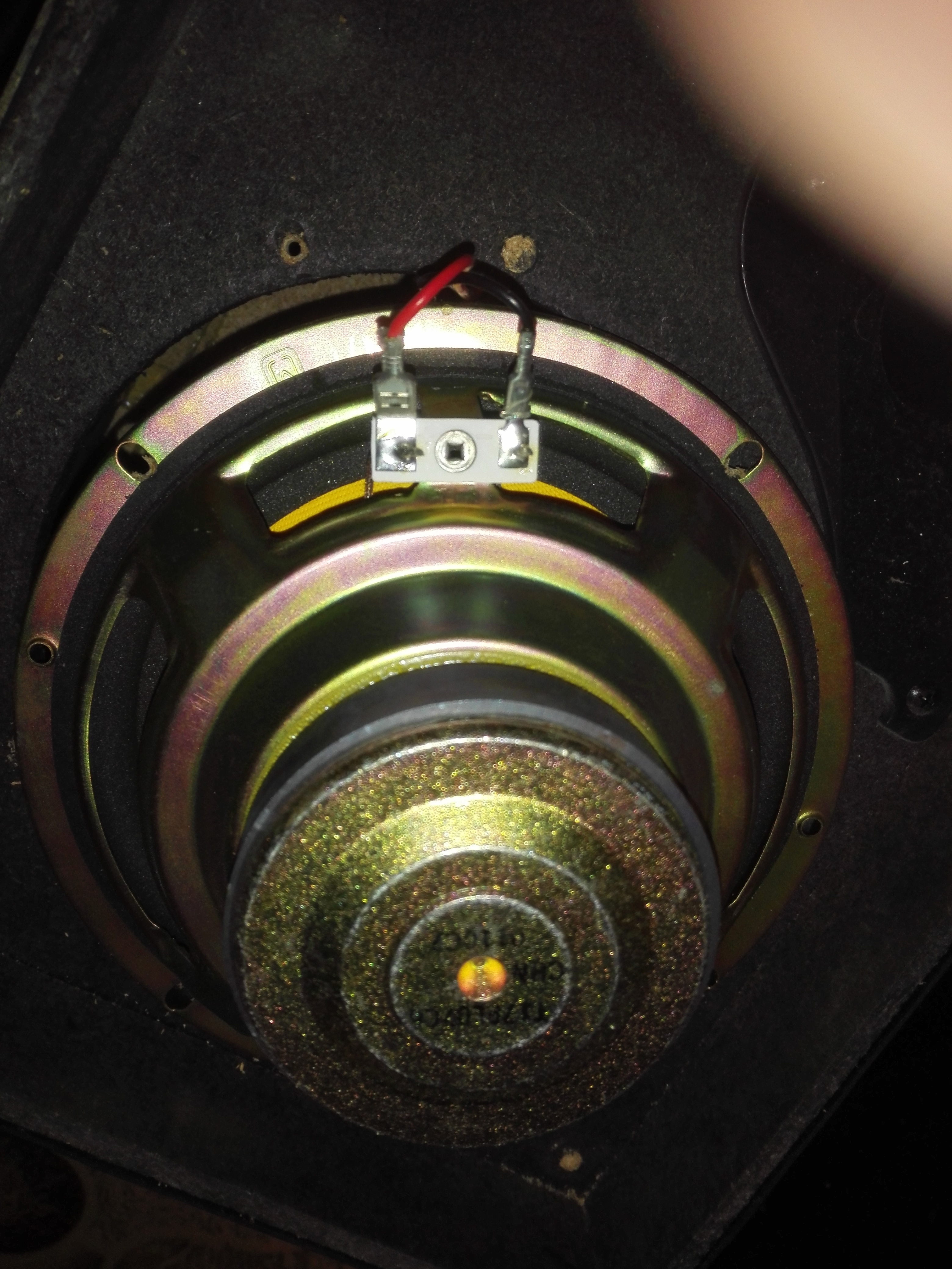

    I put pictures. I assume the black and red cables come out of this third speaker in the back. I hope this will give you some view, if you need to "dig deeper" let me know, I'll do more. I am sorry that so much dust on them but I decided to clean after curling.

    See if there is any element in the midrange speaker (silver) between the cable and the speaker, the same in the yellow woofer. The resistance you get must be at least 6 ohms for such a set with ws to be viable. Admittedly, with such a ws315 with an o11d equalizer I powered the Amfiton 50ac-022 speakers in 4 ohms and lived for many years, but it was necessary to pay attention to the amplifier's temperature when it was spinning high. You can look at some old Sony, Technics, Philips, Sansui, Grundig etc. It's good that they are not on the STK terminals because it's difficult to fix now because of the availability of elements, just like the tower from which you have speakers.

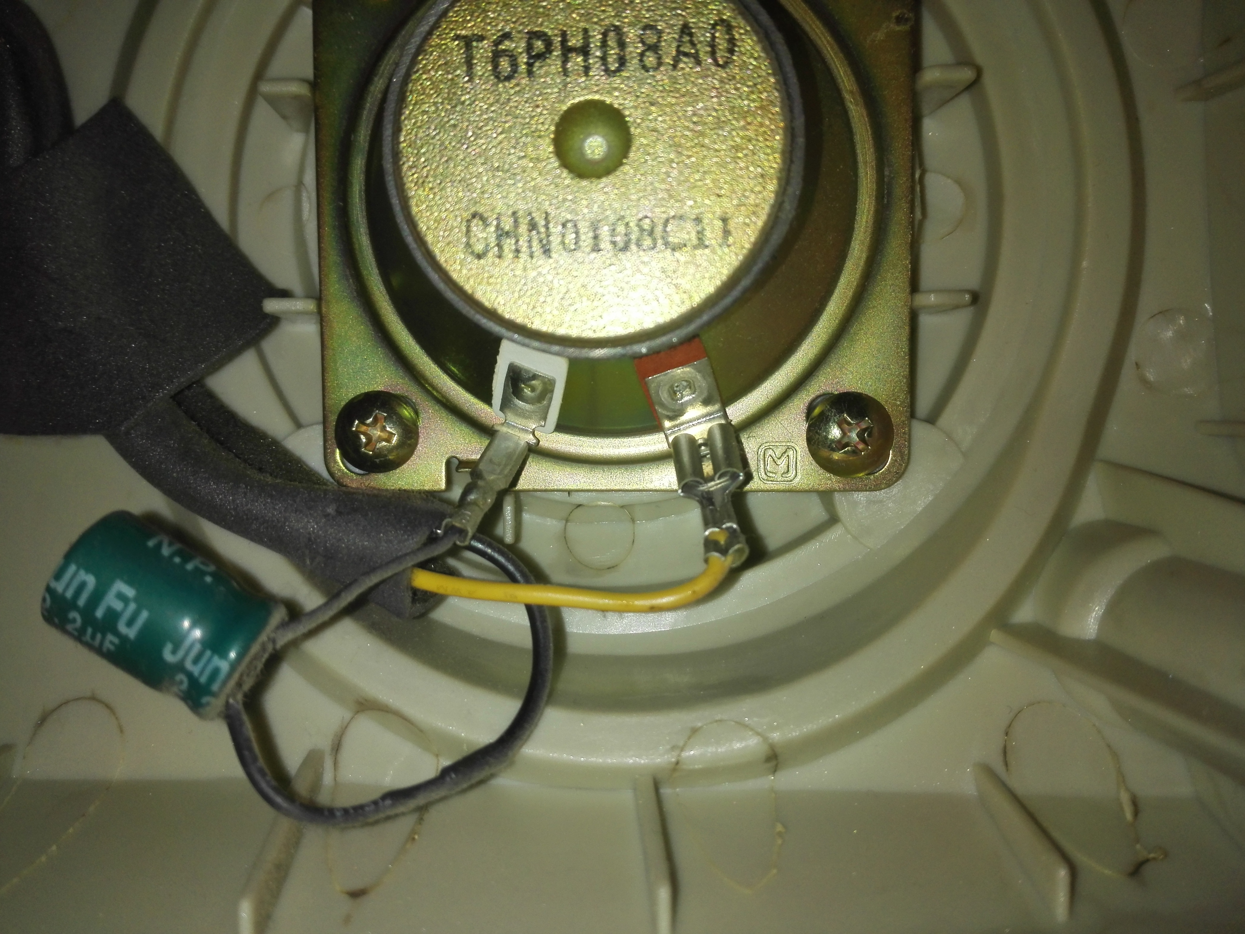

    I will not play it loudly, it can't cope with the speakers built into the laptop. I insert pictures of cables from a small speaker and a large one without a cover.
    Voice Kraft VK 5500 amplifier and four-wire speakers from the Panasonic AK44 tow Voice Kraft VK 5500 amplifier and four-wire speakers from the Panasonic AK44 tow Voice Kraft VK 5500 amplifier and four-wire speakers from the Panasonic AK44 tow
    There are no elements between the cables and speakers, only small.

    I'm adding yellow, which I forgot. I also looked carefully at the cable from it in the housing, but also the lack of any element.

    The loudspeakers without modification are not suitable for this amplifier (no crossovers).
    The original tower has two amplifiers for one channel and they do it as crossovers.

    It is currently on Alledrogo supports loudspeakers from 4?, output on transistors, AUX input on RCA and ordinary loudspeaker terminals. The price is also a bit excessive, but it is a bit "vintage". Unitra is a simple amplifier, it will be repaired by any home-grown electronics. You will make the loudspeakers like most marketers' producers, by adding a capacitor to the midrange (tweeter already) and connecting everything in parallel.

    I bought Toshiba. I am asking you for further observation of the topic, when it comes, we will think about the speakers, in the meantime what capacitors to buy? And do you connect the third woofer and the capacitor to it? Because you can't see any there. Connect in this way: http://www.hifi.pl/porady/uzytkuje-rownolegle-szeregowe.php?
