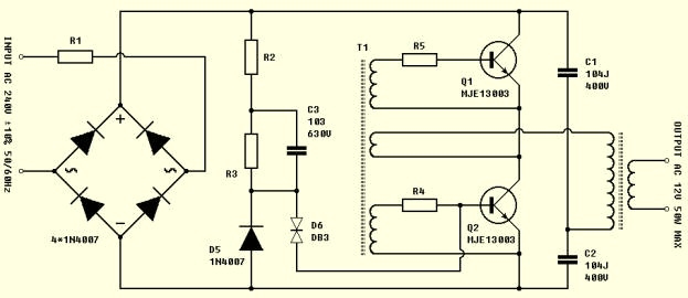

    The author must start, however, by changing the power supply :) because those to halogens sow mercilessly and it is very difficult to filter it.

    Once I insisted and tried to use such a halogen electronic power supply, but the cost of building effective filters for it exceeded its value significantly :) .
    Such a power supply usually looks like below.

Why is my 12 V switch-mode power supply problematic?
Its 20–100 kHz switching edges leak 50-150 mVpp into ground, entering audio stages as wideband noise (TI App Note). Forum tests confirmed hiss vanished when the SMPS was removed[Elektroda, 398216, post #16670286]
