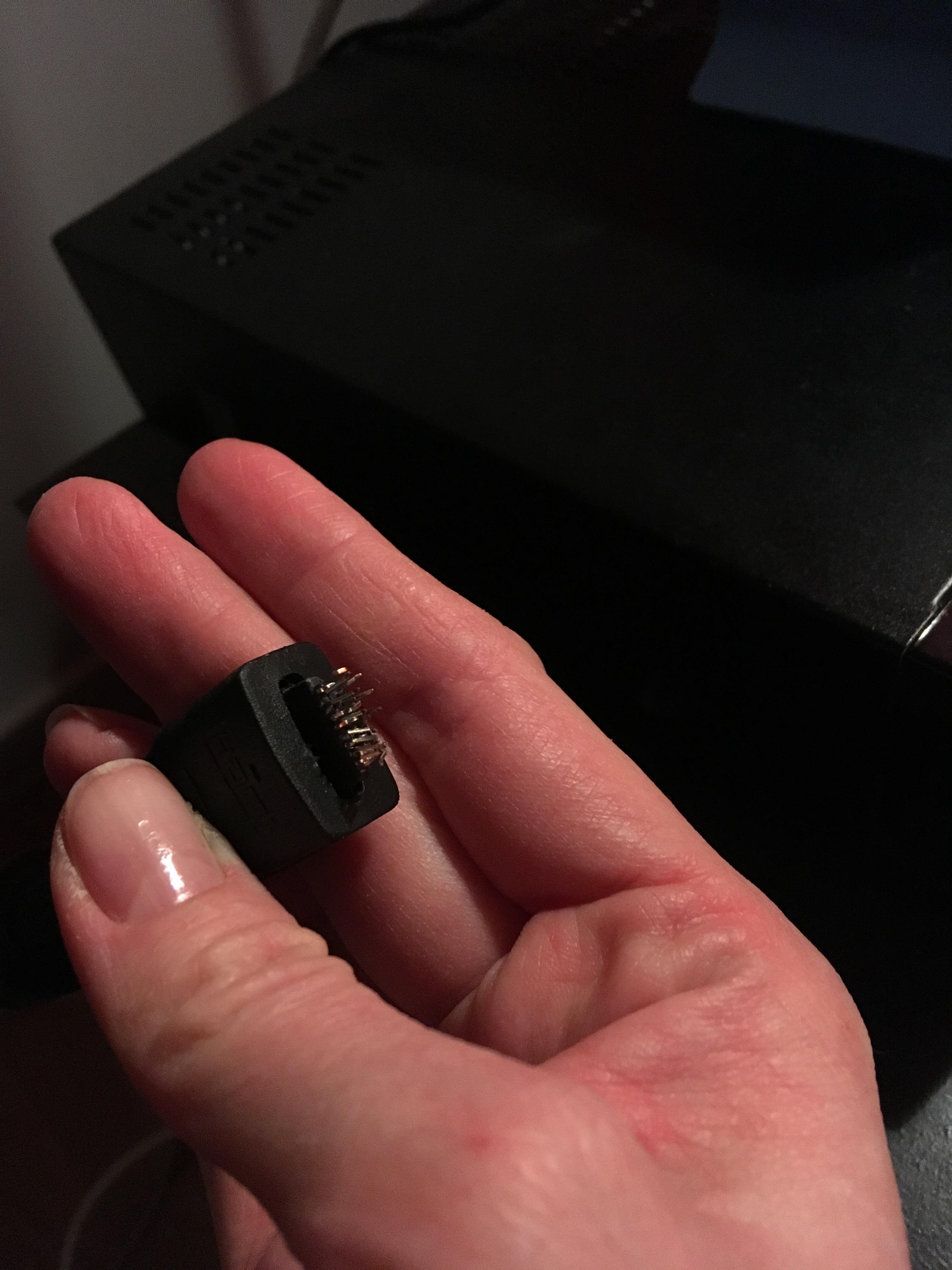

  • #8 17018026
    Evika27
    Posts: 8
    gentlemen
    Who will exchange the HDMI input for me?
    The dog bit my tip at the set-top box the child finished the job :) and the cable in the wall ?
    Option 1 pull a new cable, option 2 replace the end. Do any of you live near Krakow - Bochnia and would he fix it for me?
    I am begging you
