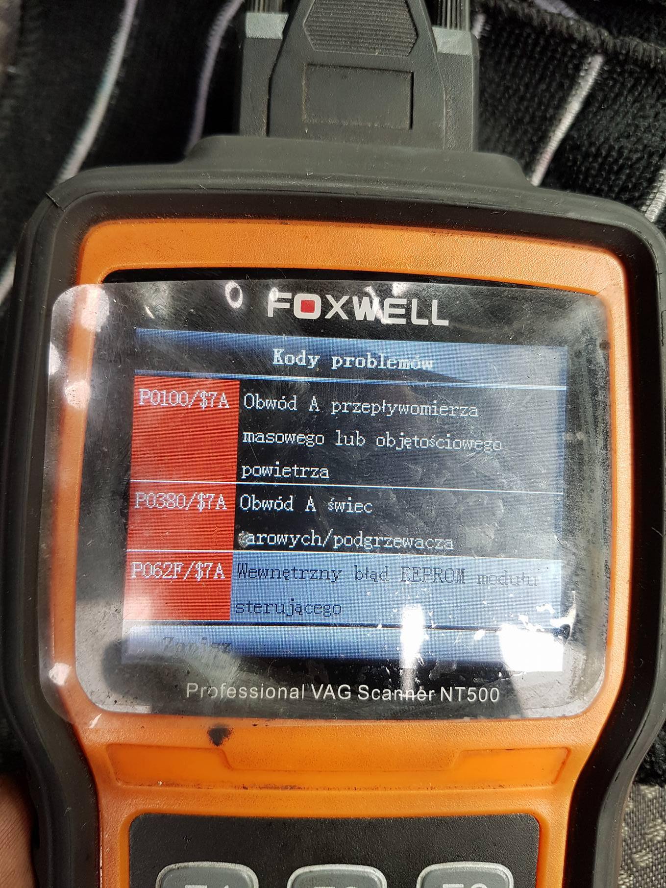

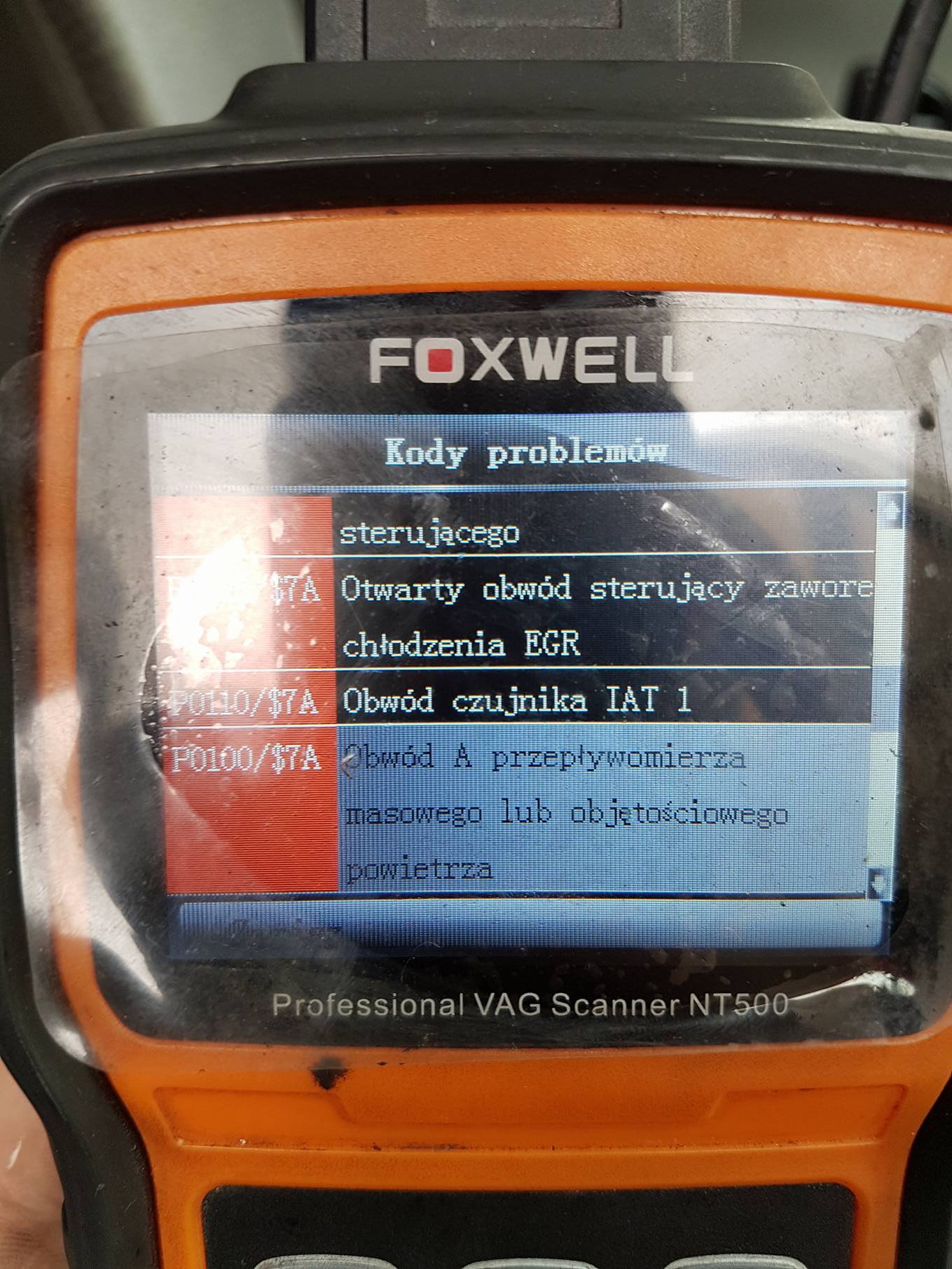

    Hello, there was a similar problem here, but unfortunately it is in the archive so he writes a new one ... The problem is as follows - Opel Movano 2.5CDTI 2007 I arrived in the parking lot normally, after a few hours I had to go home and silence ... after a long mole it catches, walks maybe a second and goes out. Earlier he had to go out when pressing the gas pedal to the end but after re-firing it was ok again .... I thought maybe it was the fault of the pump in the tank (now I know it is not there) but unfortunately ... after removing the hose from the filter fuel and the key is turned off, the fuel does not fly. What could it be? How to locate this part?
    I only have a device to check for errors because my laptop won't connect.

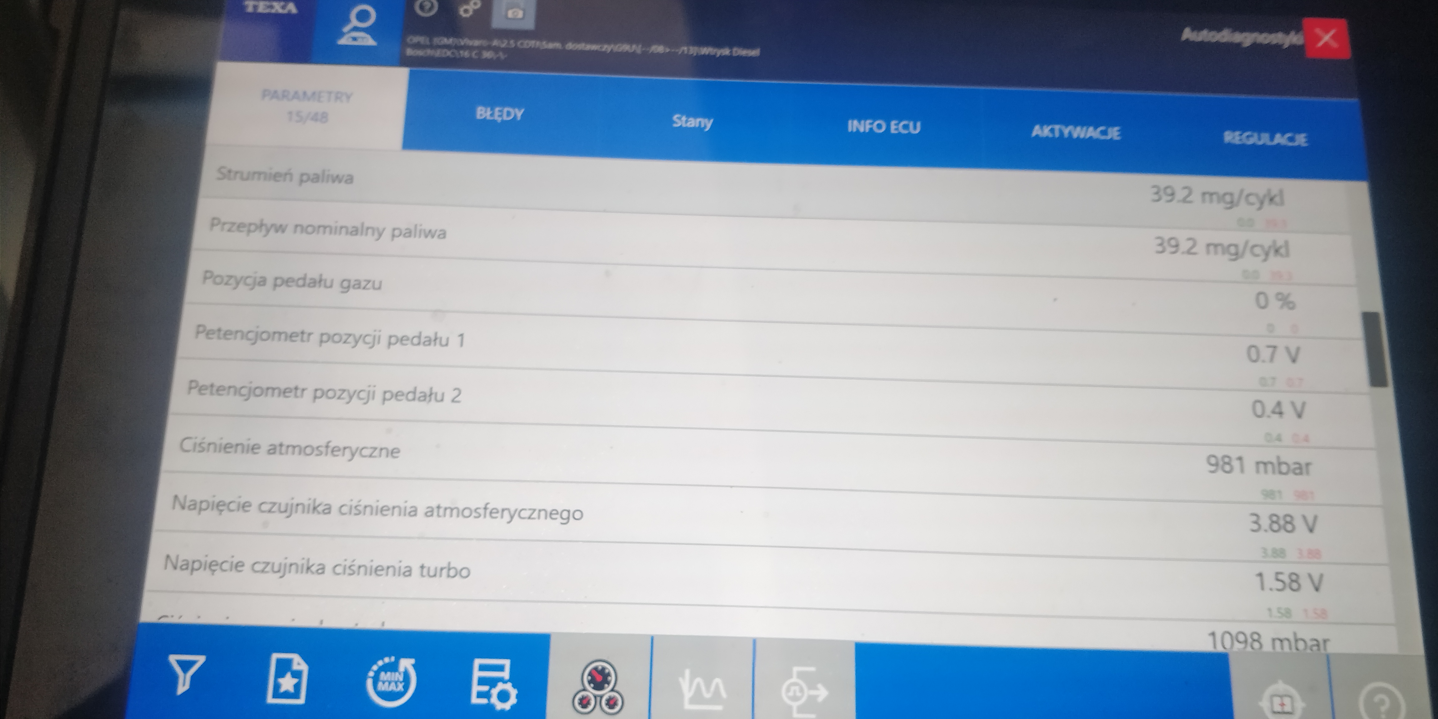

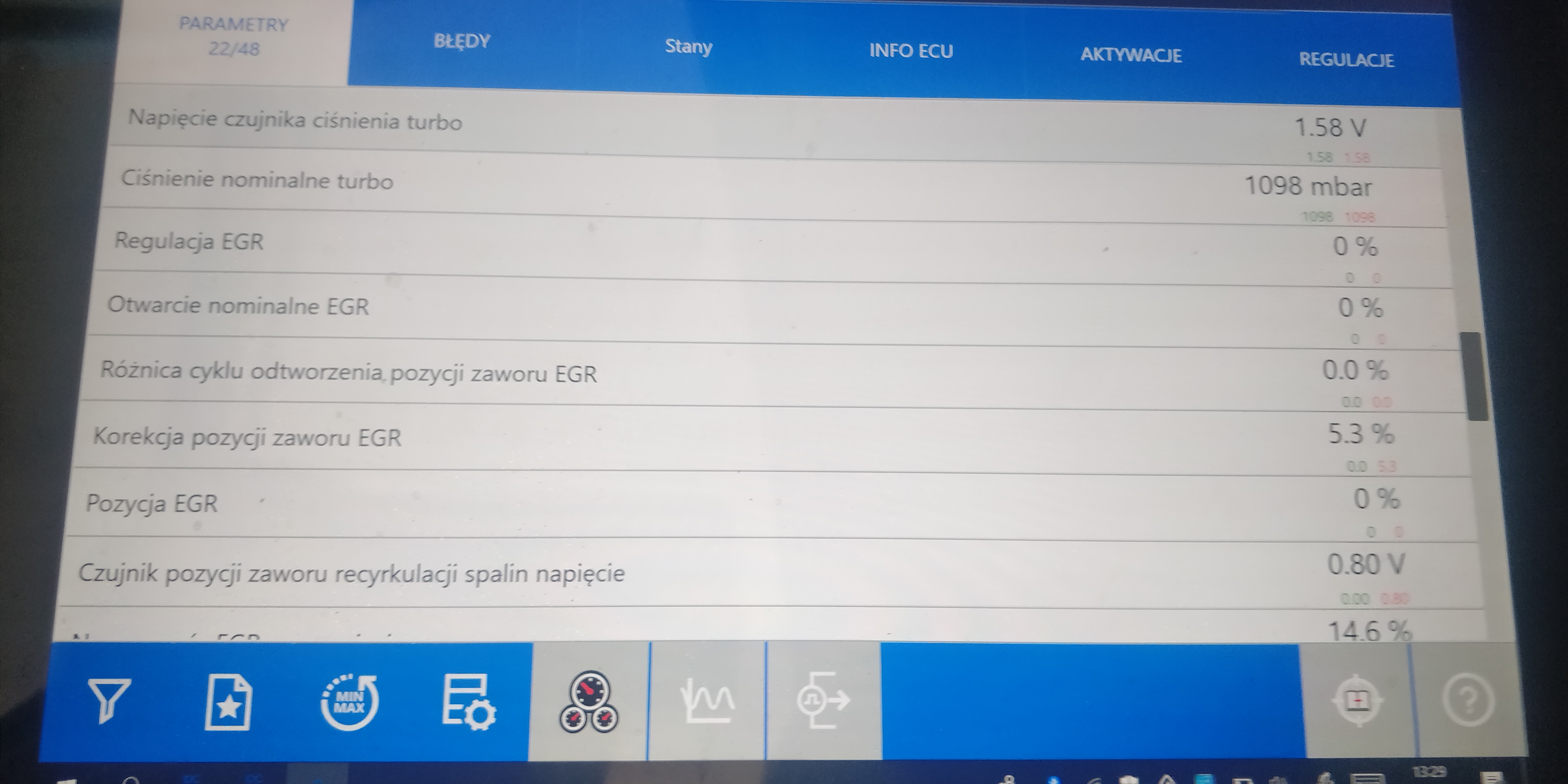

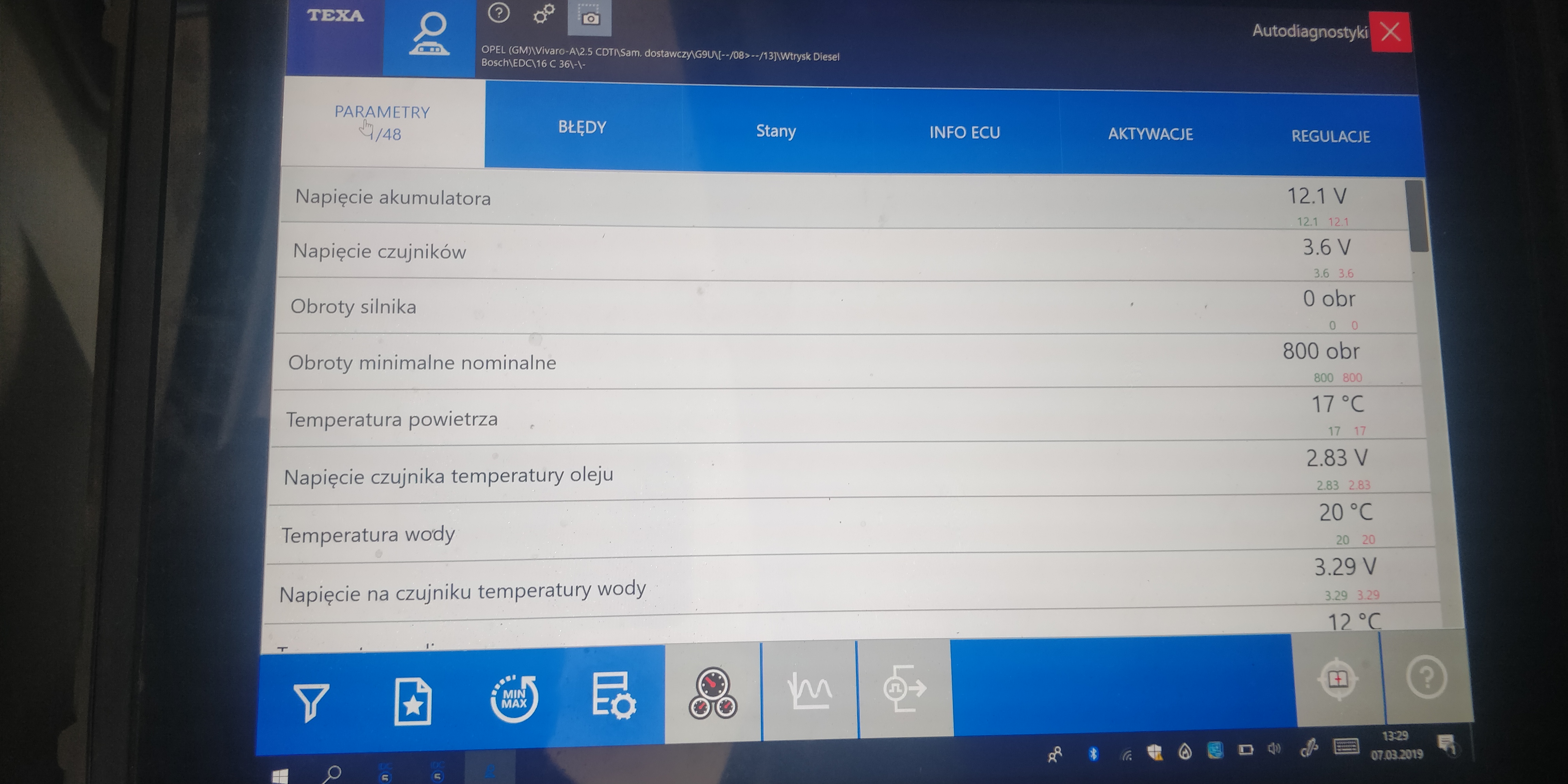

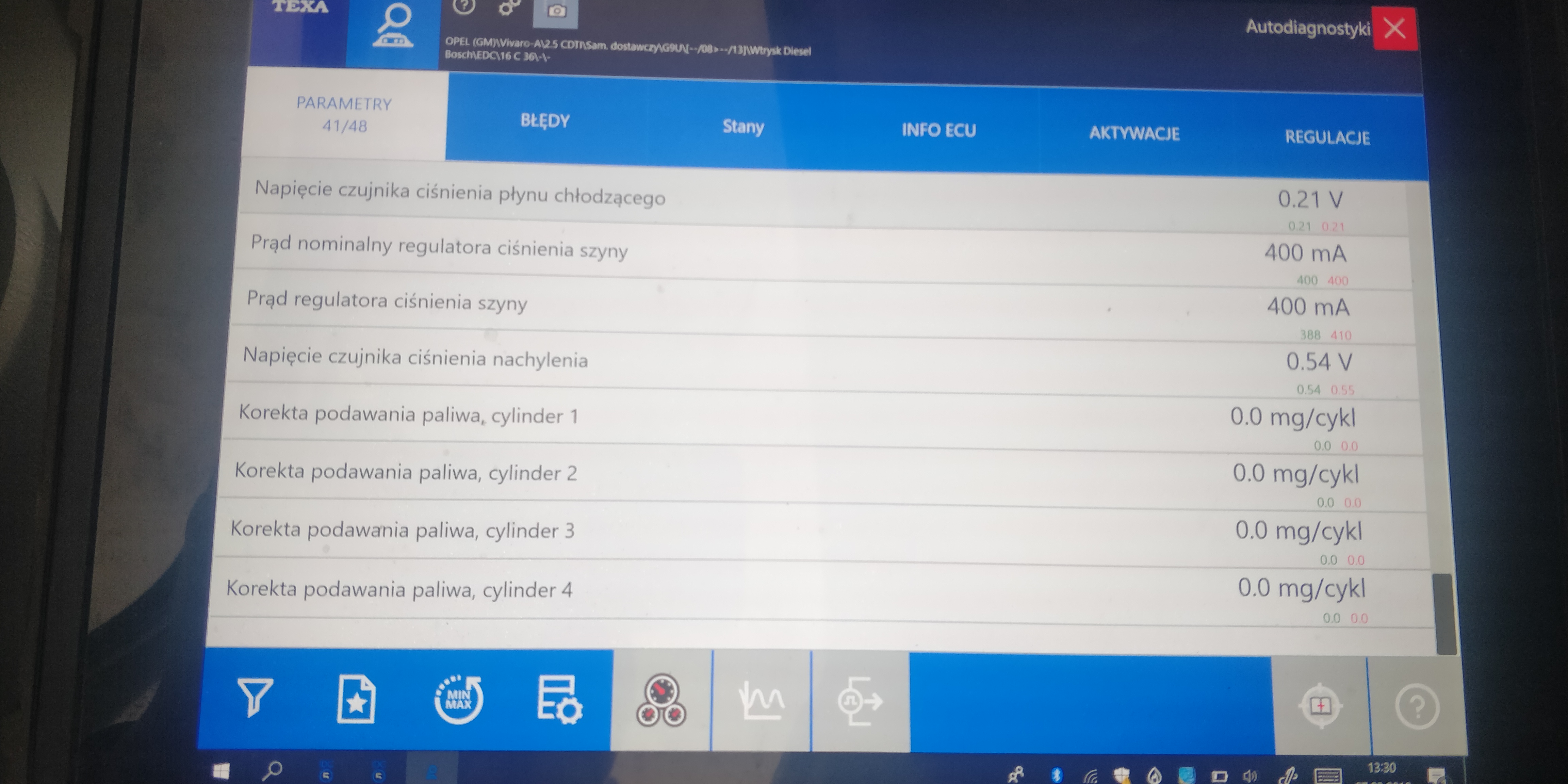

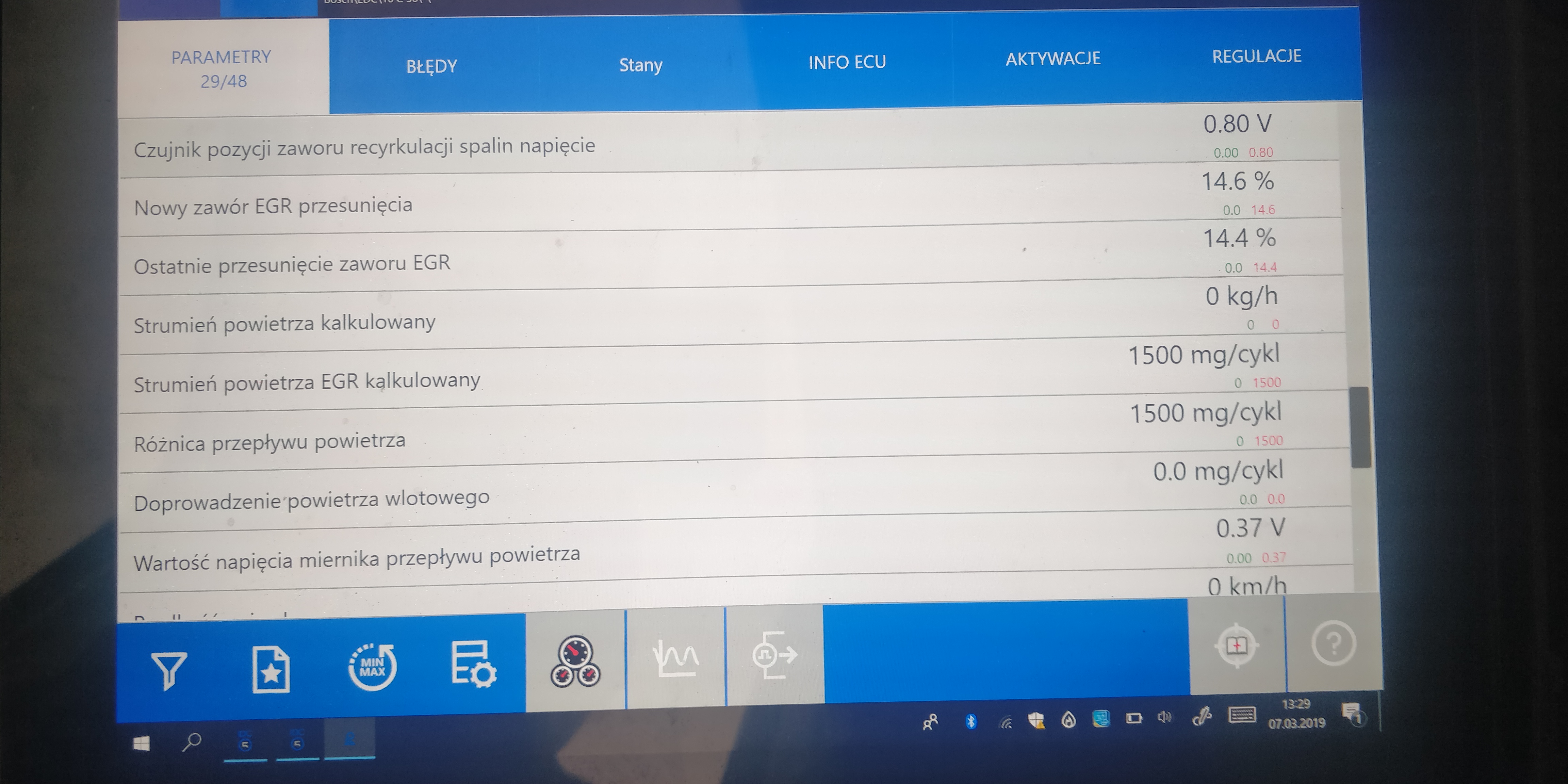

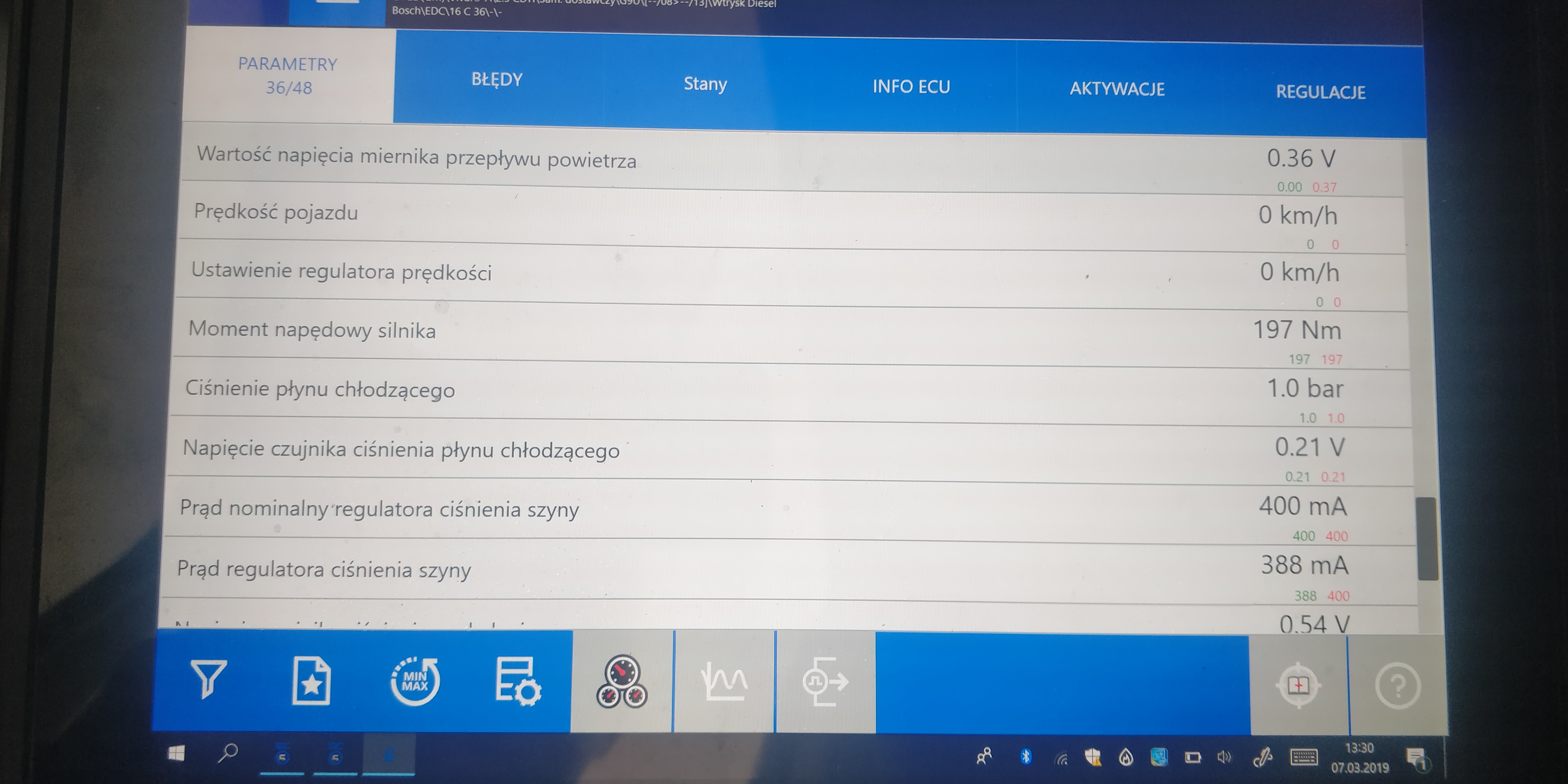

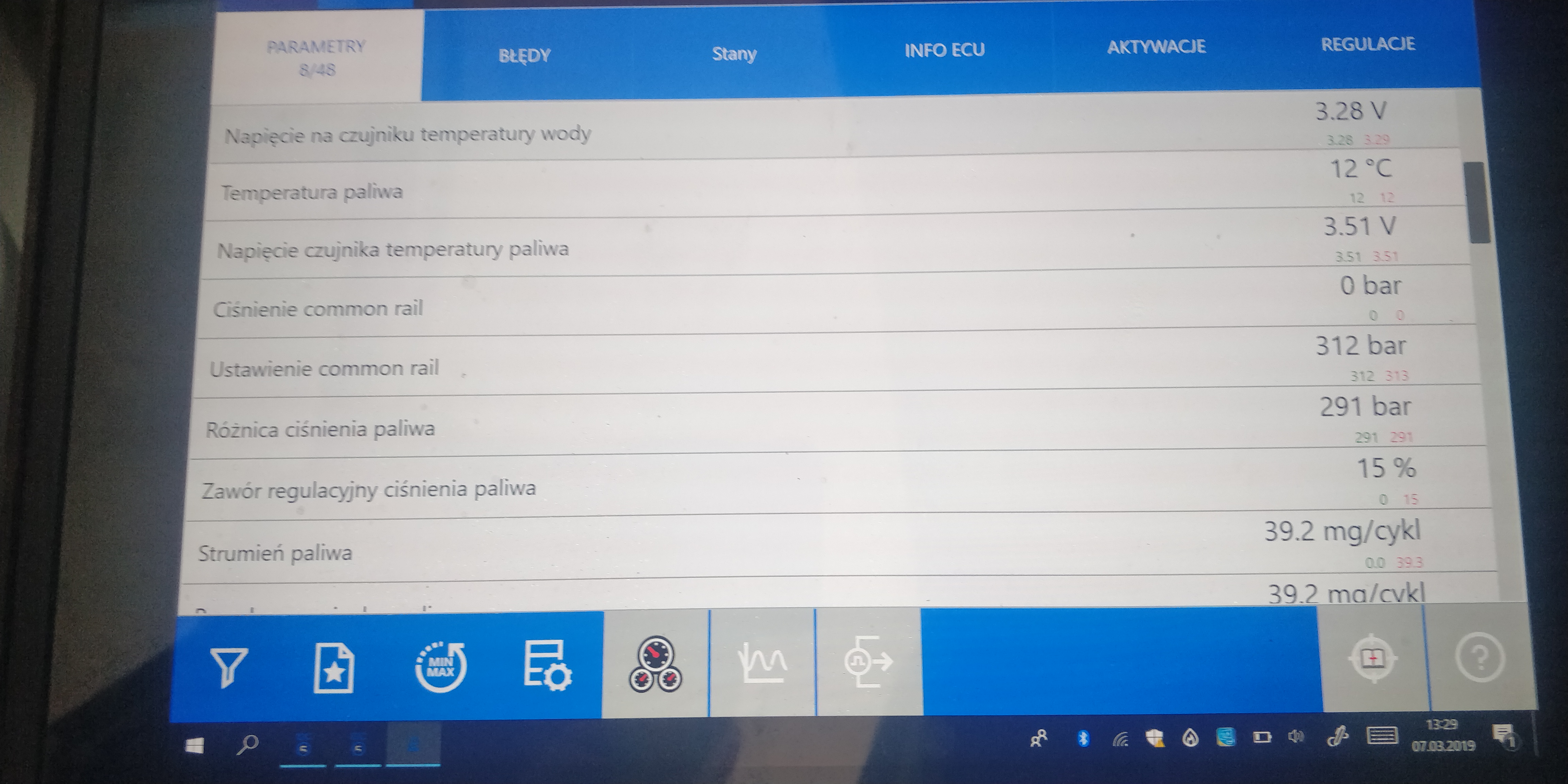

  • #14 17825740
    maydayxxx
    Posts: 126
    Rate: 60
    New Bosch injection not regenerated in December

  • #15 17826847
    diodabg
    Level 30  
    Posts: 1292
    Help: 133
    Rate: 627
    Fuel pressure is zero and revs also 0.
    How much is your turn starter?
    What happens to the immo diode?
