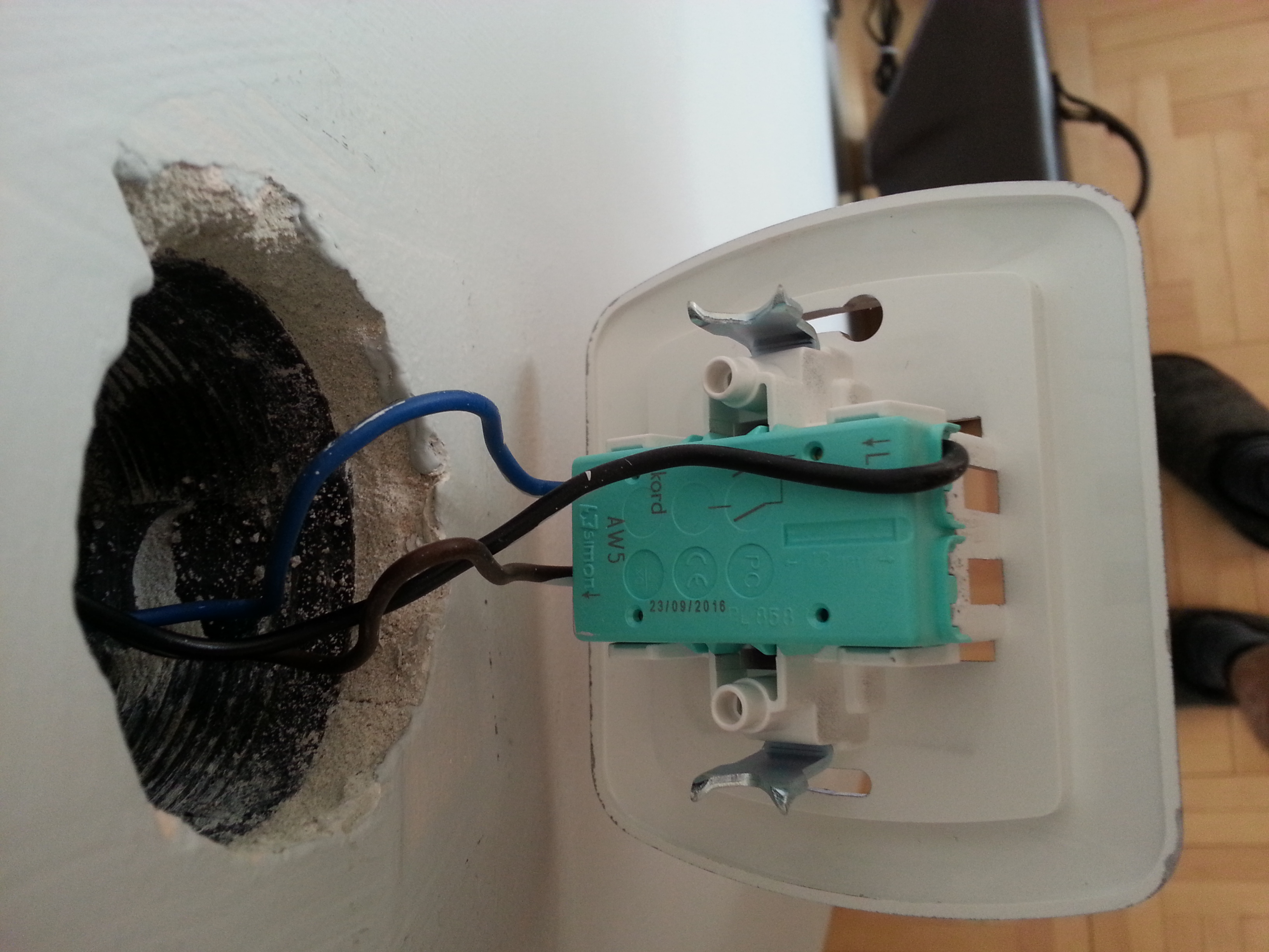

    I have the following problem
    Previously, a lamp with three bulbs was connected to the candlestick connector. However, at the moment I am planning to connect a lamp with one bulb.
    I have three wires: blue, black and gray.
    They are connected to the connector as follows:
    How to connect a connector - Candlestick connector connecting the lamp with one łączni..jpg (1.69 MB)You must be logged in to download this attachment.

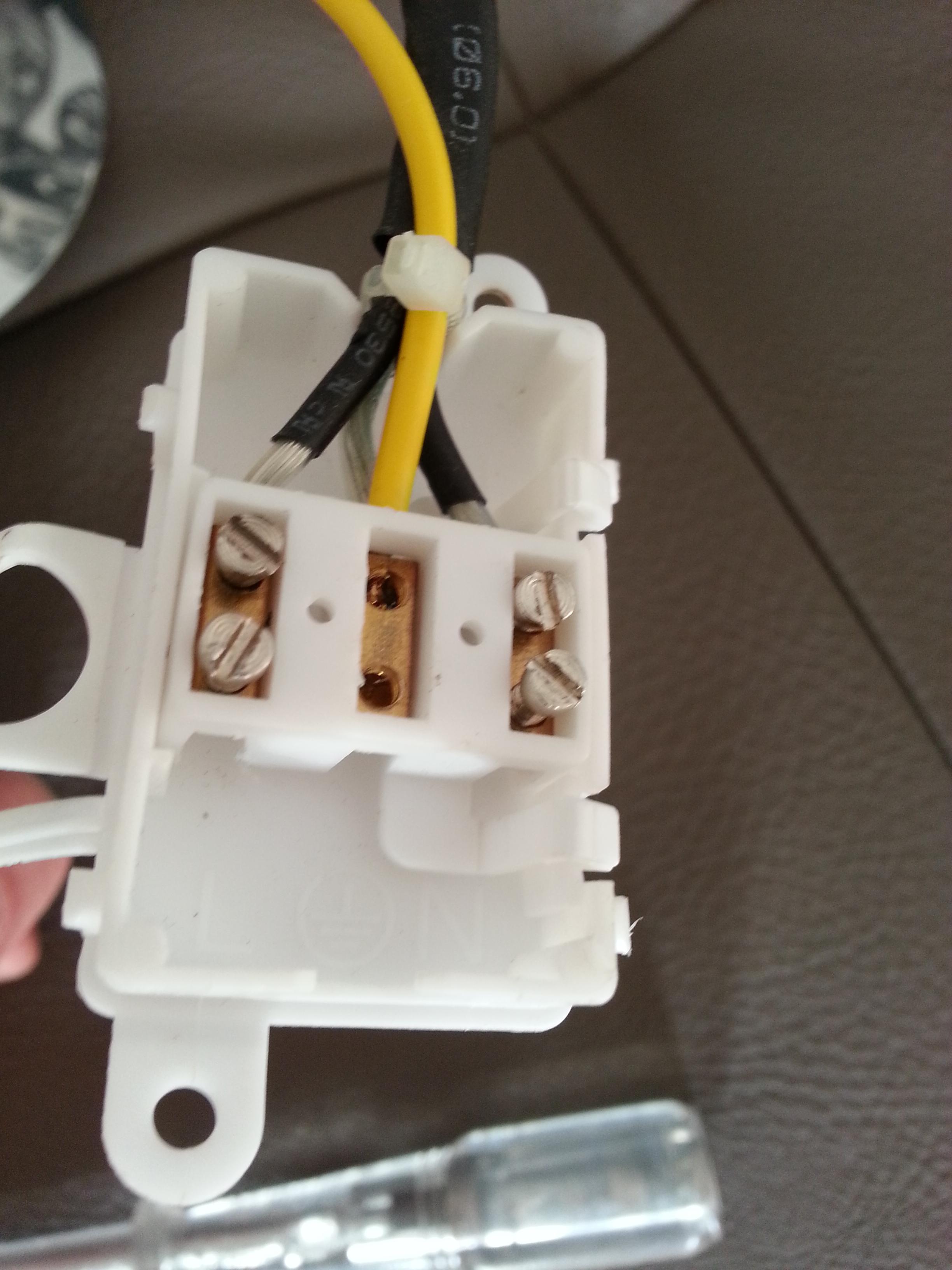

    However, on the lamp in the ankle I have LN markings and grounding in the middle.
    How to connect a connector - Candlestick connector connecting the lamp with one lampa.jpg (518.46 kB)You must be logged in to download this attachment.
    I understand that we connect blue to N, while we connect black to L only and isolate gray?
    Thanks in advance for any comments

    So yes, you have three wires coming to your candlestick switch:
    - black, which is the power cord
    blue - which powers part of the lamp (e.g. 2 bulbs)
    brown (I do not see the gray wire there) - which powers the other part of the lamp (e.g. 1 bulb)
    So you need to connect the brown (phase) wire to the new lamp and the neutral wire that comes from the switchgear or box to the N (neutral) input.
    Insulate the blue coming from the candlestick switch so that it does not confuse with the neutral wire.

    To the author - have you dismantled the old binding? Give a photo of her terminal block and outlet (wires protruding from the ceiling).

    Did the colleague check the wires in the switch box? I know that black should be in phase, but it's better to apply the rule of limited trust and check the wires. Recently, I was surprised how I dismantled several cans in the installation. If everything is as it should be, your colleague wrote in the first answer.

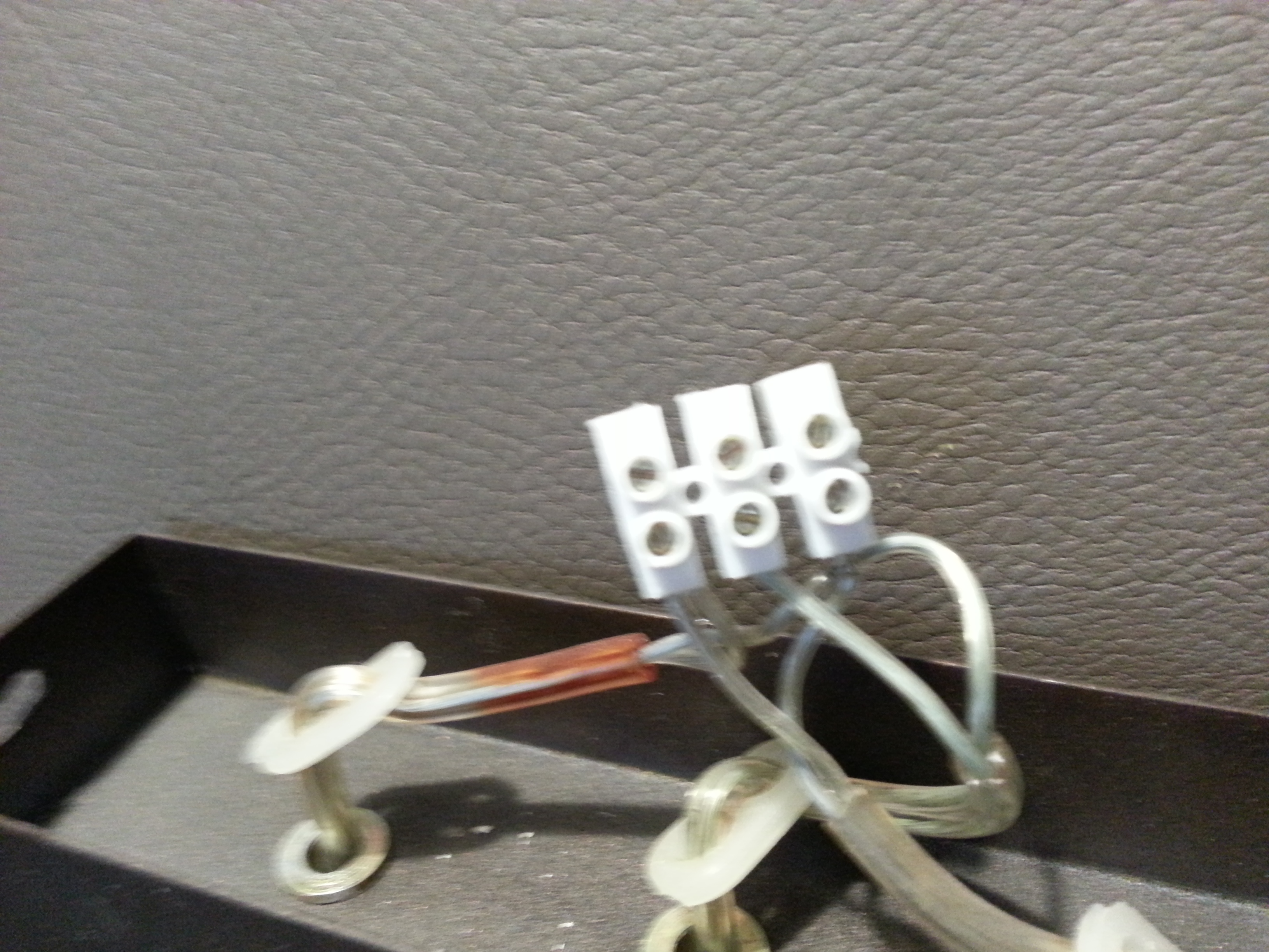

    The old cube looked like this:
    How to connect a connector - Candlestick connector connecting the lamp with one stara ko..a.jpg (2.02 MB)You must be logged in to download this attachment.
    The connection was as follows
    black cable - middle of the ankle
    blue cable - left side of the ankle
    brown cable - right side of the ankle
    Thanks for any comments

    To tell the truth, it is not known whether you can connect a new lamp to this outlet, there is no protective wire in the power cable that the lamp requires, and we do not know the power supply system of your apartment.

    Therefore, if you have a voltage tester (read: a neon lamp), check which wires coming out of the ceiling have voltage. Of course, you have to do this in two positions of the switch to clearly define the phase conductors and the neutral conductor. It may also be that the lighting is controlled by the neutral wire, so it is possible that the phase will be on only one wire. Let me know what came out for you :)

    I shoot, but it seems to me that the lamp is probably made of metal (I mean the construction) and that is why the protective conductor is connected. Recently, I have installed one at home, and since I have the installation from xx years ago (no protective line and, horrifyingly, all the wires in the installation are white), I simply did not connect the protective lamp from the lamp and I suspect that my friend will have the same / similar situation. At least the wires are in color, not Mono like mine ;)
